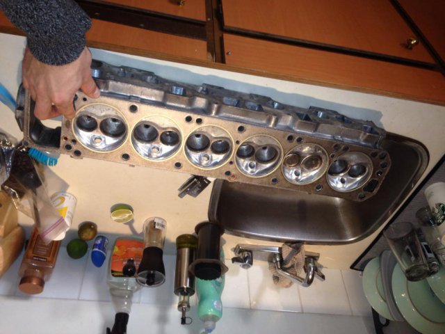

I've been in the middle of rebuilding my first engine for many months now.  I decided to tackle a little bit of headwork on my own.
I was having issues lining up the head gasket, and tracing a mark for the fire ring onto the head itself. It seemed to me, if I used the "wear" marks on the head, it would accomplish the same effect.  So I did what I could, and tried to take as little material off as I could while still relieving the area.

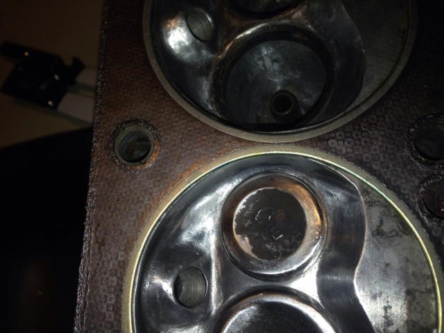

I'm done about 90% of the work I want to do and decided to toss the head gasket on the head to check my work.  Still having issues lining up the head gasket (Or doing it properly), I do believe I overdid the unshrouding on one of the cylinders.
Is the head junk now?
I'm using a Ishono/Stone gasket from MSA.  The block is over bored .040".   Are there gasket with larger fire rings?  Or should I be shopping for a new head and maybe sending it off to one of the local specialists (Or perhaps Hybridz locals).

If the photo you show is the only spot you missed on, AND the headgasket is aligned using the dowel pins for the head, I'd not worry about it and run it. If it's a MAJOR overage that we can't see in the photo then I'd think otherwise, but that looks like maybe a 0.010" overage? If so or less over a very small area, run it.

My dowels unfortunately went with the block I do believe, which is at the machinist.   So I can't say for sure how correct the alignment of the HG is in that photo.  As we sit, the head is in a crate and it's ready to be shipped out to Whitehead Performance in Ontario.  They said they could repair my damage if too large.  Do a more serious porting job and rebuild the head.

The problem is erosion of the fire ring, not so much that it's in the way. Once the metal ring burns out then the gasket burns quickly...so that's why you don't want it exposed.
