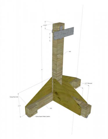

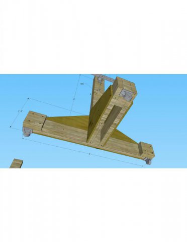

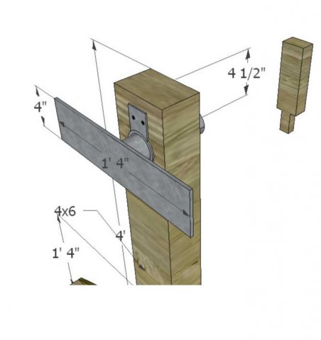

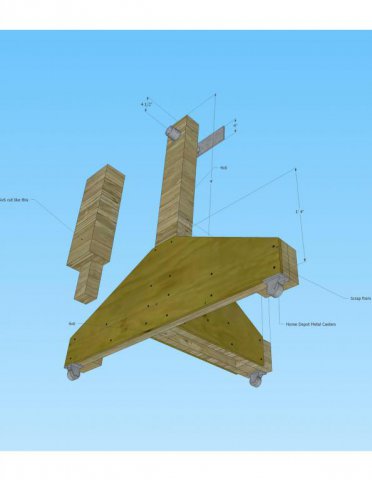

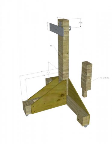

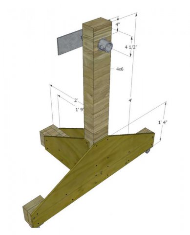

A couple people have asked for something on the rotisserie I built. I'm primarily a wood worker, and wood is a lot easier to get and much more familiar to me. So I decided to make mine primarily out of wood. There is some welding involved, but its' pretty minor and could easily be farmed out, just welding tubes to flat plate. The 4" x 16" plate was bolted to long pieces of 1 3/4" x 9.25 LVL, which is a wood product like really thick plywood. Your big box store won't carry it, but your local lumber yard likely will. you could easily do this with metal plate or channel, still bolting it together if you are trying to minimize welding.
To mount this to the car:
At the front, I welded some plate 1/8" plate to some 1x2 tube steel, bolted the tube to the sway bar mounts, and bolts the plate to the LVL.
At the rear, the LVL is bolted to the bumper mounts, with some spacers in between the LVL and the car.
Materials:
2/10' - 4x6
2/8' - 2x6
1/2 sheet of 1/2" plywood
3" and 1 5/8" screws
6 swivel casters. I used metal wheel casters form HD, they were like $5 each and have worked great
