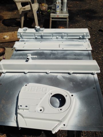

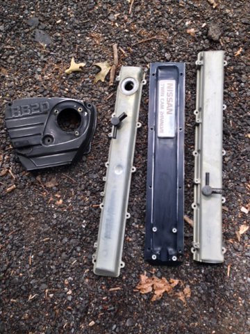

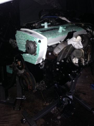

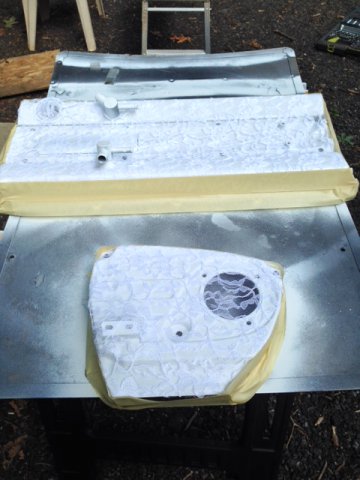

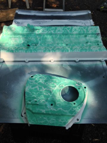

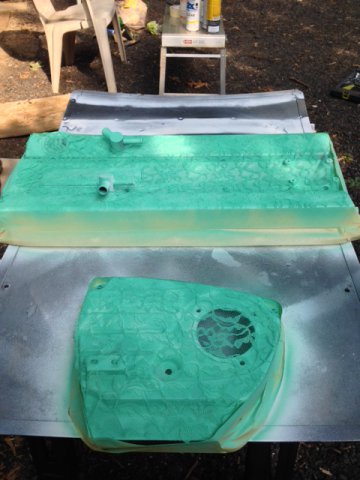

So I got around to paint so here we go.
I scuffed the thin paint with 220 git
Attached File  datsun33.jpg   191.17KB   1 downloads
Hit it with some primer
Attached File  datsun34.jpg   115.53KB   0 downloads
The with rustoleom 2 coats of white gloss paint . The laid some lace fabric over it.
Attached File  datsun35.jpg   121.88KB   0 downloads
The shot some mint green paint to match the body.
Attached File  datsun36.jpg   126.59KB   0 downloads
Removed the lace and shot it with three coats of gloss clear.
Attached File  datsun37.jpg   110.35KB   0 downloads
Got this idea from my wife. My first time doing lace I guess it came out ok.
Hope it last a while I know rattle can fades faster then gun p.aint

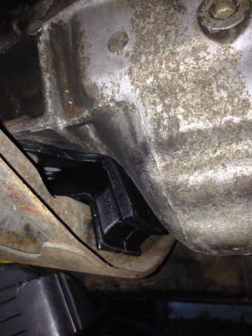

So I found time to wrench some on the z. I finally got the mounts though although I don't see much difference but I'll go with it!

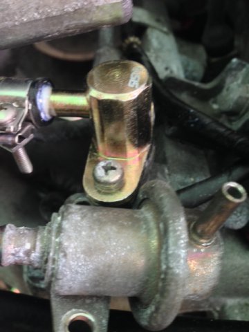

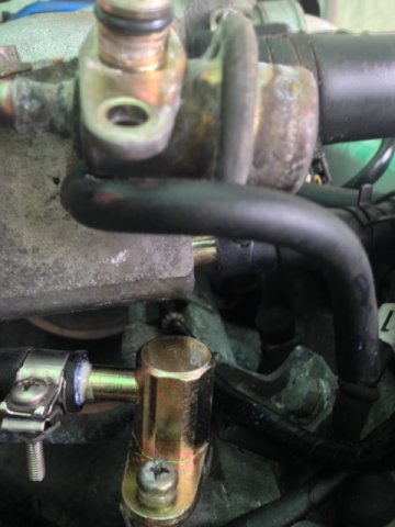

I installed my isr fpr adapter it was pretty easy just pop off and pop on.
Attached File  datsun38.jpg   91.65KB   0 downloadsAttached File  datsun39.jpg   91.09KB   0 downloads

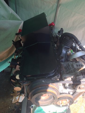

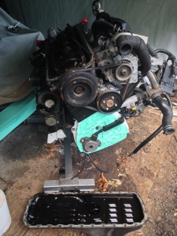

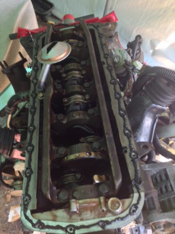

Now finally on to the oil pan made by pat1!
Turned my motor upside down, removed the 30 10mm bolts, and popped off the pan.
Attached File  datsun41.jpg   141.52KB   0 downloads
Scraped off the old gasket and installed the rear oil pickup.
Attached File  datsun42.jpg   112.03KB   0 downloads
I popped out the brass fitting for the rear dipstick tube relocation but burred up the tube lol I cant get it out! Ill try again later but I think ill just buy a new one there are only 20 bucks.
Attached File  datsun43.jpg   104.58KB   1 downloads
I put the black rtv gasket maker around the pan and around the holes. I added some random drill bits in two spots so the pan can drop right in the correct location.
Attached File  datsun44.jpg   111.5KB   0 downloads
I just popped it on and used the fsm to tighten them in proper sequence
Torqured them down to 20 lb. Another successful pat1 oil pan install, went on like butter!
Attached File  datsun45.jpg   94.84KB   2 downloads

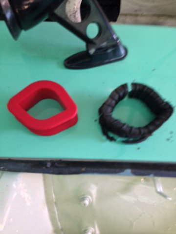

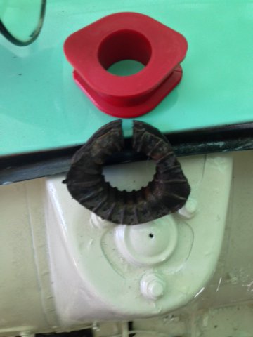

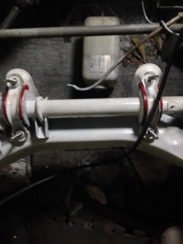

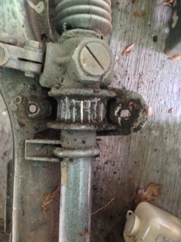

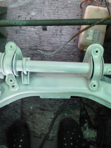

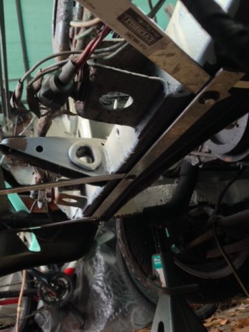

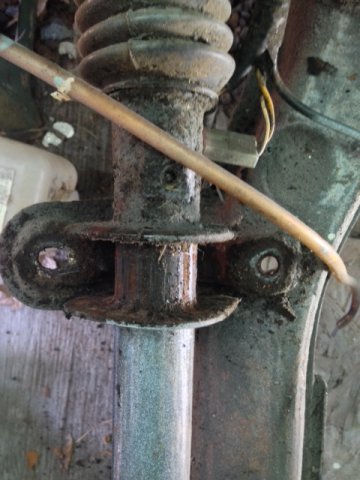

Ok so I got around to doing the front steering bushings since it will be 92 the whole month it seems like. I just rather do it now since the motor is out. I popped out the 4 12mm bolts and off comes the 2 top brackets and thy are packed up with 45 years worth of dirt!!!
Attached File  datsun51.jpg   121.26KB   1 downloads

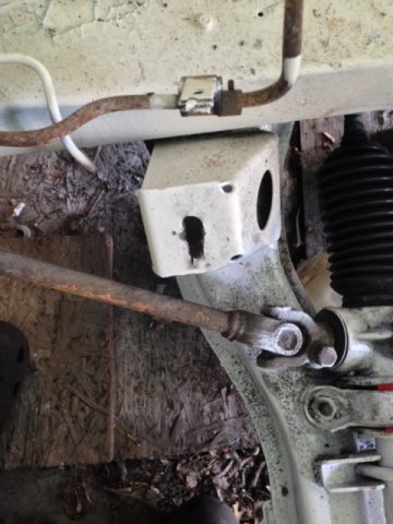

Driver side yuck! Also there was some weird exhaust bracket used for some kind of reinforcement.
Attached File  datsun49.jpg   121.93KB   0 downloads
The passenger side doesn't look any better. Same exhaust mount used too. What would you expect from this old girl.
Attached File  datsun50.jpg   66.05KB   0 downloads
So this is the driver side mount next to the new prothane p/u bushing, whats left of it haha
Attached File  datsun48.jpg   77.07KB   0 downloads
This the passenger side, yucky old bushing RIP. I have mostly spent more time cleaning this crossmember, then paining it because it was hideous under all that grime. It took about 2 hours.
Attached File  datsun52.jpg   105.91KB   0 downloads
I just painted it white just to give it a cleaner look. Nothing too flashy since it will not be in plain site. This was the fun part, I had some amsoil synthetic grease and applied it to both bushings since they came with no grease. I squeezed the bushing on as best as I could which was tough since its a tight spot. I picked up 4 longer m8x1.25 60mm long screws so I can use them because the stock bolts were too small. I popped them in and used my 3/8 gun with a 13mm socket and the bracket clamped down and pressed them perfectly in place like a charm. I just hope the bolts aren't too long to interfere the fitment of the motor haha
Attached File  datsun53.jpg   83.49KB   0 downloads
Time to collect parts to plumb the motor in. The last thing is the front facing top portion of the intake manifold then I can drop the motor in finally!

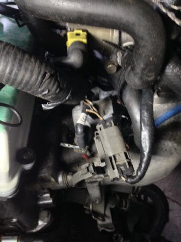

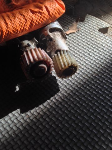

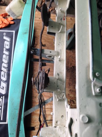

So worked finally slowed down and found some time to work in the cold on the z. I found some loose wires that probably got pulled out from handling the motor the last 6 months or so. The fuel injector wire, some nearby connector from the harness, and the iacv connector got boogered up. Hard to see in the pic.
Attached File  datsun55.jpg   91.05KB   0 downloads
So I went ahead and pulled out my solder and electrical tape and she is as good as new!
Attached File  datsun56.jpg   99.39KB   0 downloads

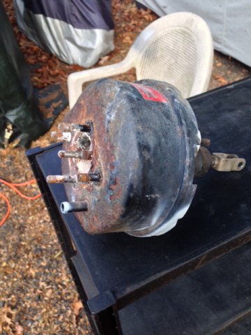

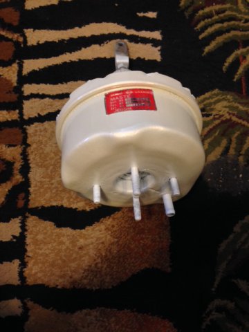

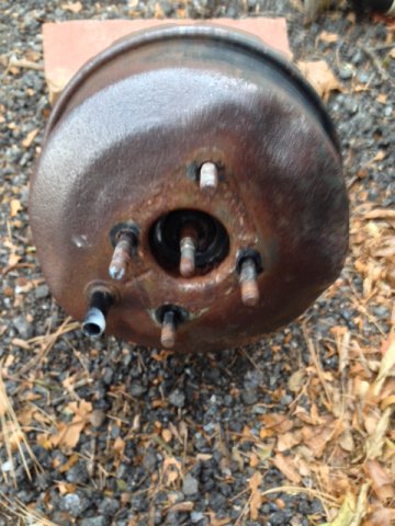

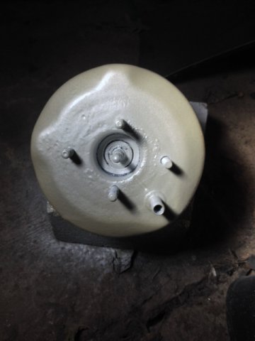

I saw how ugly my brake booster is and it was time to paint it. Here are some pics.
Attached File  datsun57.jpg   126.28KB   0 downloads
Attached File  datsun58.jpg   124KB   0 downloads
I used a wire wheel brush on the drill and it helped a little bit.
Attached File  datsun59.jpg   139.06KB   0 downloads

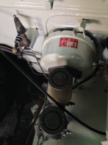

I then hit it with some primer, white rustoleum, rustoleum white pearl mist that I always wanted to try and last some clear coat.
Attached File  datsun60.jpg   70.52KB   0 downloads
Attached File  datsun61.jpg   96KB   1 downloads
Not sure how long that will last next to that hot turbo but we will see. I just wanted to do something unique for fun and affordable. I'm pretty sure the motor is ready to be dropped in the next few weeks I cannot wait.

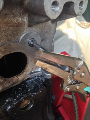

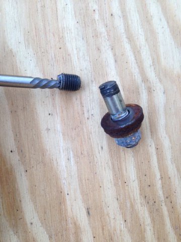

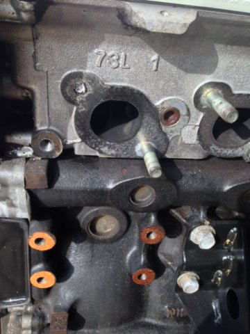

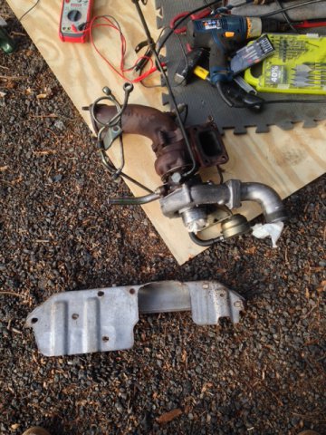

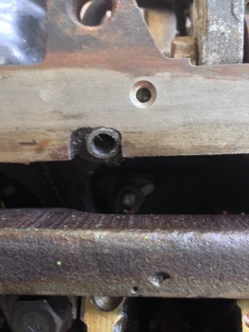

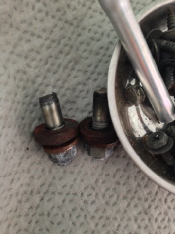

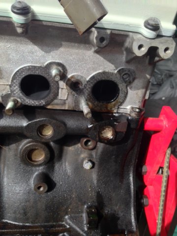

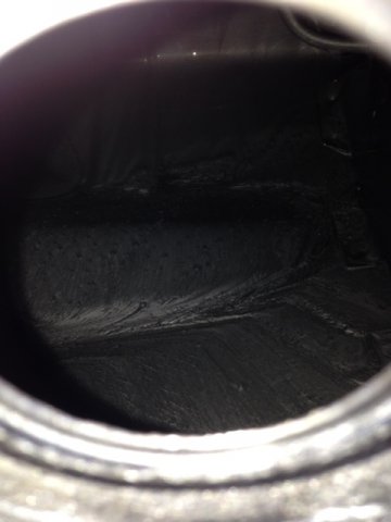

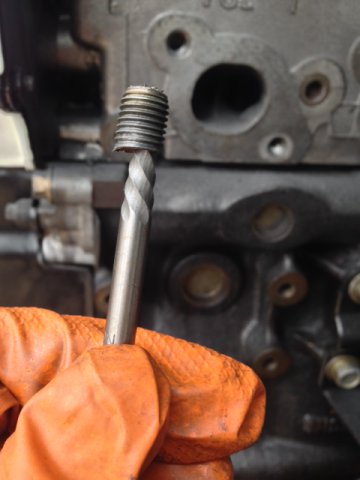

So I finally get around to putting the motor in candy but of course I go to unscrew the exhaust manifold to install the engine leveler, the bolt was broken flush with the head. I got to unscrew the front bolt and it broke flush too. So time to take the turbo and manifold off to extract the broken studs!
Attached File  datsun63.jpg   197.79KB   0 downloads
Attached File  datsun68.jpg   97.02KB   0 downloads
I got to drill the front one and extract it, things went smooth.
Attached File  datsun64.jpg   121.04KB   0 downloads
Attached File  datsun66.jpg   111.15KB   0 downloads
Attached File  datsun67.jpg   129.81KB   0 downloads
Of course the last one was like undrillable.
Attached File  datsun65.jpg   133.99KB   0 downloads
I spent close to 20 hours and 20 drill bits. I finally picked up my dremel with a grinding stone bit and it worked out. So when I ave time I will load up on smaller dremel grinding bits and go to town on the stud and post more in a few days.

So my prayers have been answered and I was able to get the last broken stud out! After about 3 broken black and decker extractors and 4 broken dewalt titanium drill bits along with 20 plus hours of using 3 drills and 2 drill bits the harbor freight bits and extractors came out on top lol. So now I can put the motor and trans in the car and deal with those issues while I wait for the 12 new studs and turbo gaskets in the mail. This was one of the biggest set backs I had with this car yet (aside from the l24 trans came with no fluid and blowing up hence the swap). More to come soon yall!
Attached File  datsun69.jpg   80.85KB   0 downloads

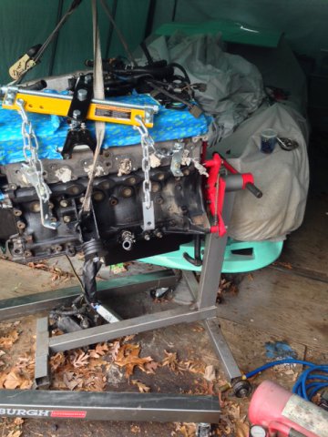

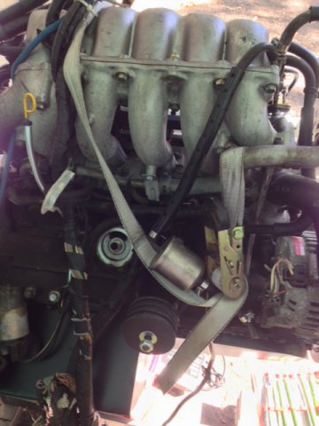

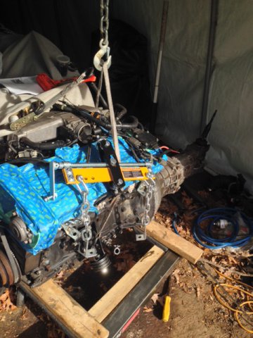

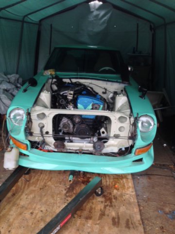

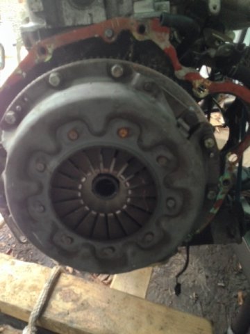

So I finally got around to working on candy. Time to start to putting the engine together and drop it in. First to get it off the stand. This sucks because the ground is uneven and there is grass and dirt so its just sitting on whatever plywood we have laying around the yard.
Hooked up to the hoist.
Attached File  datsun71.jpg   153.64KB   0 downloads
So there was really no safe place to hook up the engine leveler to so I just used tow straps I had laying around.

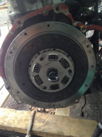

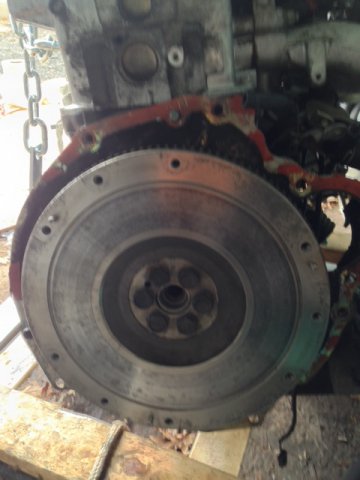

Cleaned up and replaced the stock flywheel it still has left in it so why not.
Attached File  datsun72.jpg   92.23KB   0 downloads
Bought a clutch alignment tool front autozone. It's for a ka24de it fit perfectly. Installed the clutch that came with it.
Attached File  datsun73.jpg   93.3KB   0 downloads
Installed the stock pressure plate.
Attached File  datsun74.jpg   87.8KB   0 downloads

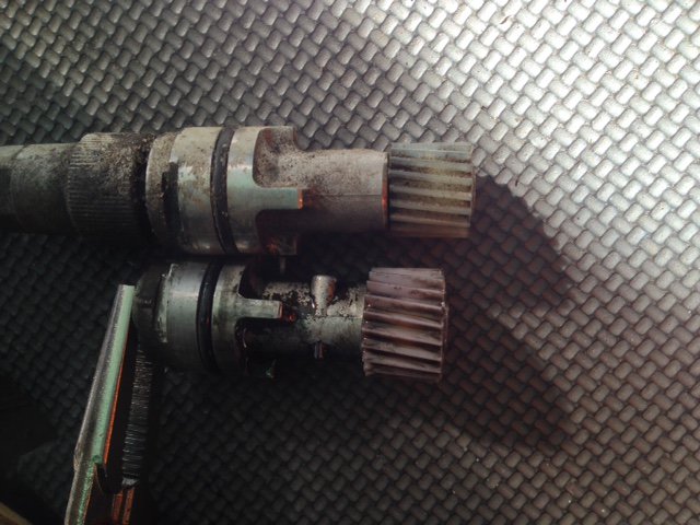

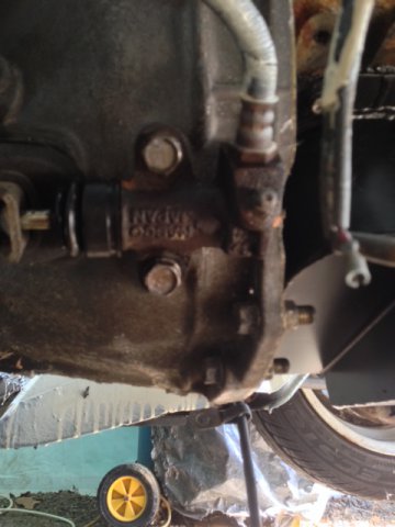

So it was time to re install the transmission. This was a pain in the butt. I had to use a jack to hold the tail end up. I wrestled with the bell housing till it fit close enough to use the long screws to get it to move flush with the engine. I tighten the screws in a cross pattern little by little then it eventually was all buttoned up. Then installed the starter which was easy. Everything went smooth except these brackets don't fit because the rear sump pan was in the way.
Attached File  datsun75.jpg   91.13KB   0 downloads
I guess no one uses these with this swap? Oh well I'm sure it will be ok. So here she is all ready to go, the last thing was to remove the shifter.
Attached File  datsun76.jpg   149.76KB   0 downloads
Sorry if the pics keep rotating sideways, on my computer they are normal then when uploaded they go randomly rotating. So the next day, my wife and I started the install. I jacked the motor sky high in the air to clear the radiator support, that part was easy. The pain part was tilting the motor and lowering it little by little. My dad came to help in the nick of time as a helping hand. So all in all it took us 40 mins to get it mounted up in the z.
Attached File  datsun70.jpg   106.77KB   0 downloads
That is how she sits today and as soon the mounts went in the holes we all were pooped and just called it a day. Next is to start putting together all the components to get her running. This was a huge step though so thanks for stopping by and more to come!

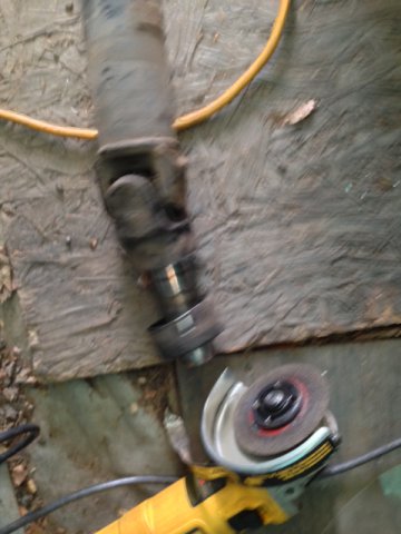

Well I plan on using this 280z driveshaft I have but we will see once I get the trans rubber mount since I threw away by accident lol.

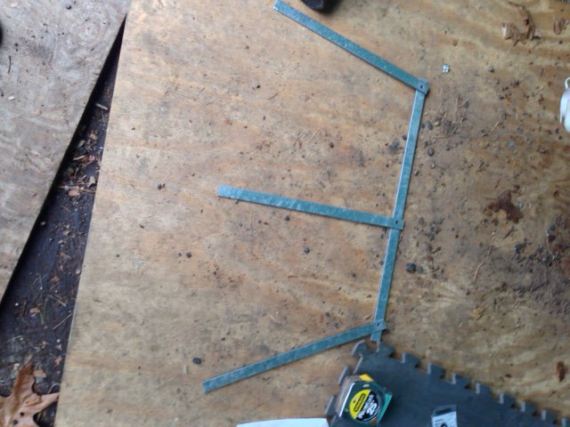

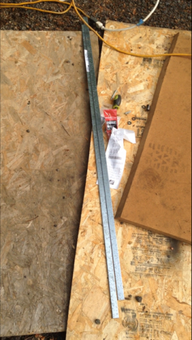

I had sometime today to make a brace for the air dam. I got the idea from this link here props to this guy http://forums.hybrid...r-dam-pictures/. Went to home depot and bought two 4 ft flat steel bars .
Attached File  datsun81.png   433.57KB   0 downloads

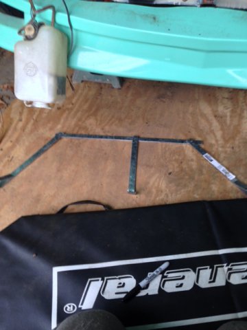

I did the measurements and cut accordingly.
Attached File  datsun77.jpg   127.03KB   0 downloads
I used the 3 bolt holes that were under the radiator support there and drilled the hole which took hours to get right haha.
The i just bent the ends into the shape as the air dam as best as possible.
Attached File  datsun78.jpg   93.15KB   0 downloads
Then finally got it up and mounted here are the finished pics.
Attached File  datsun79.jpg   115.08KB   0 downloadsAttached File  datsun80.jpg   104.66KB   0 downloads
Sorry about the pics but if you look at the link I posted it pretty much came out the same way.

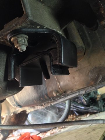

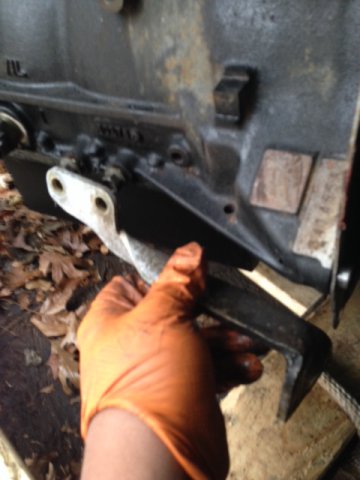

So I got the 280z trans mount in from ebay and it worked out like a charm.
Attached File  datsun85.jpg   92.25KB   0 downloads
It is attached by the 2 bolts on the transmission. Now to attach the stock 280z crossmember.

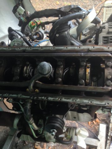

Attached File  datsun86.jpg   131.77KB   0 downloads

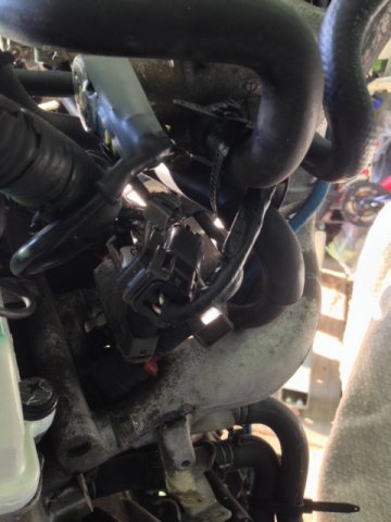

It pretty much fell right into place. Its held in place by the 3 bolts on its stock position. Yes so glad that worked out. Next task is I needed help, what are yall doing for the driveshaft? Mines cant fit because of the little lip back on the diff side, I might need to trim it a bit? Well anyways I will come back to that later. I had time to refurbish the 280z gas tank and replace my 240z tank with it. Here it is.
Attached File  datsun82.jpg   155.06KB   0 downloads

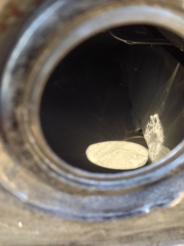

I used this guys thread and basically did the same thing on post #11 http://forums.hybrid...t-build-thread/
I used the por-15 sealer kit. Here is how it came out.
Attached File  datsun84.jpg   69.24KB   0 downloads
Attached File  datsun83.jpg   69.1KB   0 downloads
The first rinsing I did the water came out black, the second came out clea, and I did one more to just get the solution out.
My arms were dead lol. The on to the ecthing primer which you pretty much do the same thing. Then you pour in the actual sealer, drain the excess out and it dries in 96 hours. Here is my video link https://www.youtube....h?v=NvWM8qi6zok. Thats pretty much it guys more coming soon!

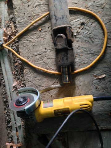

So I got to the drive shaft and I just cut the shield off lol.
Attached File  datsun87.jpg   133.66KB   0 downloads
Attached File  datsun88.jpg   104.1KB   0 downloads

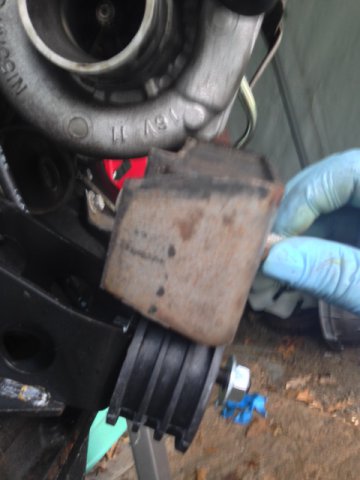

That was that. I wanted to use the stock 240z slave cylinder but I couldn't find the rod and rubber seal so I just used the one that came with the motor.
Attached File  datsun89.jpg   90.15KB   0 downloads

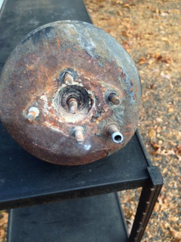

Then comes the speedo gear sender things, I guess people are just shoving the stock 240z ones in the rb20det transmission. I guess Ill do that tomorrow. Here are some pics.
Attached File  datsun90.jpg   125.95KB   0 downloads
Attached File  datsun91.jpg   129.55KB   0 downloads
The one with the vice grip on it is the rb20det one lol it was broke so I pulled it out of the transmission case. You can see the size difference.

So today I was able to install the stock 240z speedo gear sensor thing in the rb20det transmission. I then filled up my transmission with some amsoil 75w90 synthetic gear oil. After that I went ahead to install the shifter. I didn't really take pics but I took a video and posted it on youtube here is the link

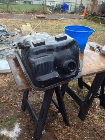

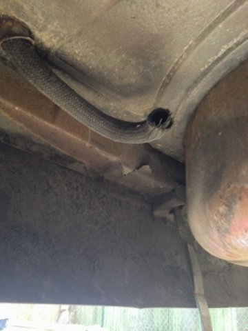

Got around to removing the 240z gas tank. I first had to drain it out I had like 10 gallons in there haha. The drain plug came right out. I then proceeded to remove the hoses off the tank. The only ends that didnt need to be cut/broken off were the feed and return lines they puhed off really easy. The top most line was already broken off!!!! No wonder I smelled gas driving around lol. The other vapor lines had to be cut off. The two strap bolts came off. I loosened the filler neck with a fat Phillips bit i had to avoid it from rounded off. Then a drop the tank out. It took about 3 hours taking my time and draining/storing the gas. Here are some pics and a video.
Attached File  datsun92.jpg   130.25KB   0 downloads Attached File  datsun93.jpg   182.34KB   0 downloads Attached File  datsun94.jpg   91.75KB   0 downloads Attached File  datsun95.jpg   102.73KB   0 downloads Attached File  datsun97.jpg   90.28KB   0 downloads Attached File  datsun98.jpg   83.46KB   0 downloads
I need to clean and paint the new gas tank exterior and under body area were it goes.
