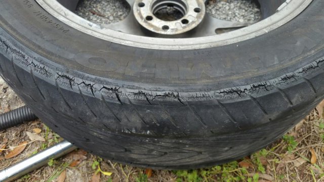

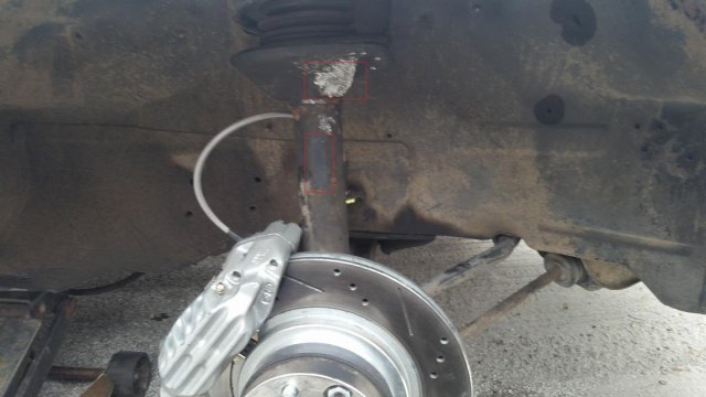

Came to find my front right tire is rubbing on the shock now,sidewall is just barely touching,and where the tread starts at the edge of the tire,was severely rubbing,on the lower spring perch.

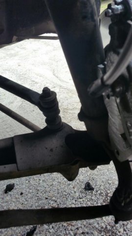

Wheel bearings where not replaced during the brake kit install. but were cleaned thoroughly(along with the spindles)and bearings repacked,and as it sits now the bearings have no slop in them.I did notice the ball joint on the passenger side has a little bit of slop when the suspension is unloaded.

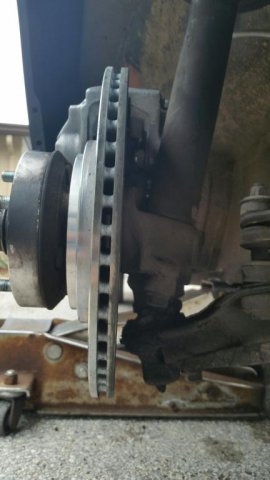

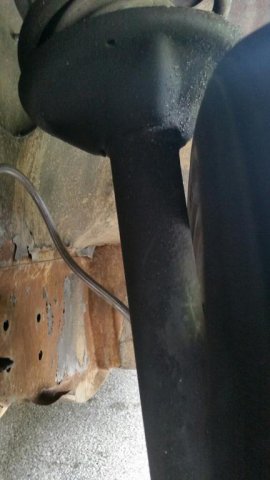

Added some pics to help with any ideas,  In the overall picture i added red sqaures to indicate where the tire was rubbing.
and also added a picture of the front left with the suspension load to show the clearance on that side (roughly 3/8 of an inch),
while the passenger side has none.

Well,today i found the cause of my woes(presumably). Inspected and re-loaded the wheel bearing,Nothing looked out of normal.When I went to pick up my wheel with the new tire installed. The gentleman there told me there was a small finishing nail in my tire,wich i was unaware of.
I mounted the new wheel/tire onto the hub and checked my clearance. Had about 1/8 gap,maybe slightly less, much more then when checking the day before,Even though I had massaged the lower spring perch a little. Anywho, I suspect that the tire may have been low enough on air due to the slow leak of the nail to cause the tire to "sag" ,and let the side wall balloon out just far enough to touch.
