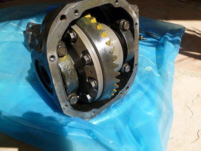

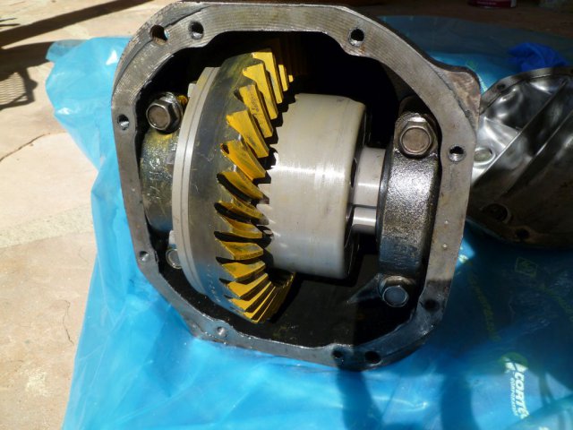

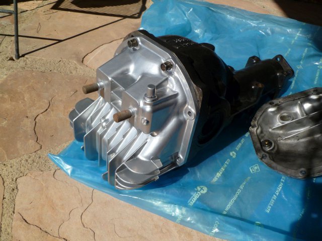

I just bought a new -used, 3.9 R200 OS-Giken filled diff off of the local Craigslist that the previous owner had a quality company professionally install. I have his receipt and it is the NS046-HA unit set up as a 1.5 way.
