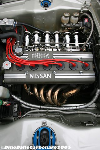

I think its a great engine choice you have there, in keeping with the DOHC S20 L6 in the 432 240Z.
It would be interesting to try and have the cam cover restyled so to read Nissan 2000. I know that sounds cheesy but it would confuse a lot of people at first glance ;)

Yes there are similarities with the DOHC S20 L6 and the Volvo B6284T or Tin Six.
At least they look quite similar, but unfortunately I haven't studied the S20 engine very thoroughly! Would be nice
to compare it to the T6 with a FSM.
The T6 was developed with Porsche so that might explain the similarities with a Nissan race engine!

Now that I have compared the blown S20 engine to the Volvo engine, they are really similar! Looks are cunningly
the same... Nice catch John!
Pictures here: S20 Engine Rebuild

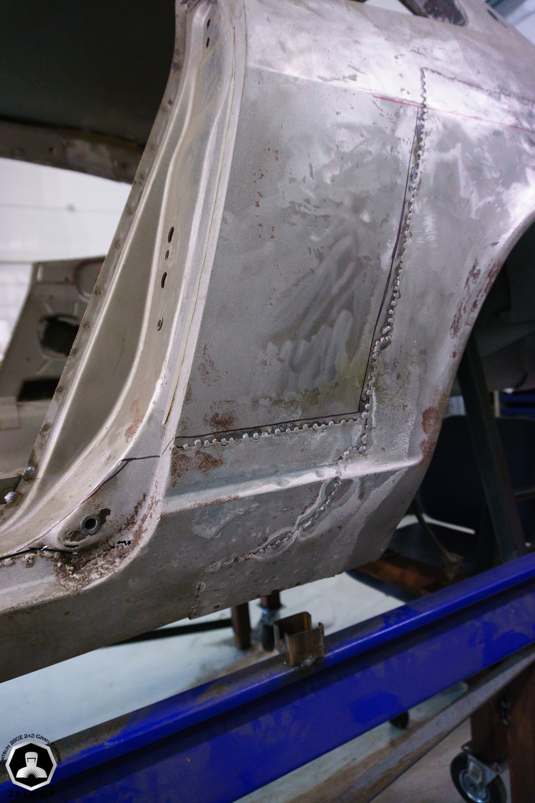

That rust repair requires some mad fabrication skills but luckily you seem to have just what it takes!
Very interesting reading and footage. Good luck with the build.
How is the transmission tunnel height altered by this mod? When I did mine (definitely not finished yet!) I was also thinking of cutting into the transmission tunnel and raising it, but then finally opted for mounting the powertrain as low as possible without sacrificing the ground clearance too much.

Don't know about the "mad skilzz" with the rust repairs... I just take my time and plan the working order so I can be sure to weld
the repaired portions to good and solid metal. Few more tools would be nice (bending brake), but we will see if I can manage with
a nice steel profile as my bending brake!
Might be that I need to outsource making of the rocker panels to my friend who is an automotive sheet metal smith... I will see!

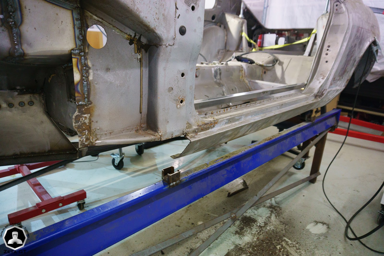

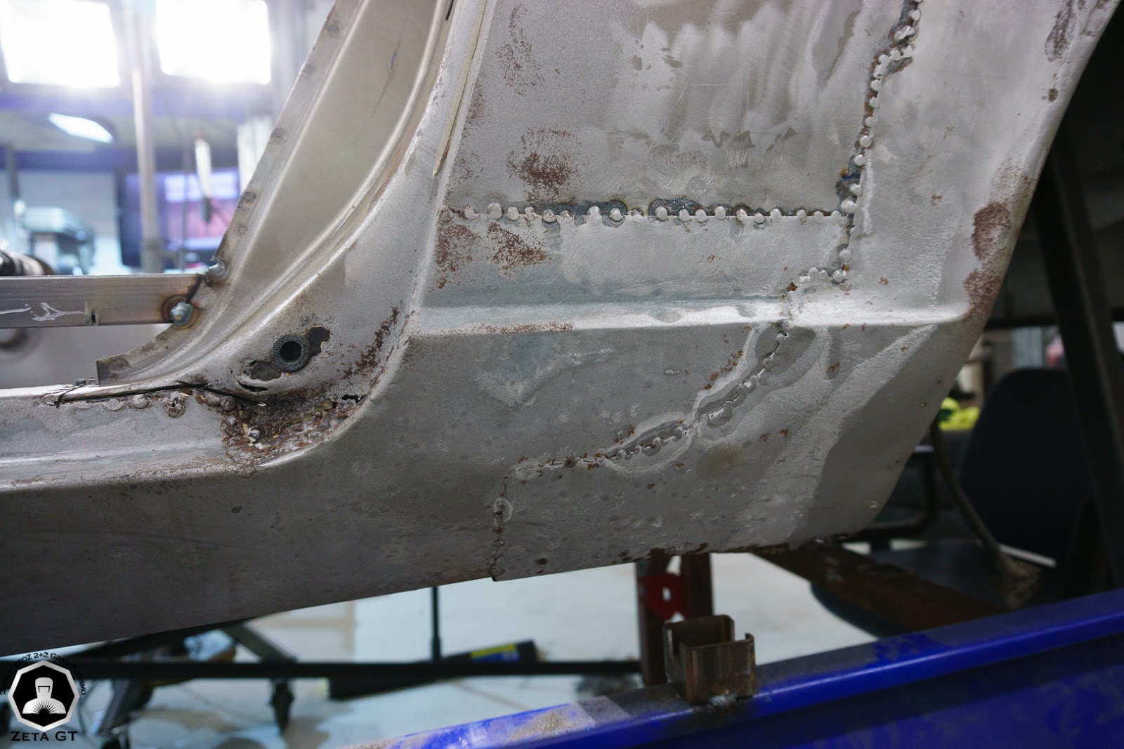

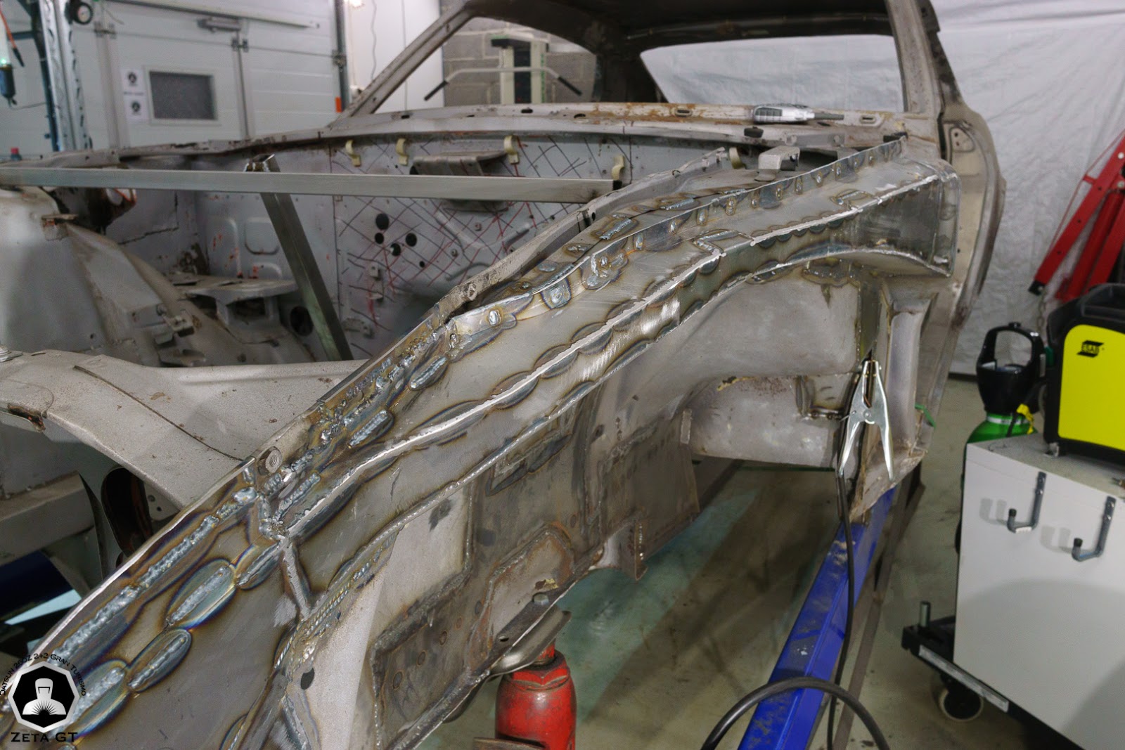

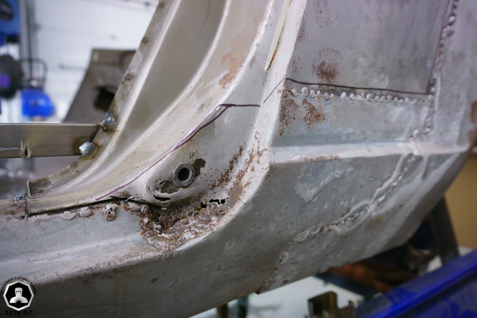

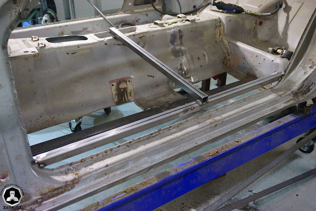

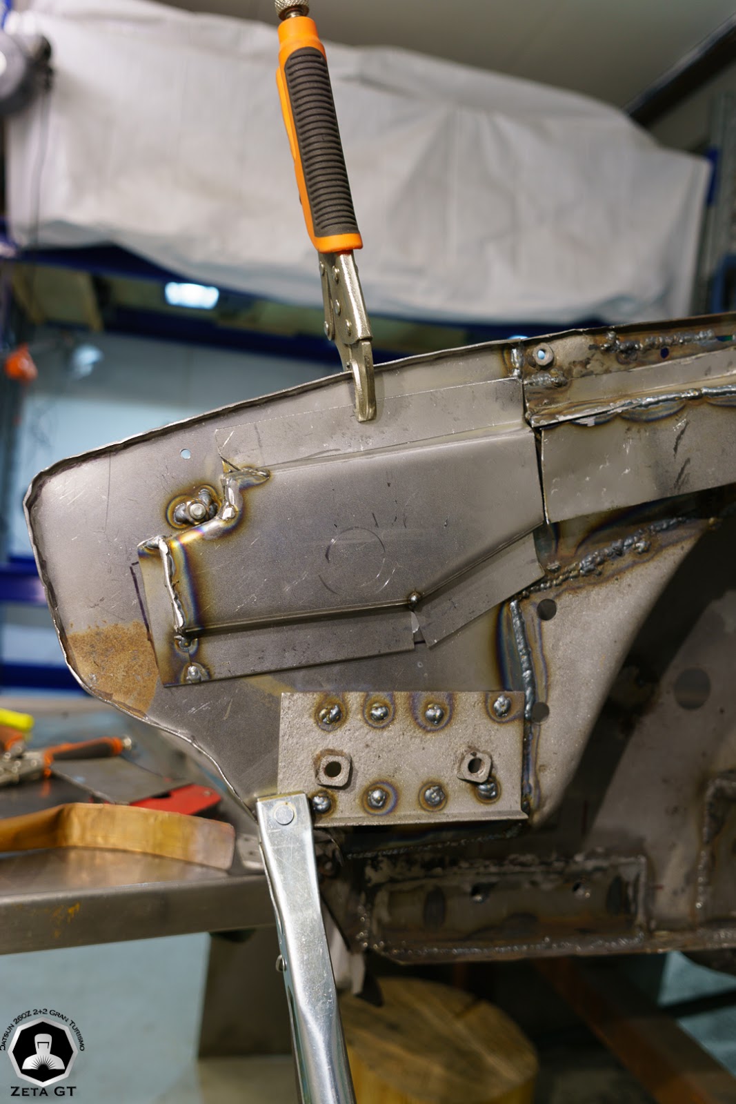

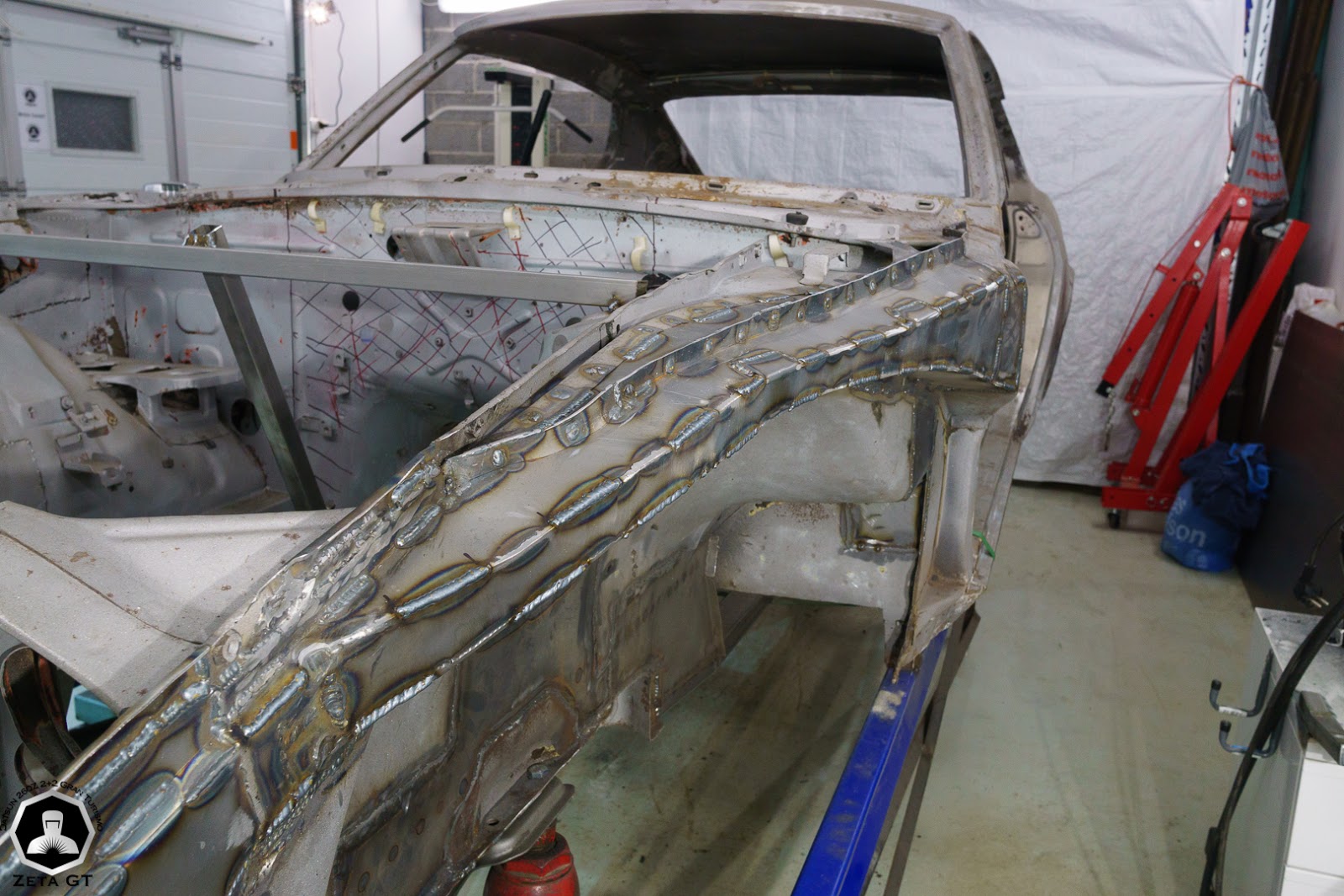

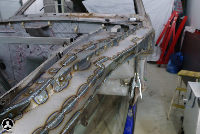

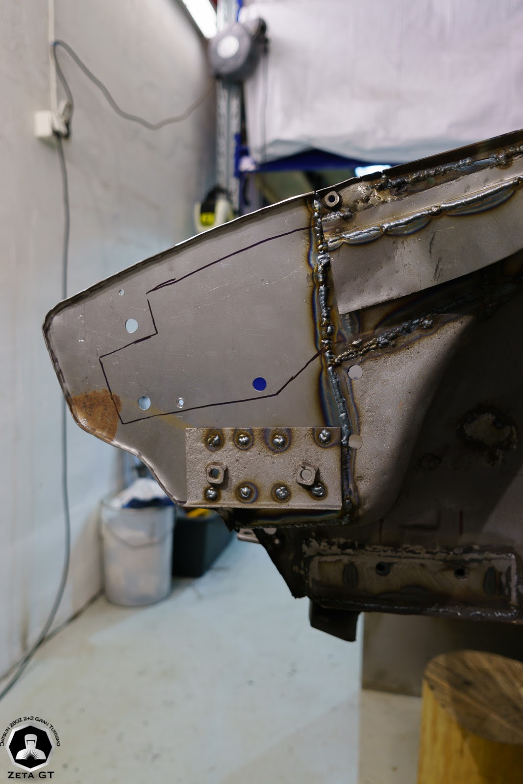

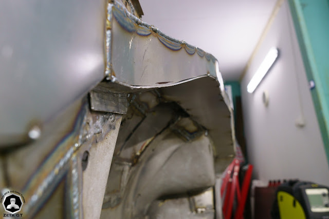

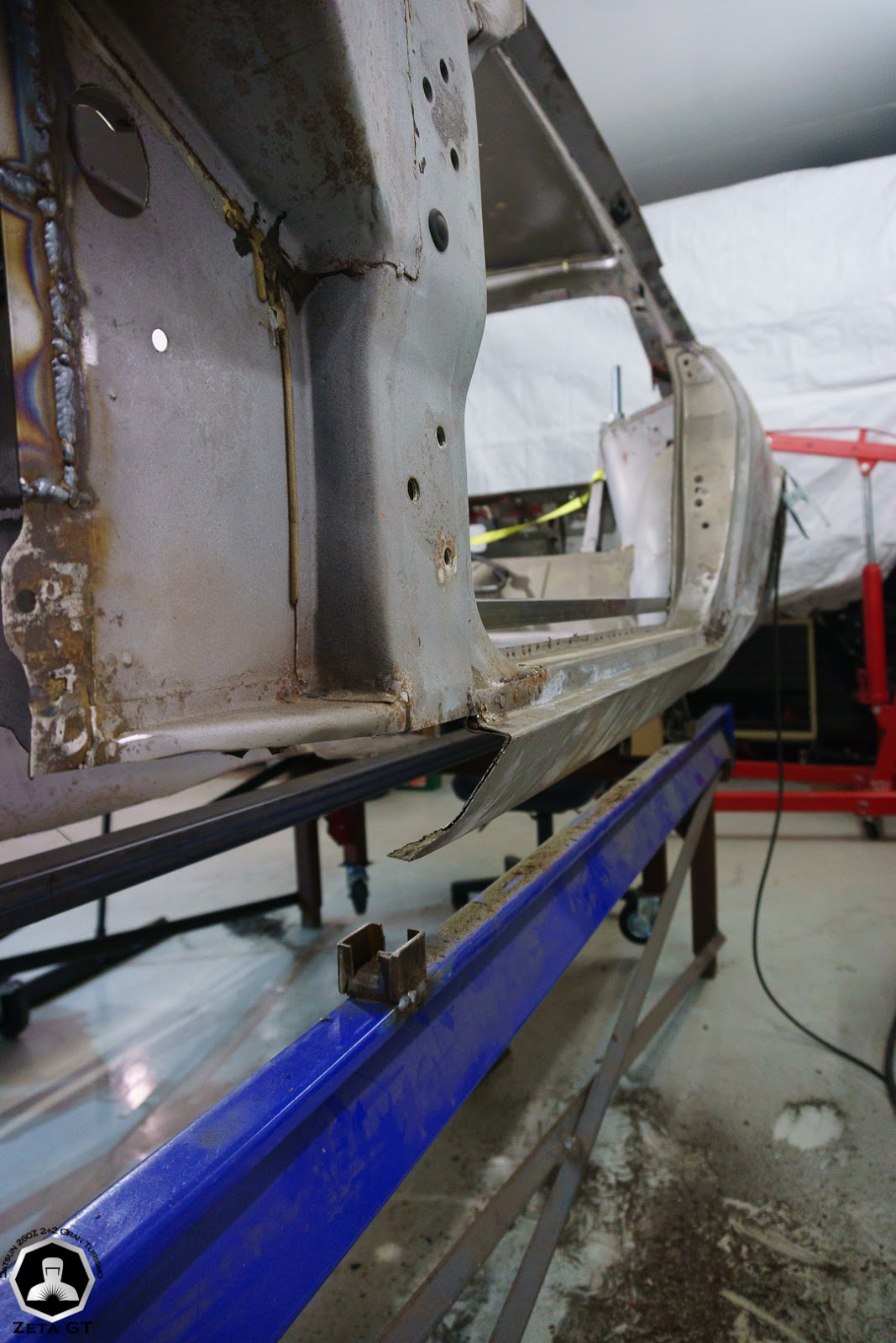

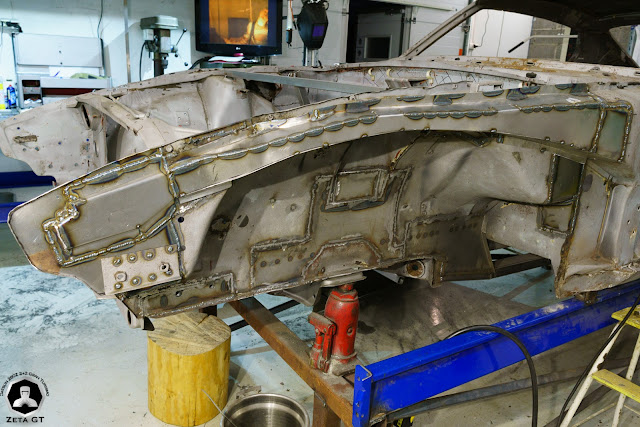

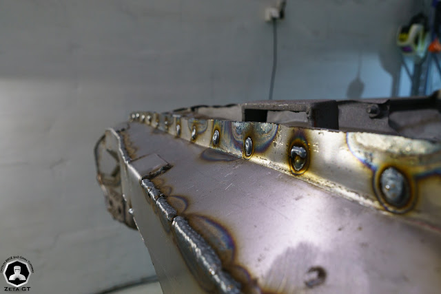

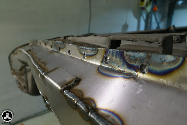

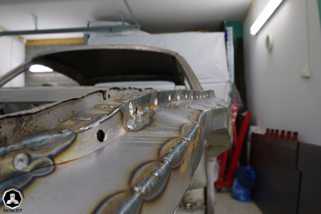

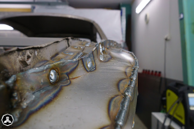

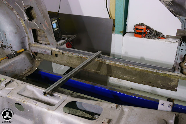

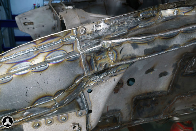

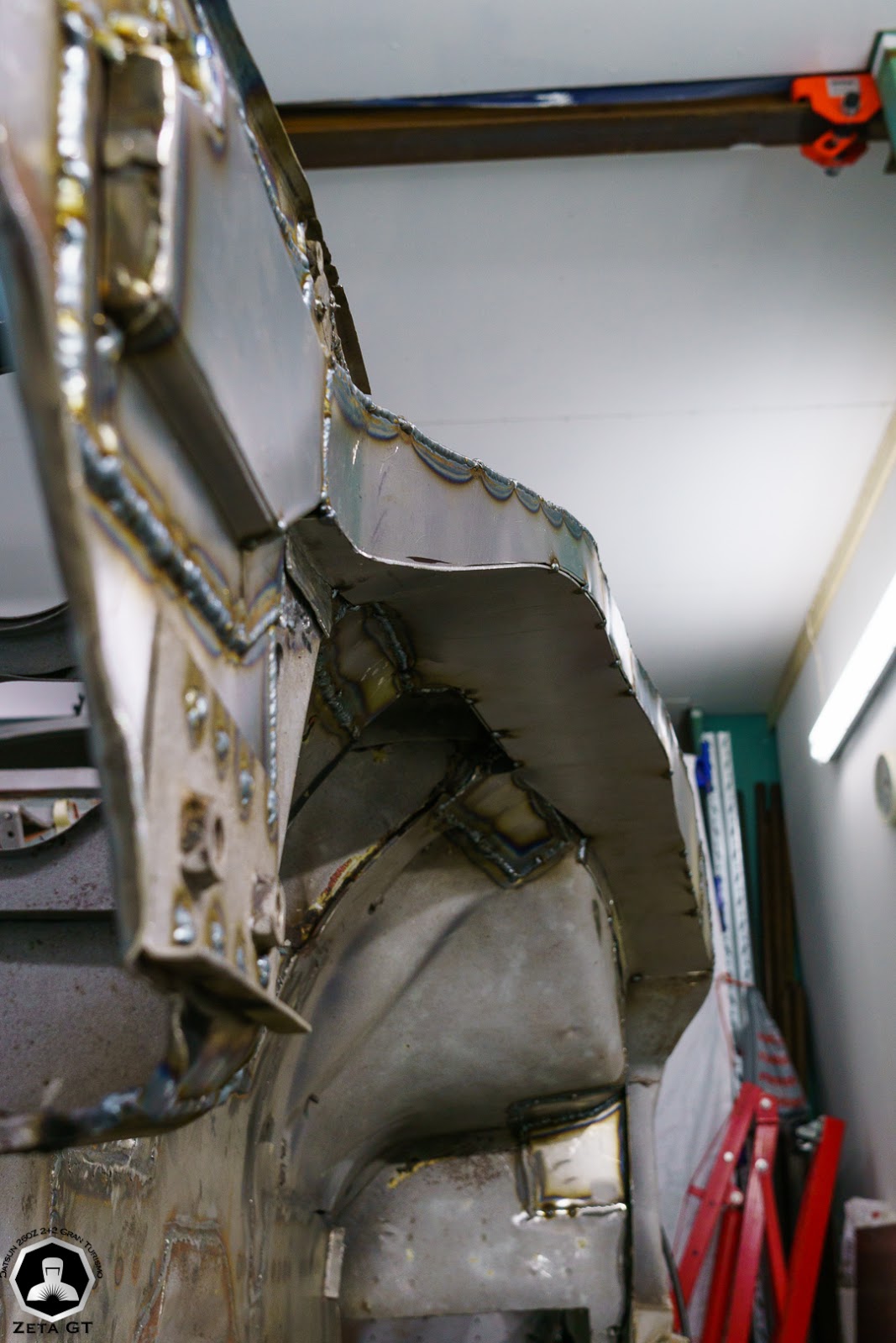

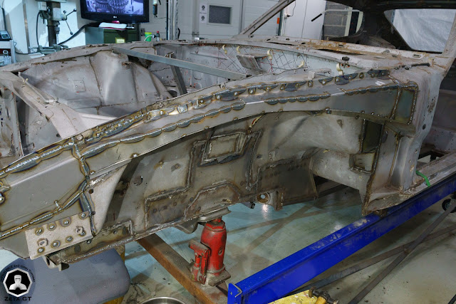

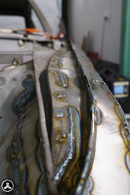

This time around I'm still messing with the left rocker panel, but some progress has been made!
As the keen eyed reader might notice, the left rocker panel is gone as a whole and so is the front corner of the rear arch.
There were three layers of metal on top of each other and all of them crusty rusty. I'm no expert, but it might not have been the best structure.
Rocker panel inner part in the making.

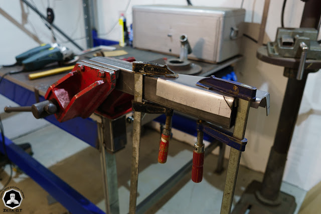

The metal I used is 1,5mm and it will go from the front of the car to the rear inner fender.

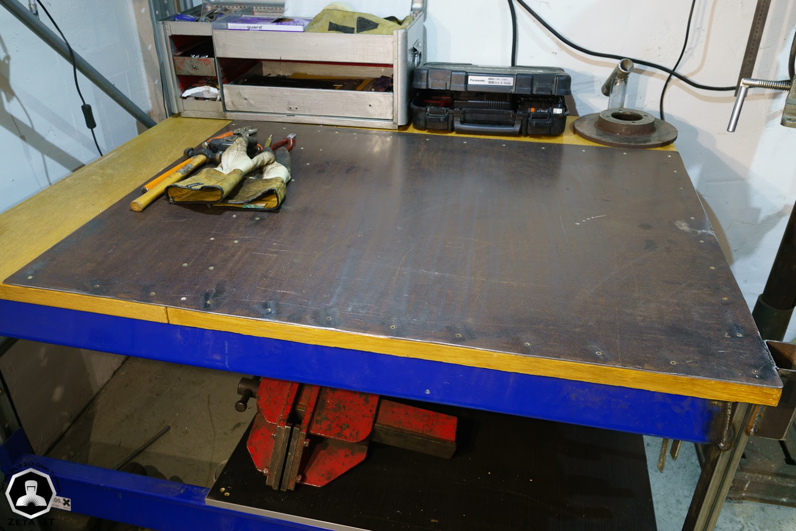

As I don't have a proper dimple die kit, I had to resort to making my own.
All that is needed is (at a minimum) a drill, hand held router, some roofing screws, a sheet metal hammer and hard plywood.
I mapped the needed hole pattern to the sheet metal, drilled through the centers with a roofing screw to mark the
center points to the plywood and then routed 5mm deep circles to the plywood.
To keep the sheet in place, I used the roofing screws and clamps and did three dimples at a time.
The end result...
The panel came out reasonably nice. It did go a bit wavy, but after I put it to its place with clamps, it straightened out quite nicely!
Next I need to get a suitably sized hole saw eg. 50-57mm one and drill the centers out to lighten the panel and to make it look more OEM.
Even though no-one will see the panel once ready...
Still some final fitting to do to the panel before I can weld it in place.

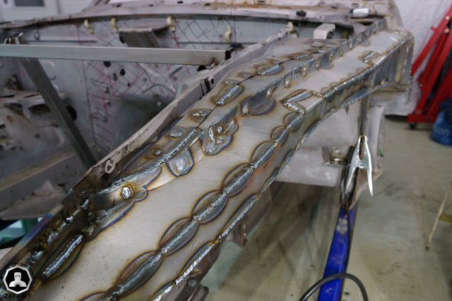

Lets start by welding some metal back... and taking some more out.
I manned up and welded this piece in that I have made few months ago.
The reason for this delay was that I was hesitant about those dimples I made. Then I figured that I can always
take it out or refine it more when I have the proper tools to make proper "speed holes".
Yes the panel is a bit rusty, but I will treat the surfaces with phosphoric acid, so the rust will be converted into iron phosphate.

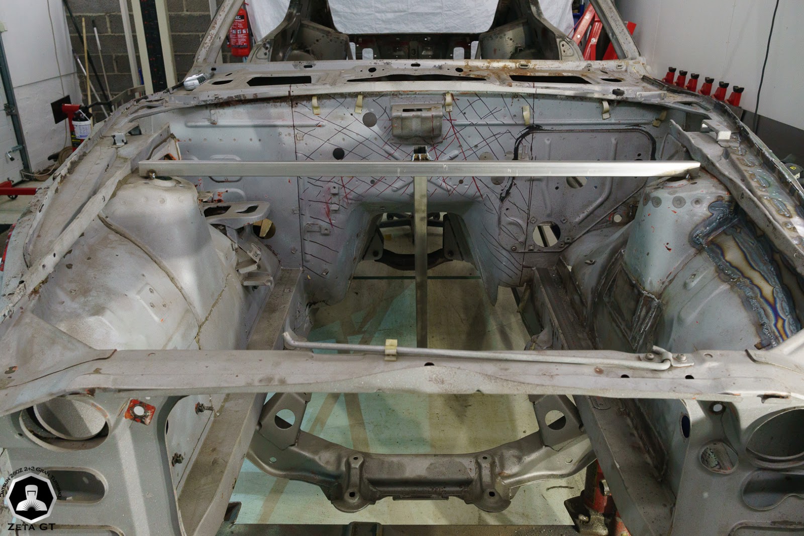

After I had tapped the inner rocker panel in place, I saw that I had to tear more rust out as there were more
patches inside the wheel well.
This is what was underneath the patches...
I don't get it. Why bother to fix rust issues, if you are just creating more problems by welding three (3!) sheets
of metal on top of each other and leaving the rust below.
Quite a sorry sight and where I left off the first weekend.
Rust, rust and rust.
Come the next weekend in this series, I had received my 15 ton hydraulic hole punch.
I had perused from the Internet before purchasing this tool, that one can use it also as a dimple die.
I drilled the centres with a carrot aka step drill to 20mm as the tool needs that as a starter hole and went to town with the tool.
The end result.
My system was that first I dimpled the metal by flipping the cutter side of the hole punch around and using the reverse
side as a dimple die. The dimension of the dimple is 89mm.
Second action was to punch the centre out with a 63mm punch.
Quite a good result, if I may say so!
This plate was meant to be as a pick-up point for the 48mm tube that I was going to run inside the rocker panel.
Measures 125x105x3mm.
Tube in question dry fitted...

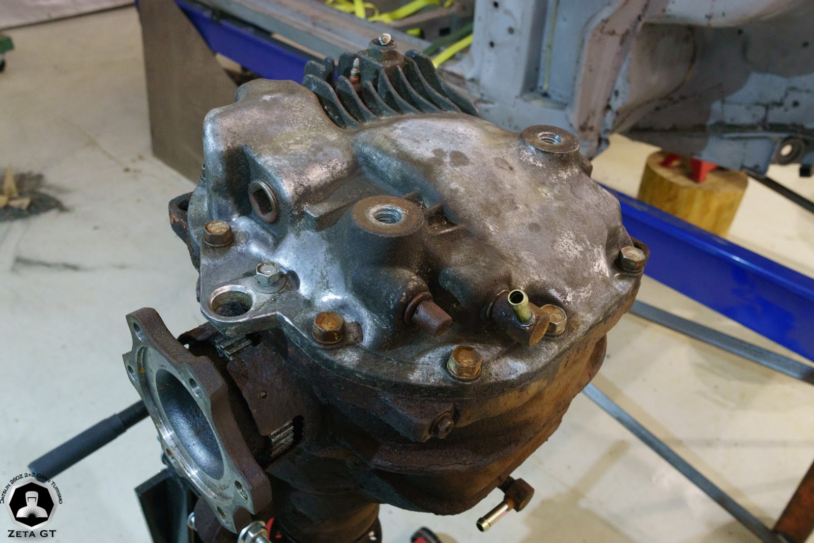

Finally... I packed the transmission in the car on Sunday and planned to take it to the welder who would mate the
Volvo original removable bellhousing to the BMW gearbox.
Unfortunately our timetables did not overlap, so the boot became home for the transmission for the next week.

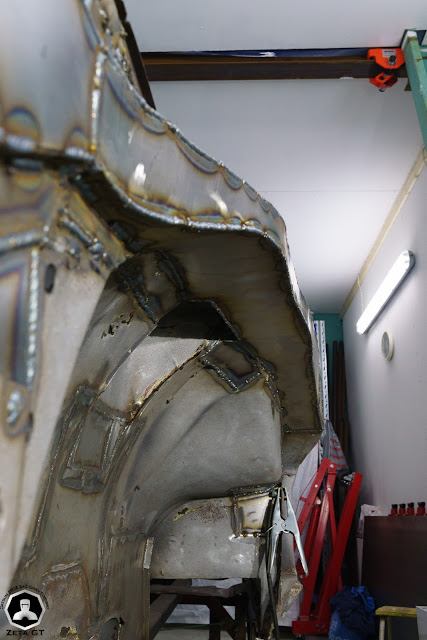

Third weekend I started by dropping the transmission to be welded and measuring and marking the cut lines for the
"rust repair" of the rear valance.
All marked up and to be cut.
This mod lifts the rear line 12cm upwards and at the same time eliminates my rust issues in this sector.
First bite and more to be cut away as I left 5mm surplus material.
All that was cut away.
Again triple stacked metal, rust and more rust and also glass powder and soda from the media blasting.
Before I finalized the rear valance mod, I decided to delete also the rusted out spare wheel well.
I drilled all the spot welds out...
...drew a 70cm circle with a shop ruler to a 1mm sheet metal...
...and then free handed the sucker out.
Plopped it on and only one modification was needed as the rear lock support protruded outward.
Made a notch to the circle and drilled holes for the clecos.
Really nice tool those clecos! Pulled the sheet metals tight and made plug welding really easy!
The grey stuff is through weldable CRC Zinc which should stop rusting, as it acts as a sacrificial anode.
Here is the panel all welded up (might need touching up) and dimpled.
Came out quite nice and rigid! Those 20mm holes will be plugged with rubber plugs and covered with seam sealer as will
be the whole perimeter of the panel and welds.
Here is the "final" results of the valance mod with the bumper mounts chopped off.
Quite neat and tidy even without grinding with a flap disc!

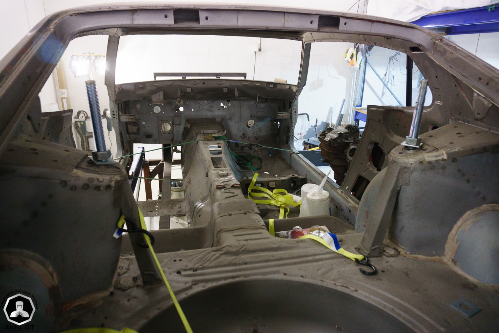

First job was to mark the inner quarter panels to be cut.
I decided that I would like to make a similar shape as the original corners, so I measured 5cm upwards from the cut line.

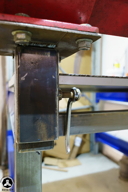

After this I decided to raise the frame jig or rotisserie by 5cm. Now I can just roll around and under the rear of the car
with an ordinary office chair with the back rest reclined (and a bit bent).
Here it is cut and ground deburred.
The part with the marker cross marks will cut away as it still has problems... e.g. three metal layers.

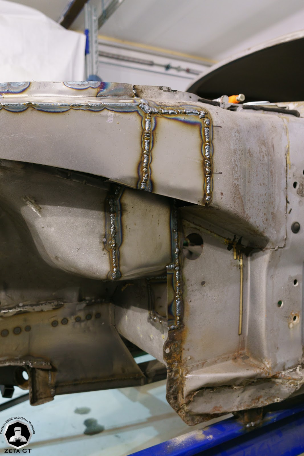

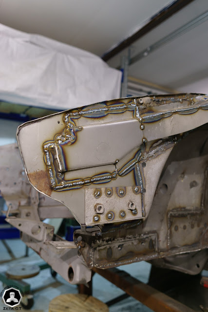

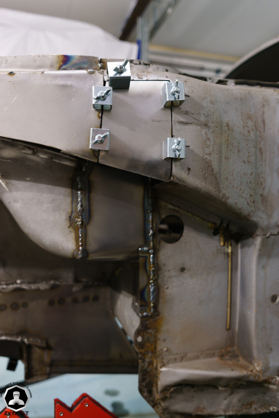

I began tackling the right rear corner by cutting the rotted metal out...
...welding one of the existing seams shut...
...making a quick CAD (Cardboard Assisted Design) template for the patch panel, transferring it to 1mm sheet and cutting it out...
...fitting the patch panel in place with a different type of Cleco and by hand. I tapped it in place with a small weld.
Once I had it in correct place and in correct orientation and angles matched, I began making small welds around the
panel and allowing the metal to cool after a little while.
The original metal was quite easy to burn through, because of the rust proofing on the other side, but I used a flattened
copper pipe as backing and heat sink. This way could fill the holes and get reasonable results.
Once again a half final result.
I will still grind the seam flatter before doing paint prep and "bondoing", but it's quite flat even now so minimal filler required.
Also I need to box up the inner side of this corner, but I try to do it at the same time and panel as the inner quarter panel.
In my understanding (and to my eye), the panel and surrounding areas did not heat expand and the measurements held.

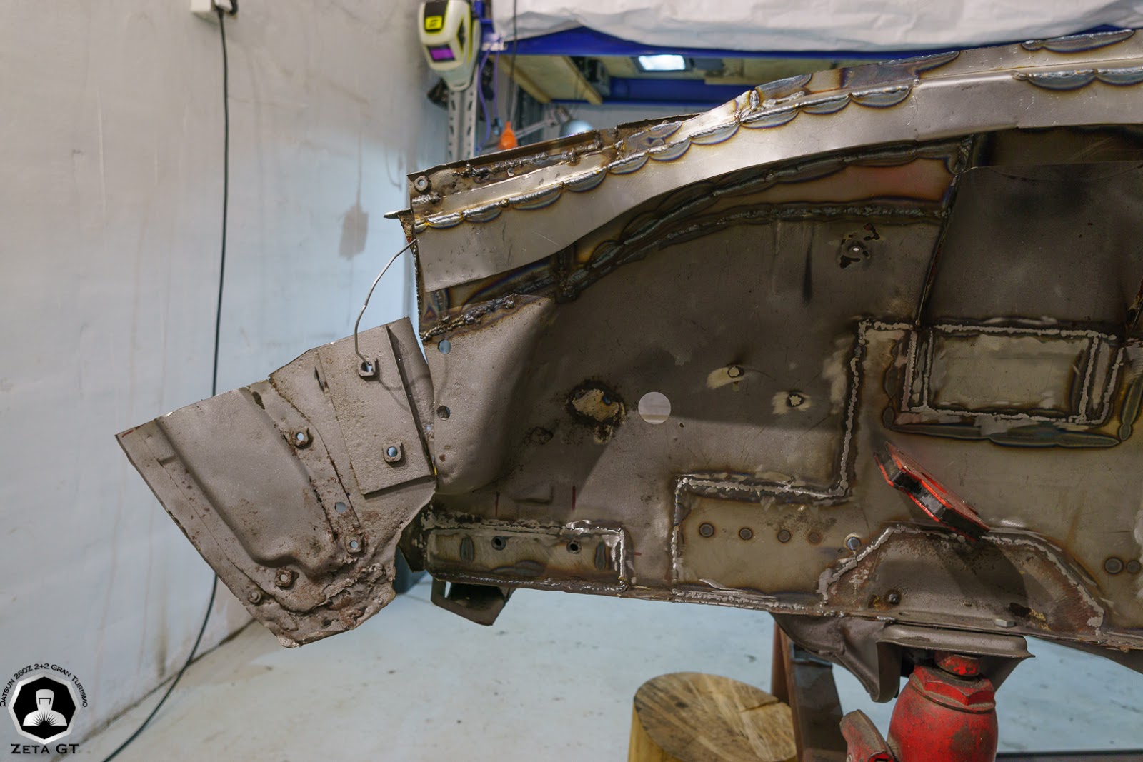

After the right corner, I took an eye for the left one decided to cut it open.
Not a pretty sight...
Cleaned up a bit and waiting for CAD templates for the patch panels.
Well I did make one patch for the inner/upper portion of the corner, but there's nothing to write home about that...
let us just say it did not fit as I chopped it 10mm too short.
Oops.
