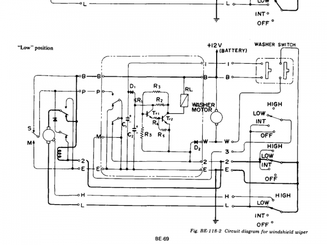

Here's the Wiper FSM from 74 260z:
This diagram is annoyingly hard to follow since they label the wires by function instead of color.
The 6 wires going into the motor in the diagram and their respective colors are:
B (Battery?) - Blue/Red
P (Park?) - Yellow
2 (?) - Blue/White          (Yellow/Green on 77-78 280z)
E (earth) - Black
H (High) - Blue/Yellow
L (Low) - Blue             -  (Yellow/Blue on 77-78 280z)
As a helper I believe the S and M switch is the internal lobe contacts in the stock wiper motor. S possibly meaning "stopped" and M "moving".
Some notes:
The middle part of the switch shows that if the switch is in 'int'/low/high, then it sends ground down the 2 wire. This energizes a relay in the wiper motor that sets the polarity so that it's 12v on top and then gets ground for either the low or high speed windings out the bottom. Tricky part is that if you switch to the off position mid stroke, then the power to the relay is cut mid stroke, so how does it keep 12v on the top of the motor. Well, when it's mid stroke, the S/M wiper will be on M and connect ground to the P wire. But it also lets current flow throw the diode to ground (in the wiper motor) keeping that relay energized till the stroke is done. So now it's finished it's default power stroke. When it gets back to the S wiper, it will invert the power to the top of the motor (you can see the top of the motor connected directly to E (earth). If you Trace the L wire back through, you can it goes back through 3, then into the box, then out P and ultimately connects back to 12v causing the motor to turn in reverse for a given period. I take it the specific phasing and size of the low will determine how much it actually rotates back.
Here's the Honda (1997 accord, though I believe all the colors are the same):
Putting these 2 together is a little tricky, but let me explain why BackDoorZ's diagram above works. He notes in his post that the Blue/white wire is never hooked up to anything. This is because it's sole purpose is to invert the power to the stock motor.
The obvious:
Honda -      datsun      - function
Green/black - blue/red - this is constant 12v power. Basically always send power to one side of the motor.
Black - black - this is always ground
Blue - Blue - low speed wire.
blue/yellow - blue/yellow - high speed wire.
Honda's blue/white wire basically outputs 12v when the wiper is parked, and it outputs ground when it's mid stroke.
By hooking this up to the yellow wire you get the intermittent and park to work.
Looking at the 'int' diagram for the datsun, observe the 2 pole to the left of the capacitors (C1, C2). When the intermittent box actuates, it basically connects ground (E) up to M, which if you trace it back through connects to the low speed side. It probably only does this for a short moment, but enough to get the wiper into motion. But when the int box kicks off, it basically connects the low speed wire up to the P (the Yellow wire). Connecting this to the honda blue/white wire assures that you will again provide ground to the low speed wire till the wiper parks.
I know that is really wordy, but the OCD in me wanted to get all these diagrams out there for those to see why it works or to troubleshoot issues. Can help with understanding why your stock circuit is acting up as well.
ps. if you want to understand how the pie piece works on the honda diagram, assume the large part of the pie rotates and it is ground, the left small pie piece is 12v and is stationary, and the middle contact connects rides on whichever one is below it.

Confirmed!
1975 280Z
Hooked my 91 Honda civic motor up today with jumpers, and this is 100% correct. Bump this thread. Save yourself 30 pages of reading
Mist, delay, low, high, and park. All work.
This should work for any S30, 73 and up.
Thanks ya'll!
