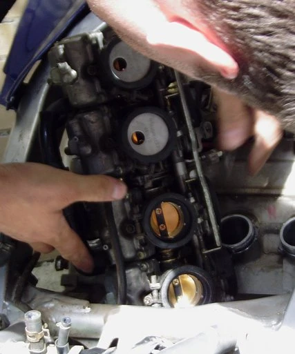

How could I cut non visible 100hp ?
The car needs to pass a dynosession done by the government aprooved dynoshop. (180 SAE HP max.)
Are there any inlays/inserts available to choke down the ported inlet channel (cylinder head)?
Choke down the tripples?
Block the throttle to 50% max (to easy to see)
Do you have any ideas?
Thanks

Well this is a fun exercise.
What are you running? Whatever it is is 280hp apparently. If it is a V8 you could cut spark and fuel to 1 bank. If it is a turbo you can just keep the waste gate fully open. If it is a high compression NA L6, I'm not sure what you could do other then make it run pretty bad via restrictive exhaust and intake.
It is the reverse of making a car run well. So you have air, fuel, spark, compression, exhaust you just have to limit those without causing too much damage. I imagine limiting air would be a relatively easy one.
Share this post
Ya, limit airflow. Trying to cut 100hp via timing, fuel, etc. is going to be difficult and potentially risky. You could waterjet cut some thin sheetmetal restrictors to go between the carbs and the manifold, or between the intake and the head. This will probably be the least obvious as you're not going to get a big change in engine sound like you would with timing or cutting spark to cylinders. This will take some trial and error to get exactly what you want.
Share this post
Change the throttle opening for the first and third carbs so they don't open fully.  Inspectors are most likely to only check the center carb because its easier to view. Reduce timing.  Loosen the valve adjustment.  Change the cam timing (retard it). Richen the carbs to 10 to 1 under load.  Add an exhaust restriction.
Share this post
I concur with intake and exhaust restrictions.  Childrens motorcycles are restricted in exactly the same way.  As previously suggested build restriction plates for both the intake and exhaust manifolds and then tune your carbs to match the new flow.  This is going to be tricky to determine if you are under 180hp without a dyno though.  If this is a regular problem i would consider using another set of stock carbs tuned to your restriction plates so you could bolt on a known system in the future.  An RPM limiter set real low might help as well.  Good luck
Share this post
Thank you all for your thoughts
Exhaust / intake noise  is 5 db to high as well
I will start with smaller jets, less Timing advance set, set the throttle opening at 90% max, loosen the valves by 0.05mm, set the rev limiter to 6800, install an Airbox and restrict the exhaust.
Then I will go on a Dyno to see where I am.
Next step restrict the carbs. I have to find a non visible way (internal before the flange or make my own casket)
This is really cool from all of you

Put a stock Camshaft in it.  Easier than Intake and Exhaust restrictors and nothing to be found. Take some ignition timing out of it ( 28 -30 degrees total Mechanical ).  Set rev limiter to 6,000 RPM or less.
Camshaft change will drop your exhasut DB levels as well . An Airbox will take care of Intake DB levels.

Holy crap that sucks man. You can make a gasket that restricts your intake manifold down to half size, that may make a bit of torque but it sure as hell will choke up top. May as well set the limiter absurdly low like 4500 or something, it's not like they'll ask you to raise it. A big exhaust restriction will help a lot.

I would imagine the intake restriction and lower rev limit would take care of the excessive noise and horsepower (I can't believe there is such a thing).  If it were me I would build it into the carb spacer, you can build them with simple tools and they swap easily.  Full disclosure- the extent of my smog knowledge was acquired when my tech told me to pull my brake booster vac line in my 86 corolla to clean it up.  It didn't work, I moved and haven't had a smog fit since.  This all sounds incredibly stifling to me... best of luck!

one thing you could do is change the wires on three of the cylinders to wires that won't connect.  this way, you get an immediate 50% cut in hp.  I'd pick every other cylinder in the firing order to make it somewhat even. not great fort he engine, but...  faster and less complicated.
you could retard the timing a lot if you have a distributor, but that might make your exhaust louder. also not great.
you could put a very restrictive air filter(s).  that might help.  something very small, or somehow blocked off.... unless they can force you to test without filters..

Ok finally I passed.
I did change the Jets, retarded the Ignition and especially put a Air Box with a hose connected to the smaller radiator support hole (just 2")
The mix of that brought me to 170hp and the rest I blocked the max throttle (underneat a piece of carpet nicely hidden)
Attached is the final Dyno Value up to 4680 rpm because it stayed there up to 7000.
Original was 120 DIN Hp and they accepted the 140 HP (+20% max. is allowed).
The Brakes I changed as well back to Drum.
The noise was also a good thing, because the measurements are taken at 80% of the max HP RPM value (in my case 80% of 4020rpm = 3216rpm) I passed at 74dB (max 74).
