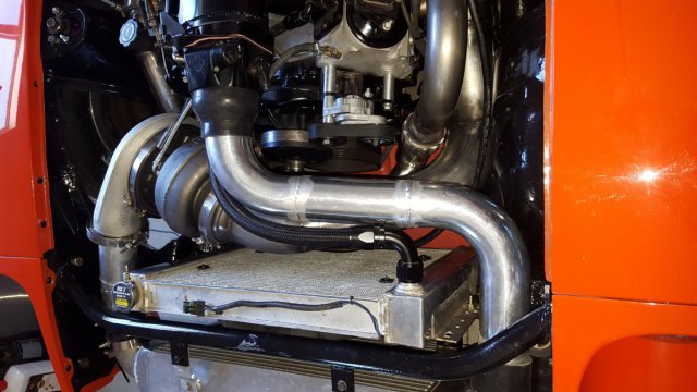

CableSrv    17
I'm about to go Turbo, however I'm finding it hard to route headers since I have the stock alternator location and JCI's ac compressor location setup. The driver side I am hoping I can get away with having the truck manifolds turned upwards and forwards... and hopefully that will give me enough clearance to pass over the compressor. If not, I might have to mock up something to go over it.

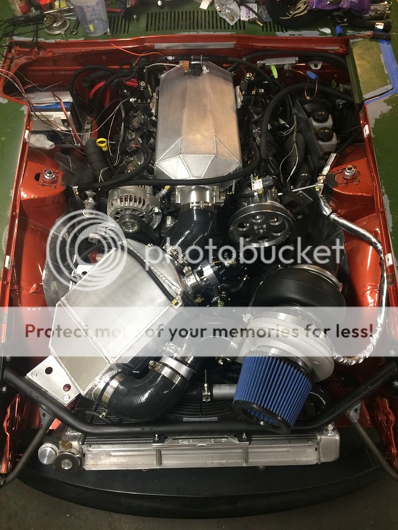

zspeed22    10
Zspeed22-
How did you mount your alternator?
I milled the back of the alternator so the plate mounting to the head would be flush with it. Then using a stock Fbody mount for the rest of it directly to the engine.

CableSrv    17
I got myself a GT45 turbo and no way I can fit that between my radiator and engine! Not to mention since I have the JCI ac compressor kit, I can't do forward and under as there simply isn't enough space to fit a header output through there. I'm going to have to run a forward and up system, but even then I cannot fit my turbo between my radiator and engine... just not enough space! I'm either going to have to cut my radiator support and move it and get another 2-3in's. Not sure how everyone else is fitting their turbos with AC as well. So far every picture album I find, it looks like no one is running ac and a turbo?

zspeed22    10
Elegant in its simplicity! Which water pump and balancer are you using?
All accessories are F-body. With milling the back for the single bar and keeping the stock F-body mount it worked proper for spacing of all F-body accessories.
Waterpump -  AC Delco part# 252-846
Alternator - AC Delco part# 334-2486A this is a reman part.
Tensioner Assy - Gates part# 38195
Idler Pulley - Gates part# 38041
Balancer/Pulley - Fluidampr part# 740111
There is no power-steering pump or ac involved with this setup of course. Also I have not sorted out the part number for my belt yet. I need to get a line and measure it.
