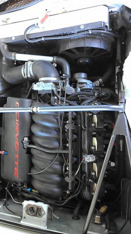

Fast forward to last week; Z now out of winter hibernation, initial startup and all my lifers are talking and zero oil pressure. Shut it down, check oil [i change my oil each fall prior to storage] which is good, restart and after about 5 seconds [feels like forever] my oil pressure climbs to 25 and lifters are quiet.
Long story short I drop it to the shop again and they determine that the oil pump is not supplying sufficient pressure.  When I first did the swap I had the oil pump inlet & outlets ported for better flow.  They also installed a new cam retainer plate [while in there].  Now I have instant and higher oil pressure at startup as well as better pressure at higher RPM's.

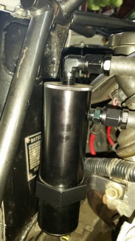

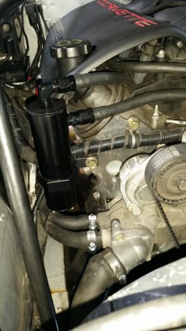

Other upgrades for reliability & durability: double row timing chain, oil catch can/separator.
