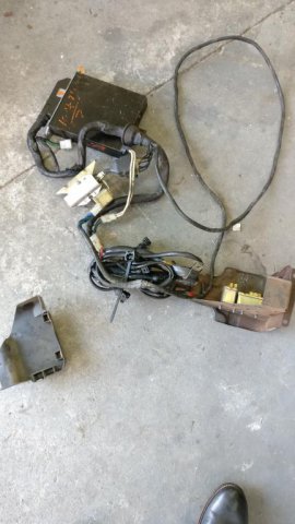

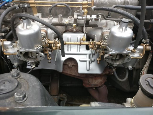

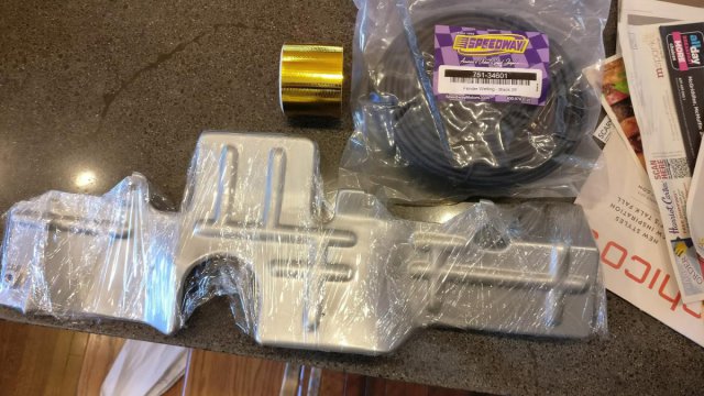

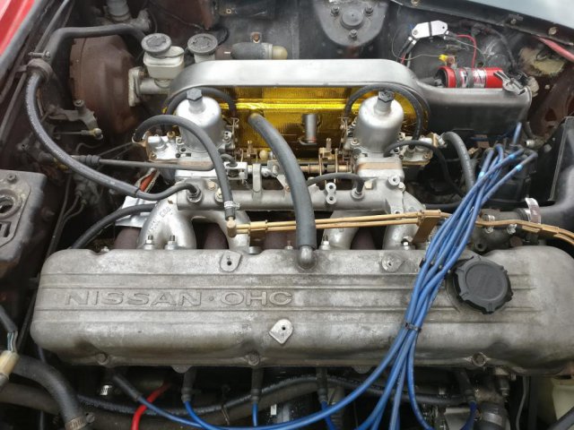

Got a few more things in the mail today! I got a much needed carb heat shield, reflective insulation tape, and some fender welting for the ZG flares. Also removed a bunch of the efi wiring that is no longer needed since the carb swap.

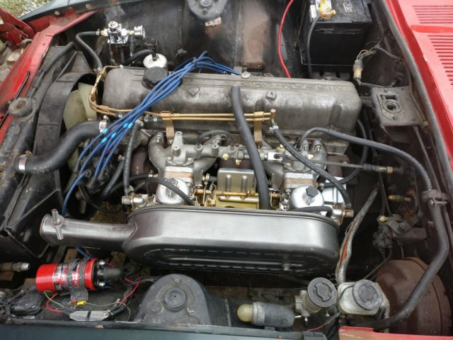

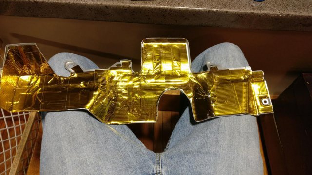

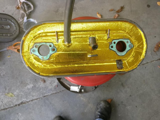

Decided I would try out this heat reflective tape on the heat shield and on the back of the air box. Still have to do a little more wiring since I am swapping out the fuse links with a maxi-fuse box... i'll report back on how the reflective tape works out.

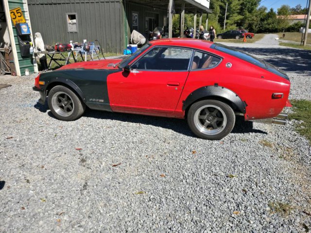

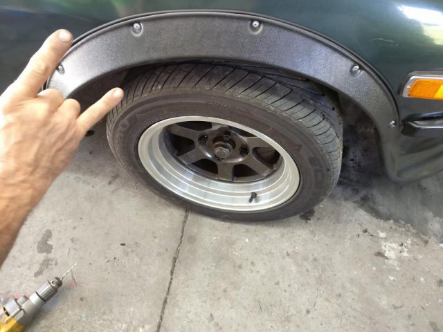

Got some fender flares and popped the fronts on... still messing around with fitment on the rears

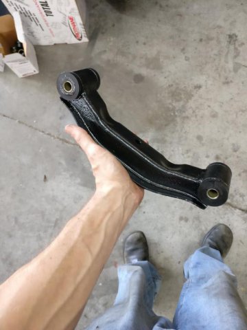

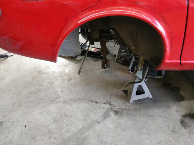

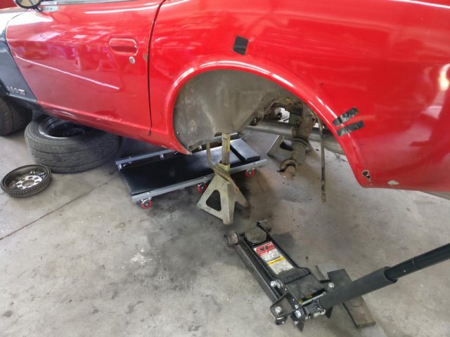

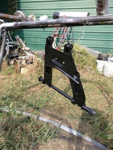

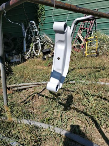

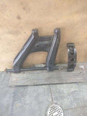

Started tearing into the rear today. I had sand blasted and painted an extra rear control arm I had a few months ago so that's why it's dusty looking. I still need to disasemble the other one and if I have time I will do the same. I also had an extra transmount that I also sand blasted and painted. What was a nice surprise was that there are a couple of new mounts already there so that a few $$$ saved. Plan is to use up the rest of the poly bushings kit that I have, put in the new wheel bearings, and put the S13 rear disc brakes on. I also have ordered a set of strut bellows since the set on the car are pretty much toast.

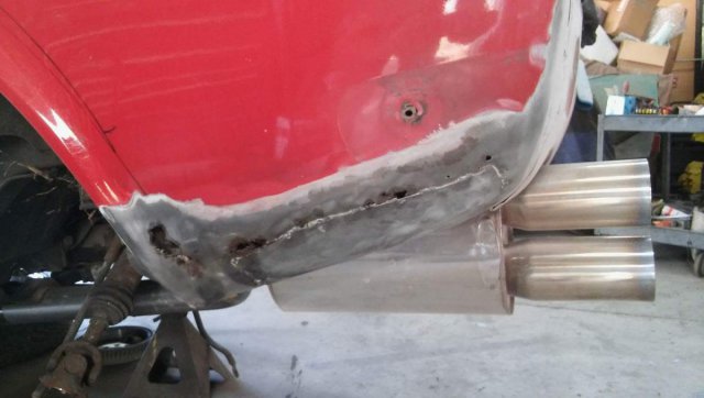

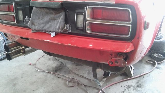

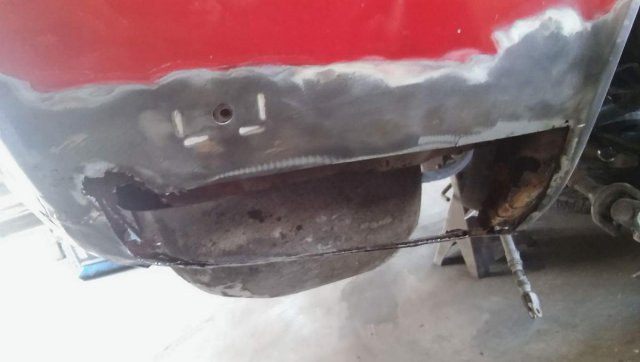

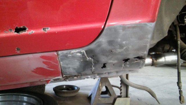

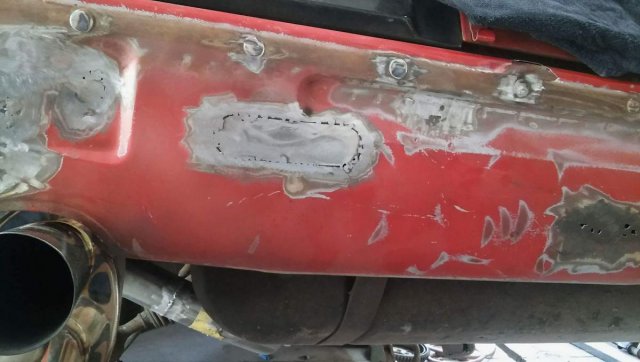

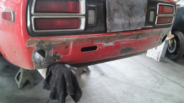

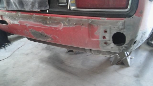

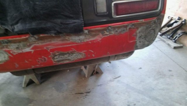

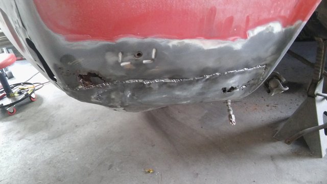

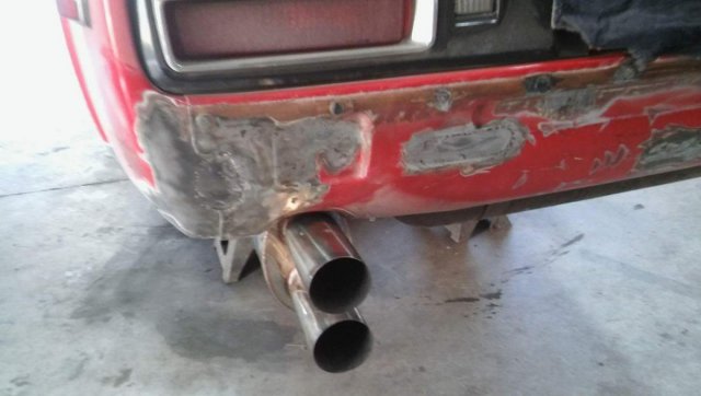

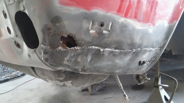

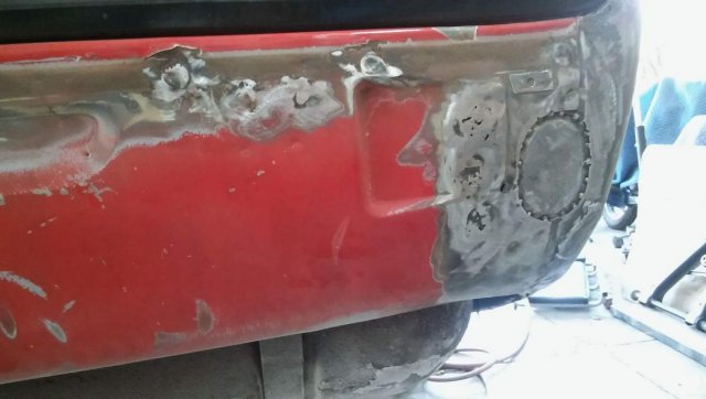

well since my struts were shot and it was going to be a little while before i get them in the mail, I figured I'd see how bad the prior "repairs" were and ended up cutting out most of it. I'll be ordering a patch panel for the passenger rear qtr for sure. I think my buddy can fix the prior "repair" without having to weld in a new replacement panel. Also cut off the duckfin and welded in some metal to patch up the few holes that were back there.

Posted 20 October 2016 - 04:31 PM
more pictures... removed about 7-8lbs of bondo that's what that pile is

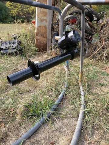

decided to go ahead and get both rear fender patch panels. The patch that was already there was just shoddy craftsmanship. I am waiting on a spindle from MSA because while the one of them came out with relative ease the other one will need to be cut. While the struts were out I noticed that one of them was leaking oil so I got a set of Stagg struts with Vogtland springs. I can't comment on ride quality but I can say that the build quality of the struts look great. While I had the rear suspension out I sandblasted the other rear control arm and both the hubs and painted them. I forgot to get pics of the shock combo but will snap a few later on. The rear wheel bearings appeared to be fine but I had already ordered a set and will be replacing anyway since

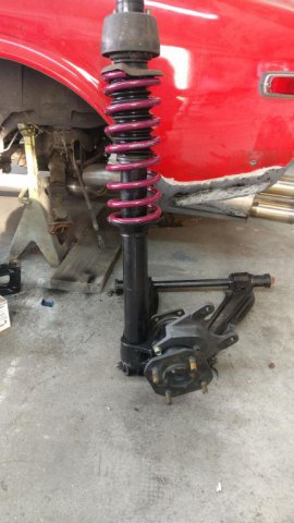

Mocked up one of the rear struts w/ the Vogtland springs. (yes i know that the bump stop doesn't go there :D) Waiting for another spindle pin to put the other side together

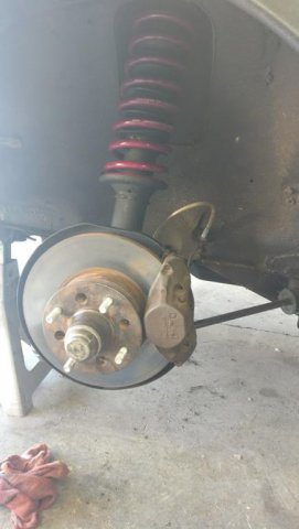

After not really spending much time on it over the past while I finally got to spend 1/2 a day working on it again. I got the front suspension put back together and bolted in. Those are Vogtland Springs and Stagg shocks. While I was there I replaced the brake lines for braided steel. I am hoping today I will get to put the rear suspension back in.

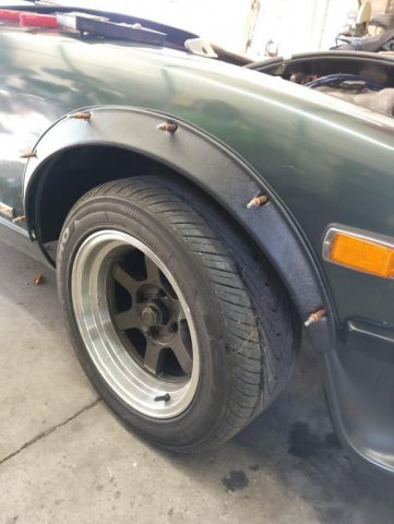

Today I got the E brake cables hooked up to the S13 Calipers, Painted the rear tail light panels and bezels, and mounted the rear fender flares so I could figure out what size wheel spacers i'll need. Here are a couple of pics of mounting the flares. I didn't rivet them in yet because of still needing to weld in the patch panels.

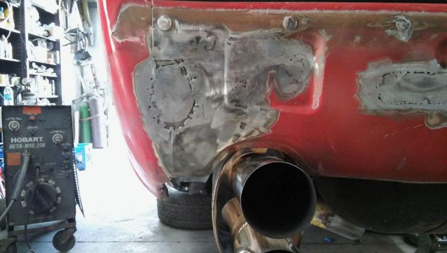

Finally got some time to put in some sheet metal

and some more pics... hopefully ill be able to finish the other side later this week

Don't have any new pictures to post but I got the other side welded in. I still need to weld up the inner fender to seal the hatch area from the outside. Currently I am driving it around and tinkering with tuning the SU carbs. But this thing drive amazing. I'm really impressed with how it handles on twisty roads compared to my '01 Audi A4.
