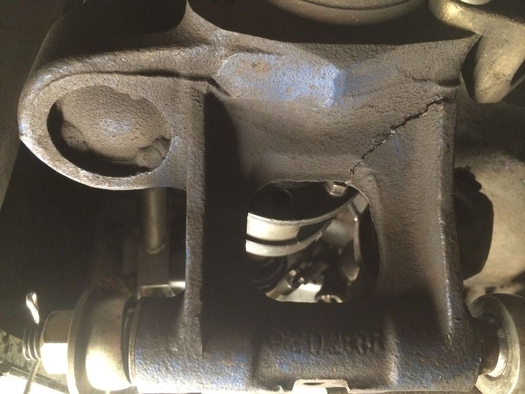

Broken rear upright
Happened yesterday at VIR on my 240Z. 44 year old casting with who knows how many miles, 10 years of racing plus the VIR curbs and one cracked through. Luckily I noticed before it totally came apart. Havent taken apart yet to get a good picture. So anyone seen this and reinforced to prevent? Its one of my biggest fears racing the Z is something breaking like this with modern sticky tires. Also APB out for replacement beefier later 260/280 uprights if you know of or have some available please let me know. Hopefully near central Illinois but will ship if have to. I want to replace them all front and rear and am currently out of commission for in the meat of the race season.
Cameron
Did the crack start at the screw holes where the parking brake cables would attach?
Did you have screws installed in the holes?
Wrong side. Those holes are in the back, the front side cracked where there are no holes.
Damn. The sort of stuff you just put out of mind. I guess everything, given enough time/abuse, is prone to failure.
Were there signs of failure or did you just get lucky on an inspection?
It was really loose. Still drivable but could feel something wasn't right. Then under yellow noticed it felt like dirt car where the rear haunched up under power and the steering wheel was about 10 degees off center going straight. Got real lucky because made a couple laps in anger like that.
