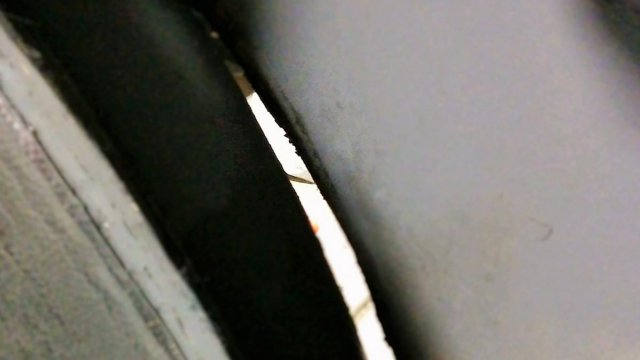

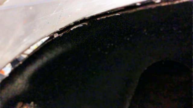

Here's a couple photos I could focus on the rust I'll have to cut more out. Since I will have to cut more I won't be able to fold it and weld it like it would normally be done.  Figured I could use the panel bonding method with structural adhesive then it would still be bonded and I wouldn't have to try and weld higher up.  Only in the rear wheel arch area is needed.

Get some help from a hot rod shop and have that welded. Structural adhesive is good for binding panels that touch one another, not filling holes. My fab guy here in Florence could fix that no prob....when he got around to it. These guys tend to be "artists" and most of them work at an artist's pace. But I can't do what they do, so I'm used to long delays.

I wouldn't use it to fill that hole, I would use it with those panel bonding pieces from Eastwood to keep certain parts of the panel together.  That hole was a seam sealer that fell out from old age, that I will have to fill but I won't be using the structural adhesive. Just FYI to the big hole you see.

Gotcha, so you were thinking of patching using new material from the outside in. I would say bridging the gap with a piece of metal welded in would be better. Trying to bond two non flat panels in awkward planes can be difficult since you can't use clamps to hold both planes.
