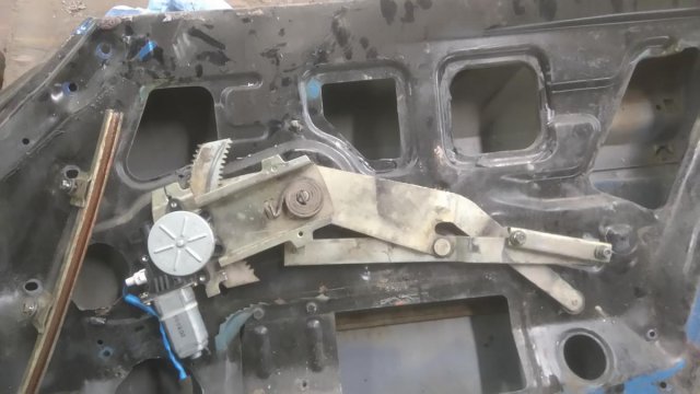

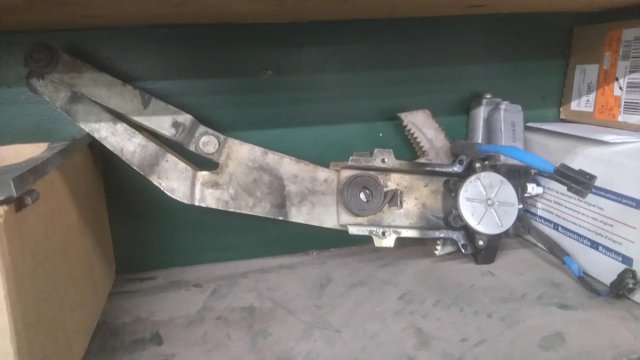

 The motors from the front doors of an '05 Subaru Impreza. The gear tooth pitch is the same as the original spindles, with the two minor details to keep in mind being: The Datsun spindle has 7 teeth, while the Subaru motor has 8 teeth, and the pilot hole needs to be drilled out a little. I don't remember what drill size, exactly. Just make sure it's snug, but still moves smoothly

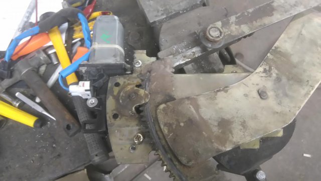

I started by drilling out the three riveted points holding the original spindle in place, removing it. I then determined where the motor had to sit, marked off the area it needed to go, and cut into the bracket mounting flange, so that i could flatten it out around the spindle area.
 You can see the two holes I had to drill out for the motor to mount. Note the screws.

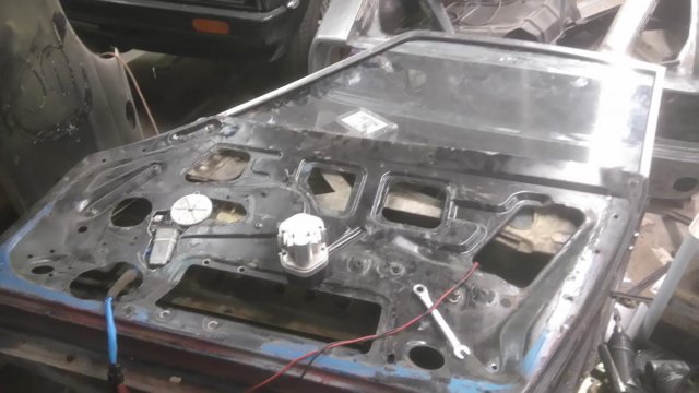

 I layed out where everything needed to go on the door to check for any interference points. All clear, so far.

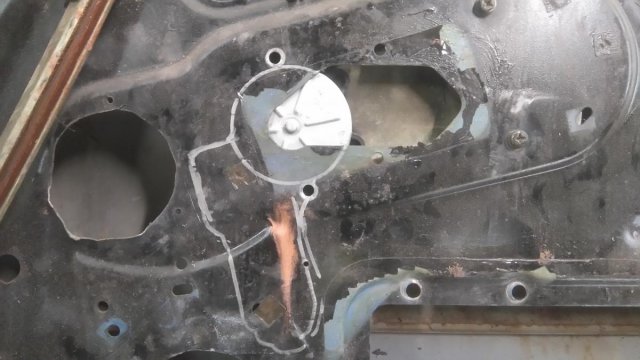

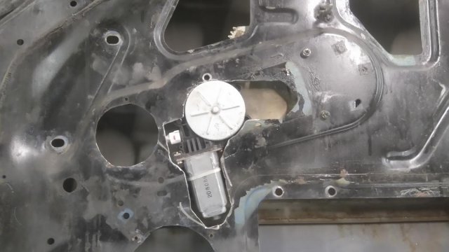

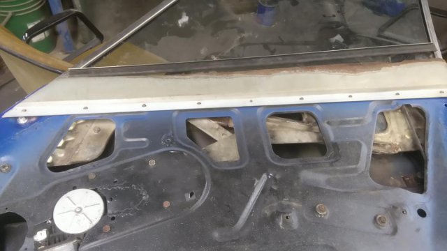

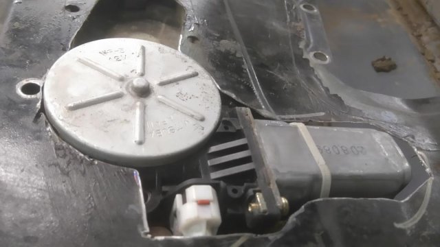

I bolted the un-finished assembly in place to trace where I would have to cut metal out of the door, as the motor will have to sit through about 1/8" - 1/4".
One session with the zip-wheel later...
Just pokes through...

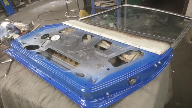

Assembled everything on the door for clearance/bind testing. All good.
Assembled operation test video here. Still needed to final-adjust rails, hence why it wasn't put up all the way.

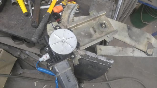

The finished brackets with motors mounted.. I had to trim some of the motor flange back on the regulator, and weld in some trimmed 1/2" x 1/2" angle steel channel on either side to brace the regulator, as well as provide a new mounting flange for the door, complete with new captive nuts.

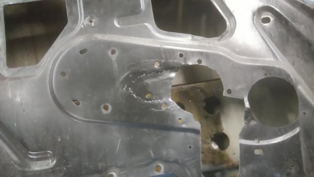

Hard to see here, but I welded in a section of sheet metal to fill in part of the void where the original regulator came through, to add structure back into the doors.
Doors are now assembled, adjusted, and sitting in a shed until they're needed for the car's final assembly
