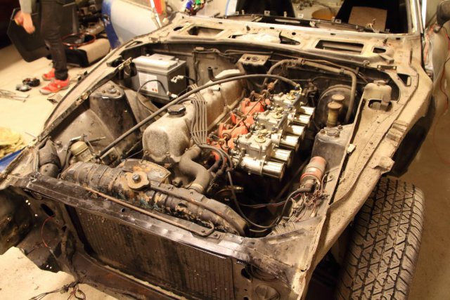

Thought I´d finally start actually posting a bit about my restoration project, telling the story as it goes and hopefully also get some well needed advise on the way. It will be intermittent updates as I don´t have constant access to the car.
Through a friend I got wind of a Datsun 240z for sale just 20 km away from my parents home in southern Sweden. I decided to drive over and have a look. To be honest I did not check all the items which probably should be checked before making such an investment / expense, but the owner gave the right impression so I decided to go for it almost instantly.

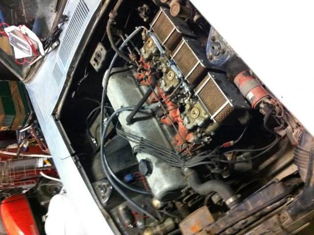

The car is a Datsun 240z from 1973 imported to Sweden from the Netherlands in 1983. The owner drove it until 1990 from when it was put into warm storage. There it rested until I bought it in the summer of 2014. The L24 drive train was swapped for a complete L28 drive train from a 77-78 280z including an upgrade from SU to Weber carbs. The cam is mildly aggressive, but I don't know any numbers.

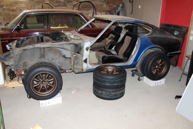

Attached File  Pre-Pulling Apart.jpg   172.26KB   1 downloads
Attached File  IMG_0677.JPG   164.86KB   0 downloads
Attached File  IMG_0672.JPG   126.39KB   0 downloads -> L28 + triple Webers

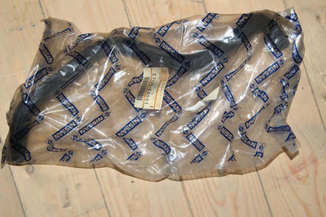

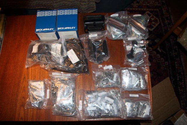

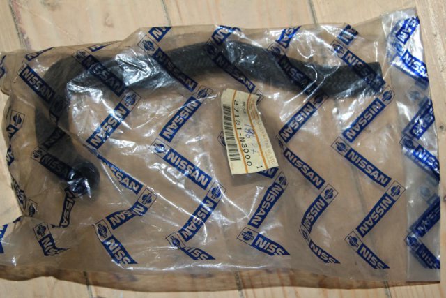

With the car I also got some additional parts.

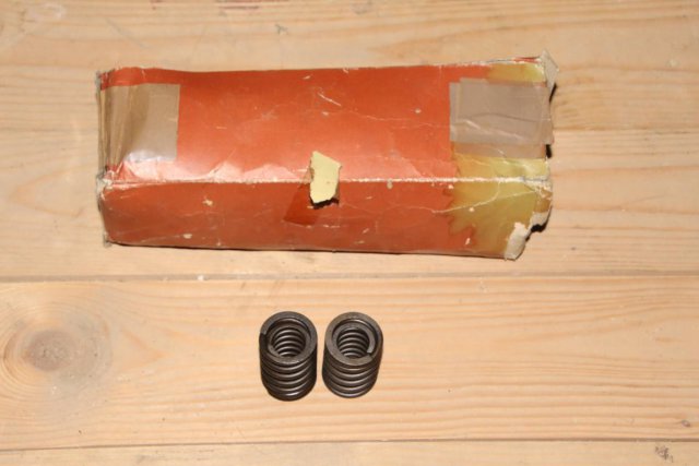

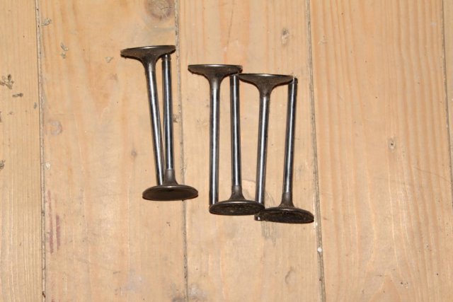

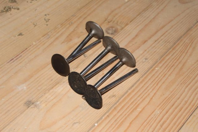

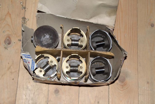

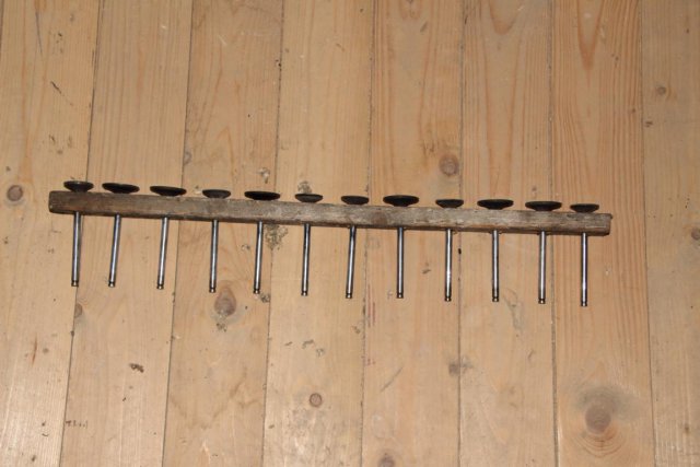

Attached File  IMG_2442.JPG   50.71KB   0 downloads - Original L24 block. It has taken a hit during storage while sitting without the head on. Would require substantial work to get going again.

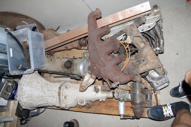

Attached File  IMG_2435.JPG   129.52KB   0 downloads - Mixed parts from 280Z and 240Z drive trains.

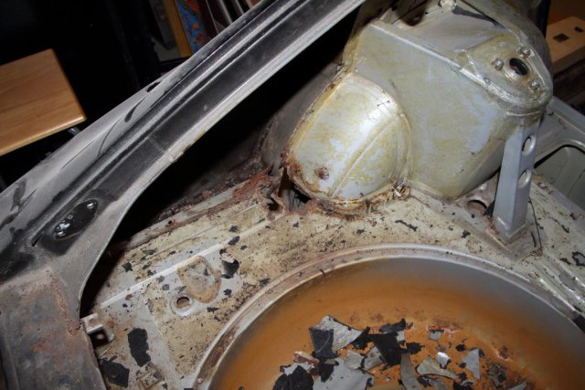

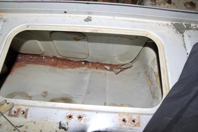

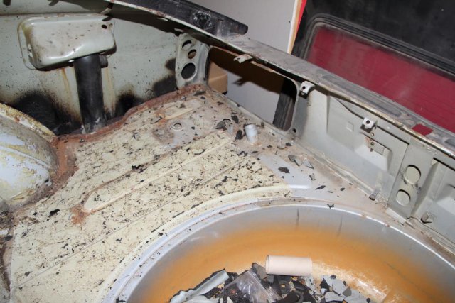

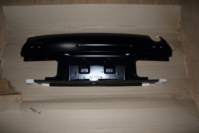

Attached File  IMG_2449.JPG   66.03KB   0 downloads - New Rear panel. There is some rust where the rear hatch meeting the rear panel, and a panel was bought to fix this.

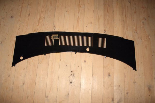

Attached File  IMG_2450.JPG   79.09KB   0 downloads - New cowl cover panel. There is some rust in this area, not too bad what I can see.
Attached File  IMG_2451.JPG   59.26KB   0 downloads

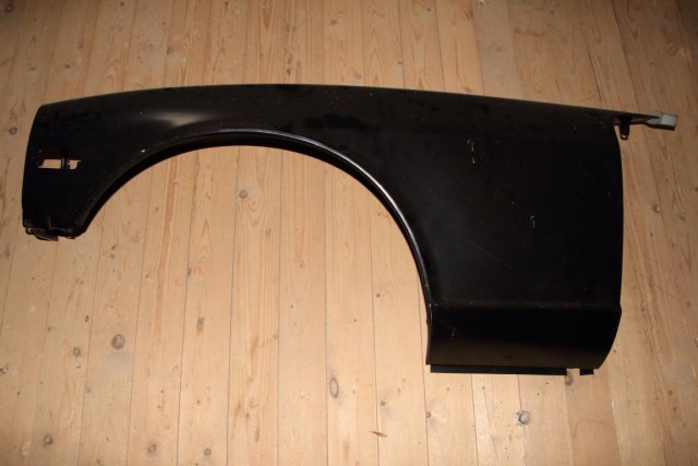

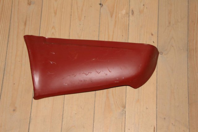

Attached File  IMG_2454.JPG   71.31KB   0 downloads - New front left fender. There is a parking damage and the previous owner bought a new panel to fix it.

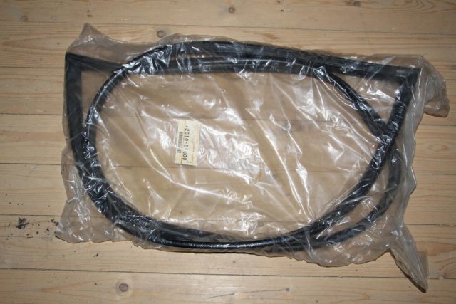

Attached File  IMG_2455.JPG   131.04KB   0 downloads Attached File  IMG_2456.JPG   129.04KB   0 downloads - New heater hoses
Attached File  IMG_2460.JPG   141.18KB   0 downloads Attached File  IMG_2459.JPG   115.63KB   0 downloads Attached File  IMG_2458.JPG   85.13KB   0 downloads Attached File  IMG_2457.JPG   97.93KB   0 downloads - Weather stripping

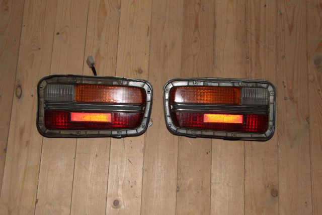

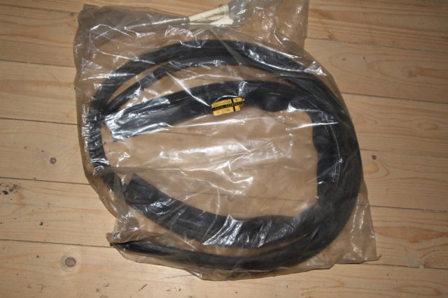

Attached File  IMG_2461.JPG   91.22KB   0 downloads - Extra rear lights

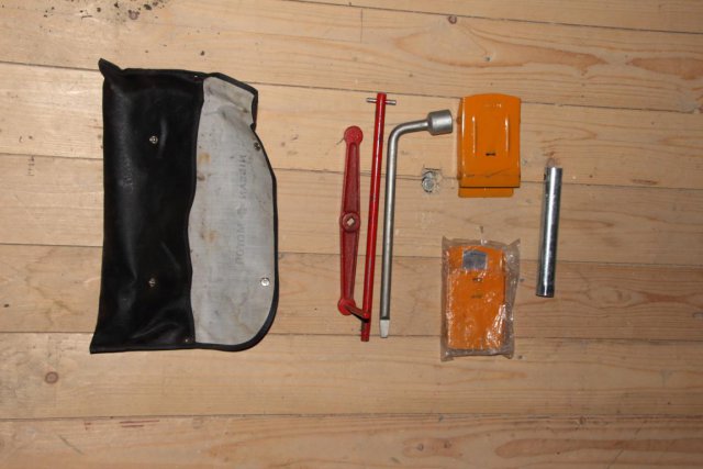

Attached File  IMG_2463.JPG   86.84KB   0 downloads - Tool kit
Attached File  IMG_2473.JPG   67.06KB   0 downloads Attached File  IMG_2477.JPG   103.79KB   0 downloads Attached File  IMG_2464.JPG   85.54KB   0 downloads Attached File  IMG_2465.JPG   88.86KB   0 downloads Attached File  IMG_2480.JPG   84.83KB   0 downloads - L28 Dished pistons, extra valve springs and 2 sets of valves.

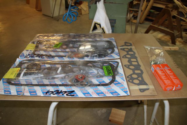

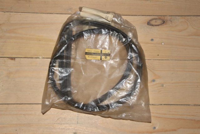

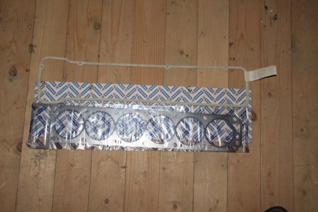

Attached File  IMG_2481.JPG   104.38KB   0 downloads - New head / rocker cover gasket
Attached File  IMG_2483.JPG   86.58KB   0 downloads - Chrome lists were taken off and stored away. Not sure if it is a complete set, but they are in good condition.

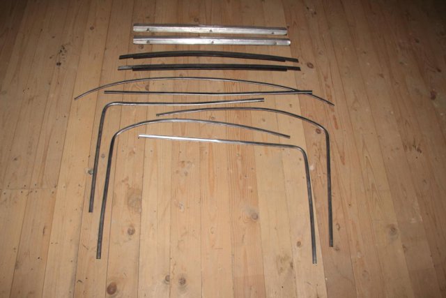

Attached File  IMG_2485.JPG   39.26KB   0 downloads Attached File  IMG_2489.JPG   50.29KB   0 downloads - Original airbox and SU carbs with intake.

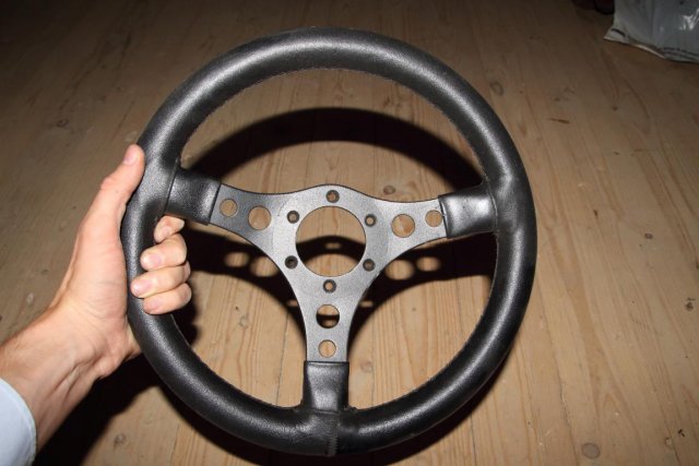

Attached File  IMG_2488.JPG   98.75KB   0 downloads - Anyone know this steering wheel? It is made in France if I remember the writing on the back correctly.

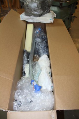

To further catch up with my progress - some parts which were acquired so far for installation after ground up restoration are.
Attached File  IMG_2365.JPG   124.44KB   0 downloads

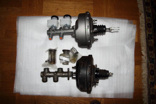

New vac booster and wilwood 1" brake master cylinder. The vac booster is 8.5", so a slight upgrade from the original 7", but I hope it is sufficient to soften the pedal. Otherwise I'll work up a nice right leg  :lol: Do you typically keep the brake balancing block? I.e. the block which houses the pressure imbalance switch between rear and front circuits. I have issues finding replacements for this items, plus the absolute recommendation from Nissan / Datsun is to not refurbish it.. I guess I could live without it. In addition I swapped the front / rear brake proportioning valve to a Wilwood product so I can adjust the bias later on.

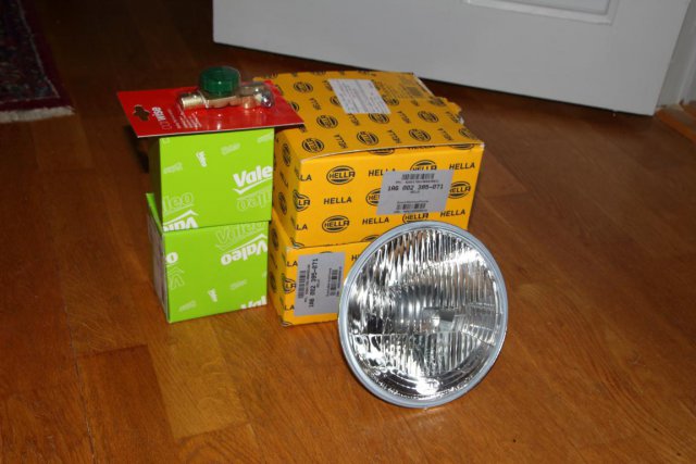

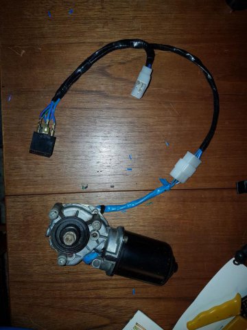

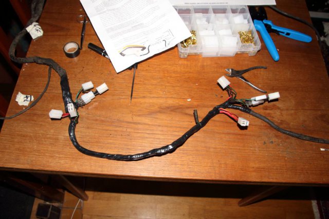

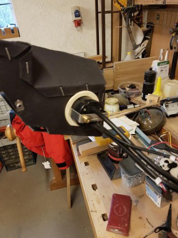

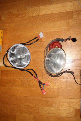

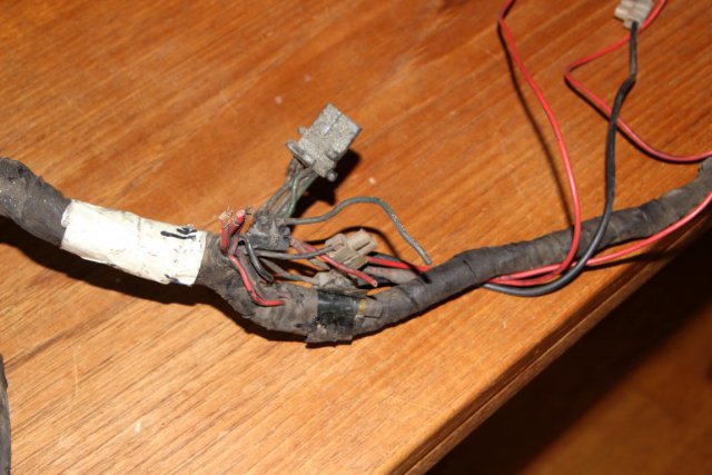

New Hella H4 head lights and horns (air horn was installed..). I decided to also rewire the main headlight as the original wiring was quite butchered. I suppose it wasn't easy to get hold of proper connectors and color coded wires resulting in wiring all over the place. In the end I managed to find a kit in the US with original Japanese connectors and new properly color coded wires from England. The housings were also sent for sand blasting.
Attached File  IMG_2330.JPG   120.76KB   0 downloadsAttached File  IMG_2333.JPG   135.11KB   0 downloadsAttached File  IMG_2334.JPG   104.88KB   0 downloadsAttached File  IMG_2332.JPG   125.21KB   0 downloadsAttached File  IMG_2340.JPG   130.08KB   0 downloadsAttached File  IMG_2341.JPG   116.41KB   0 downloads

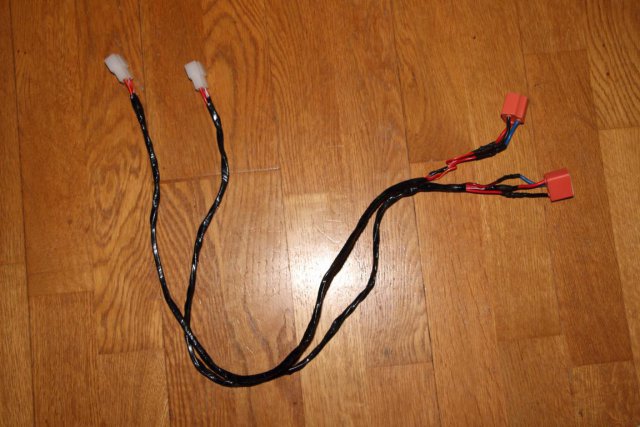

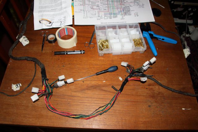

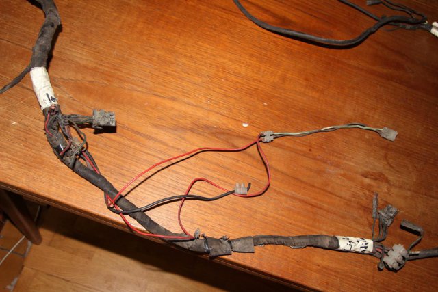

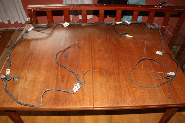

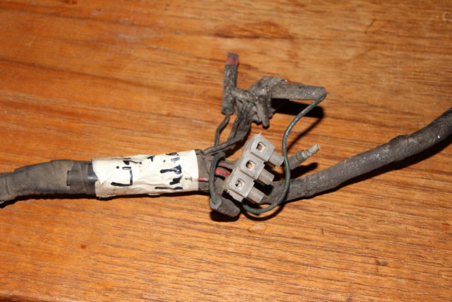

As you can imagine the engine harness in this region was also in bad shape. I decided to install new connectors and order them in such a way that it suits my needs. I decided to wire the side marker conversion kit directly into the harness. In addition I got the headlight harness upgrade kit as well as the parking light upgrade kit.
I haven't yet sealed or put dielectric grease on the connectors, anyone aware of good products available in Europe (or perhaps the US)?

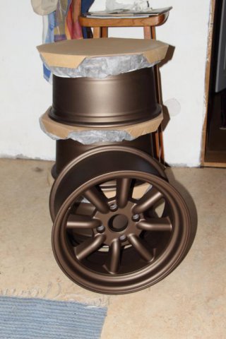

The original wheels are unfortunately too small for my brake plans. The original wheels say "Shelby" on them, however I have no clue from where they originate. Anyone familiar with this type of wheel? The new set of wheels are Rota RKR in bronze and the tires are Toyo Proxes.
Attached File  IMG_2311.JPG   119.11KB   0 downloads

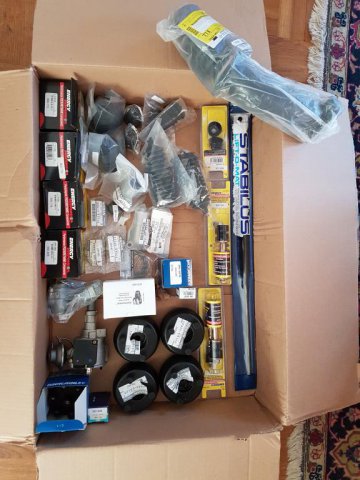

A nice present arrived from the US as well  :D
* Rear disc conversion kit with calipers
* Front / Rear brake rotors
* Front calipers
* Eibach progressive springs
* Tokico shocks
* New set of wheel bearings
* Urethane bushings all around
* Clutch master / slave cylinder, throw out bearing, fork etc
* Some additional small goodies

Those extra tail lights, would they be for sale?

Before I make any promises I'd to check the status of the ones currently installed on the car. I'll keep you posted!

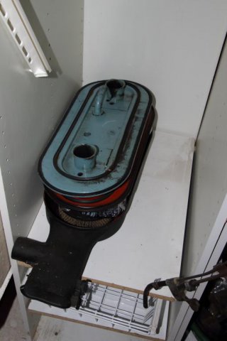

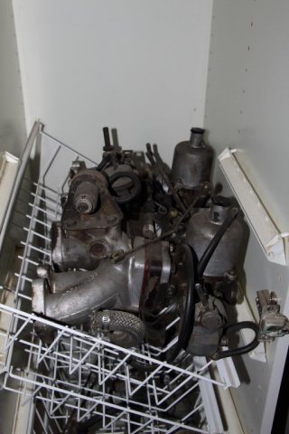

Best pictures of before and after carb refurbishment (filter boxes will go back on at a later stage);
Attached File  IMG_0674.JPG   129.8KB   0 downloads  Attached File  Överblick 4 - Dag 2 - Motorrum.JPG   158.28KB   0 downloads

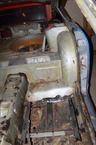

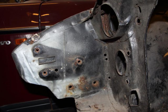

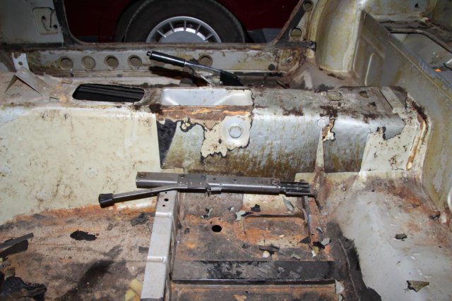

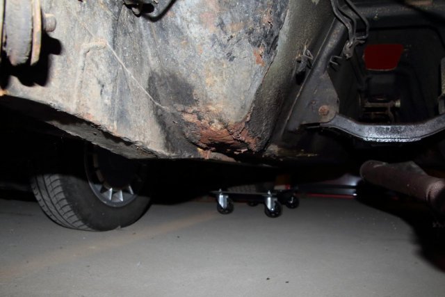

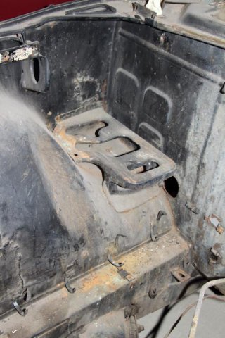

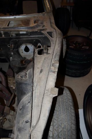

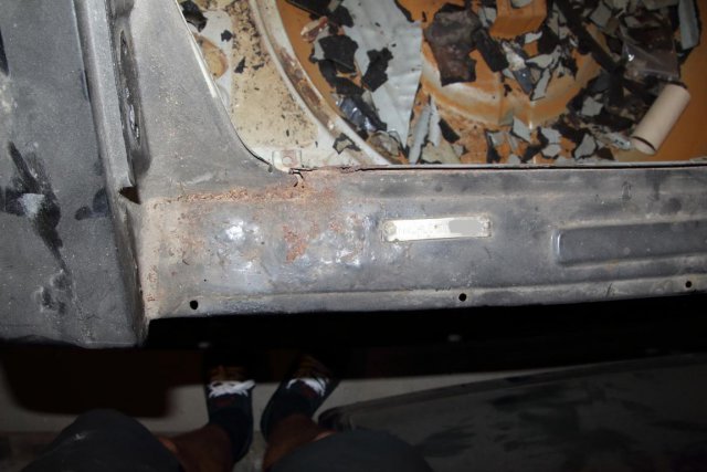

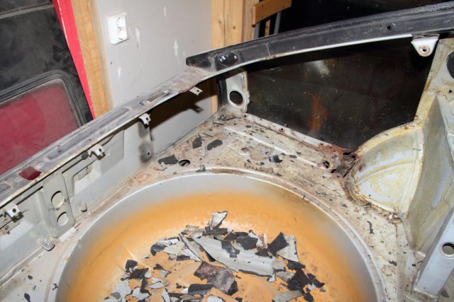

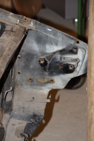

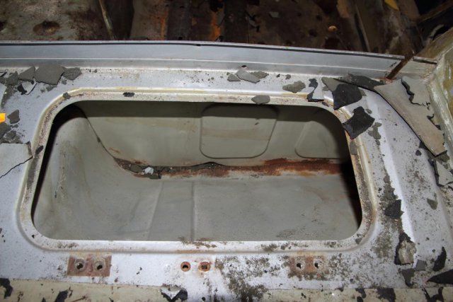

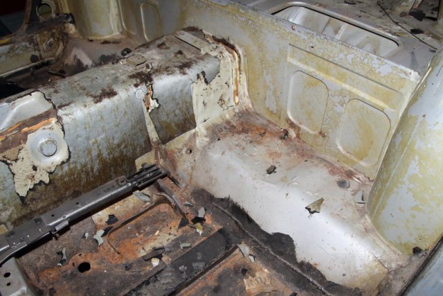

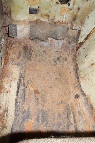

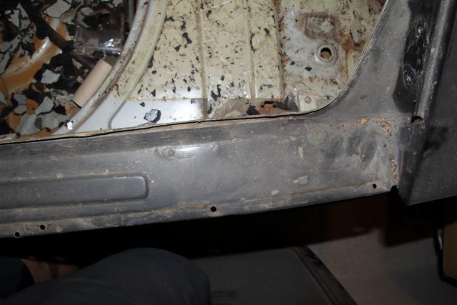

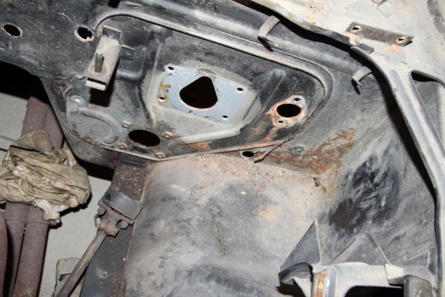

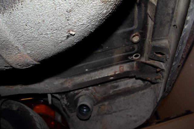

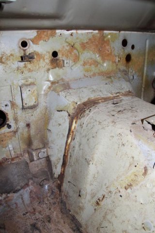

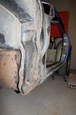

I have tried to document the body and chassis status as much as possible during the teardown. Unfortunately I don't have access to the car lift yet as we are still setting it up so pictures of the underside might not be as good as I would have hoped (hopefully still visible). As this is my first restoration I'm not familiar with the status of bad rust. I can judge if there is heavy pitting, holes or bad damage obviously, but when it comes to light damage that requires little to no attention I'm more uncertain. However, if you see any damage that definitely requires heavy attention, please let me know. The car will be sand blasted by a professional shop later on and I guess some areas might not be visible until that is finalized.
Apologize for lots of pics! Better too many than too few  :D
Attached File  IMG_1188.JPG   86.01KB   0 downloads  Attached File  IMG_1189.JPG   80.6KB   0 downloads - Status beginning of 2016

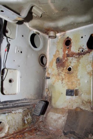

Attached File  IMG_2373.JPG   65.95KB   0 downloads - Battery tray area.

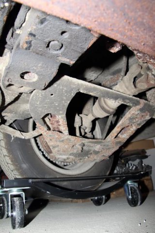

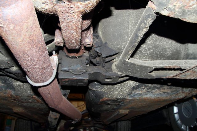

Attached File  IMG_2374.JPG   46.95KB   0 downloads - Rail below front fender (passenger side is in same condition).
Attached File  IMG_2376.JPG   147.18KB   0 downloads - Area around brake booster / cylinder and clutch master cylinder.
Attached File  IMG_2377.JPG   112.55KB   0 downloads  Attached File  IMG_2378.JPG   45.64KB   0 downloads - Mounting areas for hood brackets

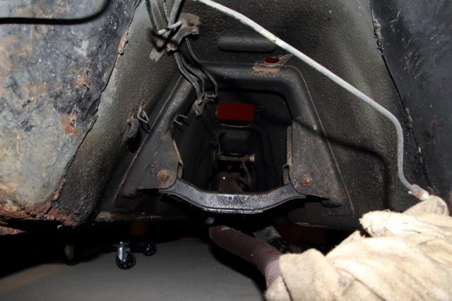

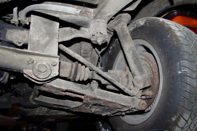

Attached File  IMG_2380.JPG   118.99KB   0 downloads - Frame rails and steering rack
Attached File  IMG_2382.JPG   43.68KB   0 downloads - Driver front suspension area
Attached File  IMG_2399.JPG   119.76KB   0 downloads  Attached File  IMG_2400.JPG   94.44KB   0 downloads - Transmission tunnel area
Attached File  IMG_2401.JPG   55.24KB   0 downloads  Attached File  IMG_2402.JPG   48.38KB   0 downloads - Frame rails plus jack lifting damage. Think a new piece has to be welded in here..
Attached File  IMG_2403.JPG   122.76KB   0 downloads  Attached File  IMG_2414.JPG   43.08KB   0 downloads - Floor pan area from below
Attached File  IMG_2404.JPG   54.71KB   0 downloads  Attached File  IMG_2409.JPG   65.7KB   0 downloads - Rear suspension area
Attached File  IMG_2422.JPG   57.65KB   0 downloads  Attached File  IMG_2423.JPG   127.61KB   0 downloads - Silencer (muffler) and spare wheel well. Think the exhaust system is a non-stainless steel aftermarket (or homemade) system which started to rust early on.

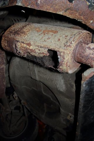

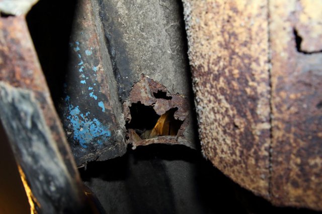

Attached File  IMG_2424.JPG   104.95KB   0 downloads - Rust damage next to silencer (muffler). This is next to the strut tower on the driver side and will require new panels to be made. Not sure if this is caused by the high mounting of the silencer? Can the heat have damaged the under-seal and allowed the rust to get a hold?
Attached File  IMG_2426.JPG   174.14KB   0 downloads  Attached File  IMG_2428.JPG   146.35KB   0 downloads  Attached File  IMG_2429.JPG   146.02KB   0 downloads - Suspension, differential and parts of the spare wheel well

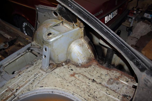

Attached File  IMG_2427.JPG   116.01KB   0 downloads - Area above fuel tank
Attached File  IMG_2434.JPG   52.25KB   0 downloads - Splash shield in driver side front fender area
Attached File  IMG_2384.JPG   58.43KB   0 downloads  Attached File  IMG_2385.JPG   60.29KB   0 downloads  Attached File  IMG_2386.JPG   69.88KB   0 downloads  Attached File  IMG_2396.JPG   64.12KB   0 downloads  Attached File  IMG_2397.JPG   143.68KB   0 downloads Attached File  IMG_2398.JPG   136.26KB   0 downloads  Attached File  IMG_2415.JPG   128.31KB   0 downloads  Attached File  IMG_2416.JPG   125.96KB   0 downloads  Attached File  IMG_2417.JPG   101.25KB   0 downloads  Attached File  IMG_2419.JPG   97.58KB   0 downloads Attached File  IMG_2420.JPG   131.62KB   0 downloads  Attached File  IMG_2421.JPG   124.86KB   0 downloads  Attached File  IMG_2430.JPG   121.31KB   1 downloads  Attached File  IMG_2431.JPG   91.5KB   0 downloads - Status of panels from the interior side. Driver side seat bracket is welded in rather than bolted..
/Erik

Och.....har du haft tid att kolla bakljusen ; )

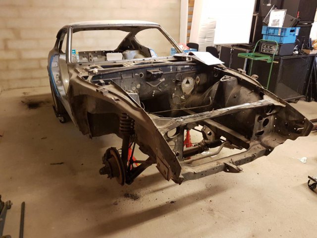

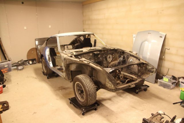

Long time since my last update... glad to say that progress has not been completely stagnant. :P
The latest status was approximately
Attached File  IMG_1235.JPG   87.44KB   0 downloads

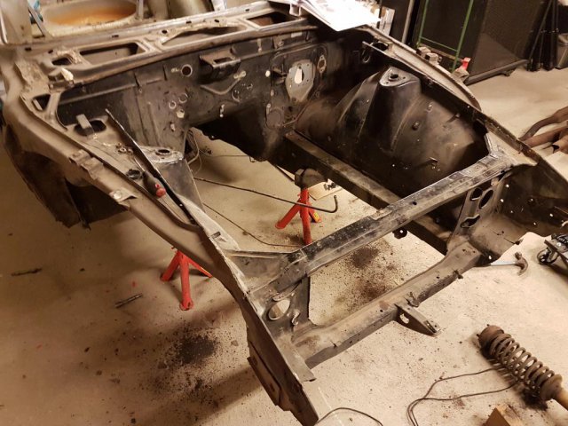

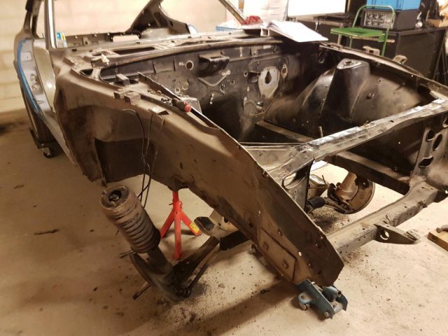

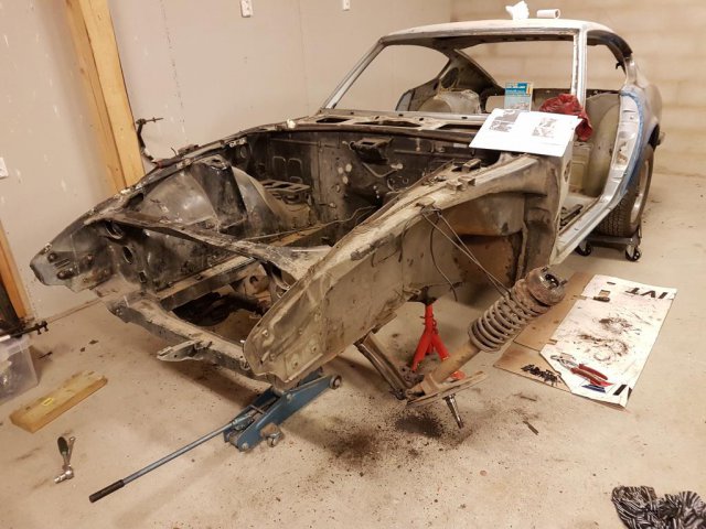

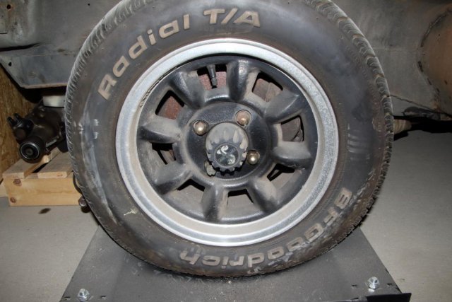

I decided the next step was to remove the all components underneath the car to make it more accessible for sand blasting. I started by supporting the front of the car on jack stands and removing the front wheels.
Attached File  20161014_114152.JPG   100.33KB   0 downloads

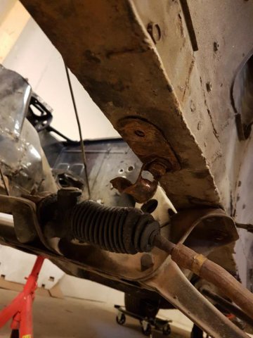

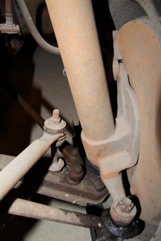

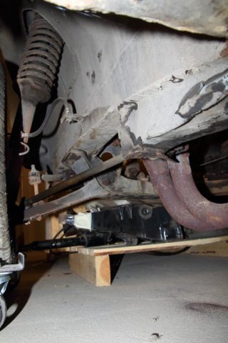

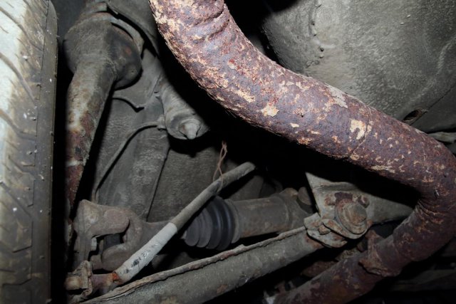

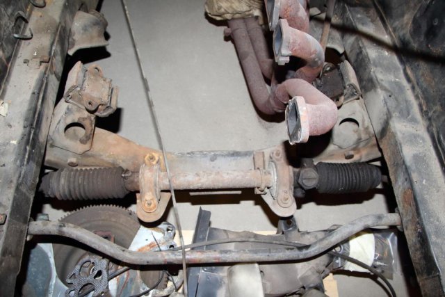

Once on jack stands I could access the front suspension and steering rack components. While removing the stabilizer bar one of the bolts started turning inside the frame rail box. I cannot inspect it in detail but I believe the plate containing the threads inside the box has come loose and spins while trying to undo the bolt. After further inspection the box is flaky in front of the steering mounting location on both sides (bottom piece, inside and top of the box is still solid, but rust has attacked the sides towards the wheel well). I intend to have the box opened and the rusted out areas replaced as well as refix a new plate for the stabilizer bar.
Attached File  20161014_121437.JPG   55.32KB   0 downloads
Removal of the steering rack and suspension components was accomplished in one go. Since I was alone and didn't fancy hanging the suspension solely supported in the steering rack I tied some lines to the top of the shock towers. This way I could remove the large moment force while at the same time lower the complete package without additional manpower.
Attached File  20161014_174821.JPG   121.74KB   0 downloadsAttached File  20161014_174921.JPG   108.11KB   0 downloads
Front suspension and steering rack off the car.
Attached File  20161014_175858.JPG   131.79KB   0 downloads

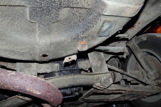

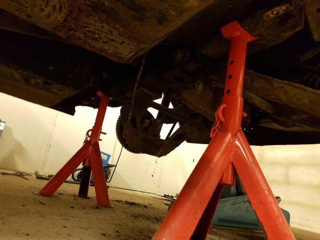

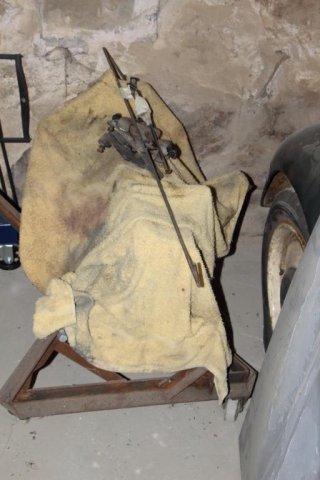

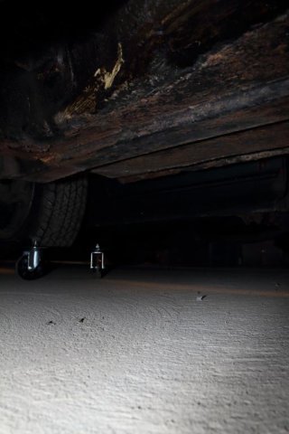

Next step was to remove the rear axel, differential and suspenion components. Before I started I noted that the car was now extremely light in the front end and relatively heavy in the rear resulting the front jack stands loosing contact with the frame rails. Luckily I noticed this before I actually mounted the jack stands in the rear and solved it by placing some heavy components in the passenger and driver foot wells.
Attached File  20161016_145544.JPG   91.68KB   0 downloads

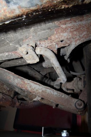

Location of the rear jack stands. Being a 73 I had to first remove the rear stabilizer bar to position them properly.
Attached File  20161016_145637.JPG   76.5KB   0 downloads
Final look after removal of all components.

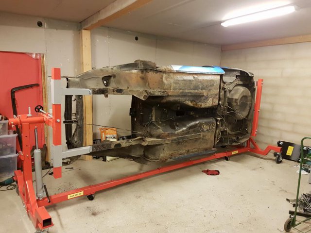

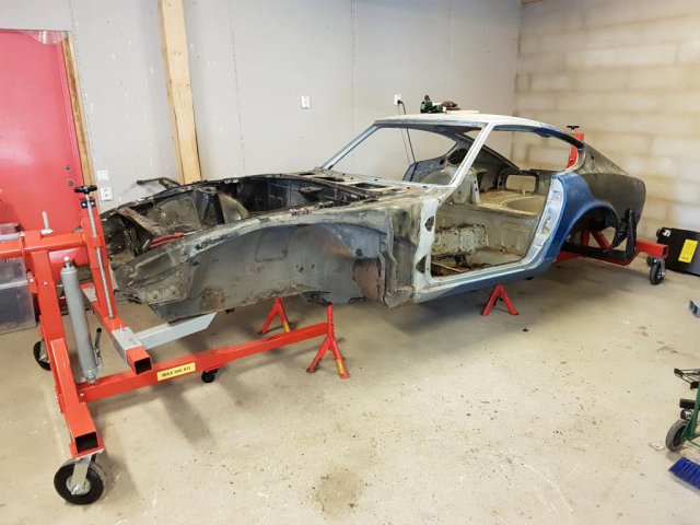

I had now removed everything which was practical based on the access. So now I had to assemble some more new tools! I bought myself a rotisserie which after assembly looked like this
Attached File  20161019_162908.JPG   133.4KB   0 downloads
Ready to attach the car.
Attached File  20161020_120649.JPG   104.31KB   0 downloads
Car lifted.
Attached File  20161021_123114.JPG   94.64KB   0 downloads

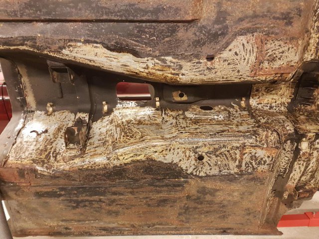

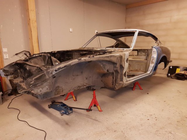

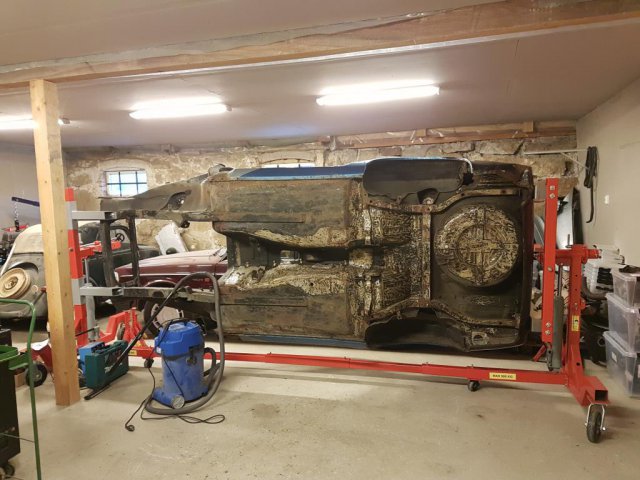

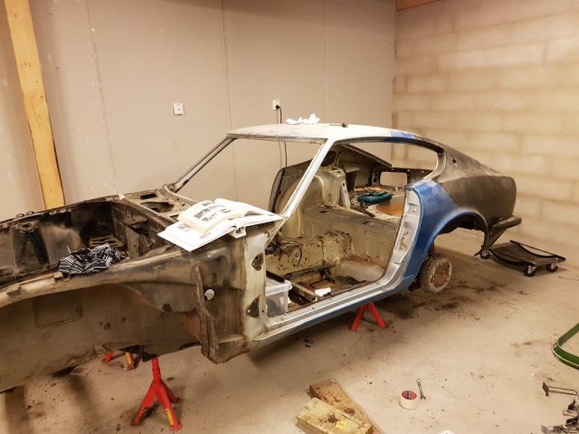

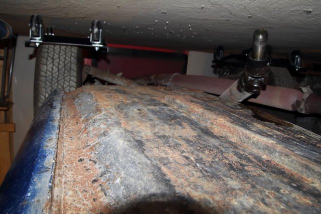

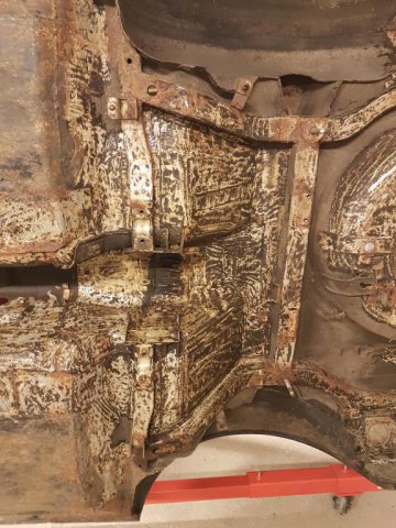

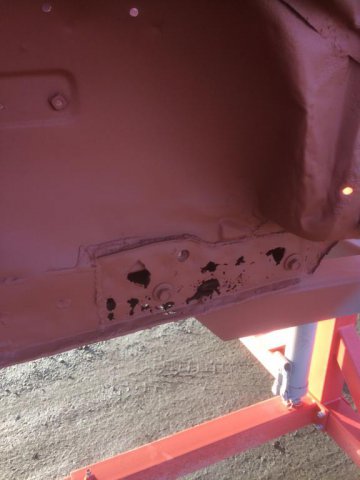

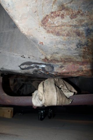

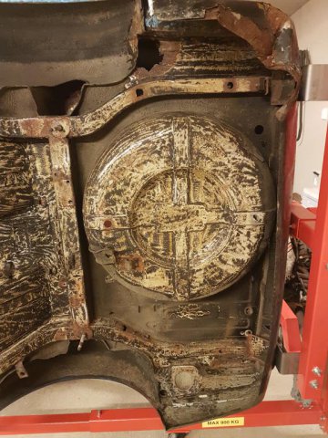

With the car on the side I started to remove the under seal to reveal any rust and prep the car for sand blasting. The guy doing the sand blasting for me prefers to have the underseal removed because the sand tends to bounce and generate heat. I did unforunately not have the time to remove all of the underseal, but the contracted company will take the rest. Noted after removing the underseal was that the rust in the spare tire well was worse than expected and had rusted through in a few spots. Similarly the
Attached File  20161022_154759.JPG   115.62KB   0 downloadsAttached File  20161022_154808.JPG   186.67KB   0 downloadsAttached File  20161022_154815.JPG   106.57KB   0 downloadsAttached File  20161022_154820.JPG   103.11KB   0 downloads

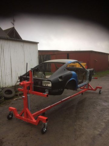

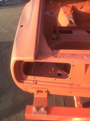

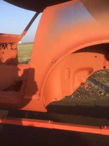

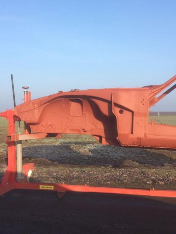

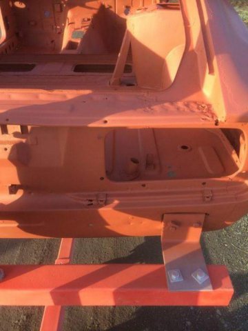

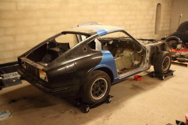

Beginning of December the car was delivered to the sand blaster.
Attached File  IMG-20161213-WA0012.jpg   41.69KB   0 downloads
Now I'm just ilding until the car can go to the body repair shop, however doing that you can accomplish other tasks, e.g. such as taking deliveries and repairing broken stuff. :lol:

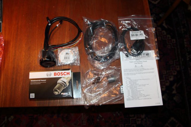

To properly tune and monitor the operating conditions of the carbs I bought AFR and data logger kits from the UK. I didn't want to mount the AFR gauge in a very visible place to avoid any temptation for thiefs. I decided in the end to mount the gauge in the sidewall of the glove box where it should be visible from the driver position. To avoid having to look at it constantly the logger will log any data during normal driving. To complete the trend I will later also log RPM so that I can see in which range the AFR goes out of range to allow fine tuning.
Attached File  IMG_3011.JPG   77.05KB   0 downloadsAttached File  IMG_3012.JPG   93.25KB   0 downloadsAttached File  20161011_110812.JPG   68.56KB   0 downloadsAttached File  IMG_3054.JPG   50.8KB   0 downloads
While also installing the logging equipment I swapped out any worn contacts and broken lamps. From the US one can source a nice kit of new 70's style contacts and crimping kit which will fit perfectly together with the original Datsun 240z electric system. This way one can keep the original look and refresh the electrics if required. Wiring with the correct coloring code and gauge was found in the UK to allow correct replacement of damaged wires. While at it I installed a new fuse box as well as a relay kit for the hazard lights. Full beam relay kit as well as marker flasher kit were also installed on the engine harness.

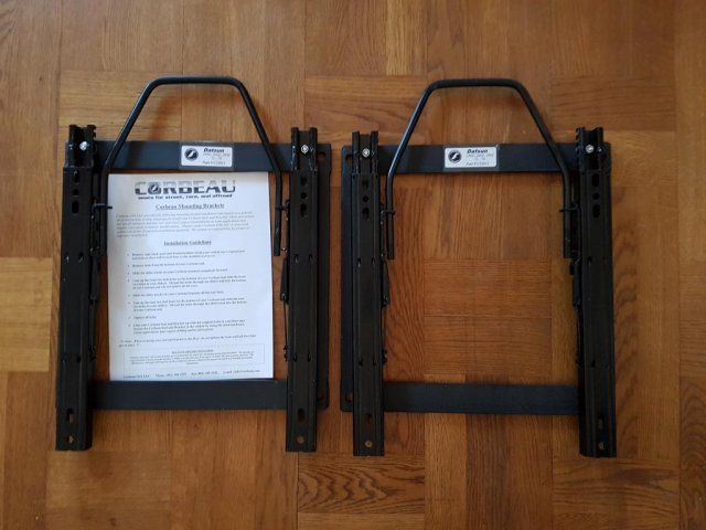

The seat brackets that came with the car were quite badly worn and partly broken. Since I really hate bad sliding mechanisms I decided to try the Corbeau custom brackets. They have had mixed reviews, but I decided to try them anyway. Time will tell if it was a good idea.
Attached File  20161223_100155.jpg   85.1KB   0 downloads
The wiper motor was quite tired. Reading online I have seen multiple thread regarding replacing it with a honda motor which is significantly stronger. A bit of rewiring is required, but since I already aquired original coloring wires from the UK I could easily fabricate a small harness extension which allows mounting of the additonal relay that is required to make the wipers park properly.
Attached File  20161223_184608.JPG   71.55KB   0 downloads

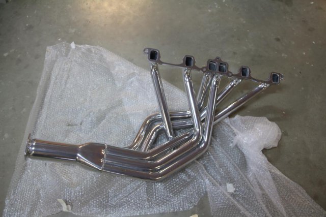

The original header was quite rusty, but to my knowledge still usable. Plan is to blast it and save it for use with the original L24 engine at a later stage. The new L28 will get a Zstore 6to1 header with 3 inch exhaust.
Attached File  IMG_3023.JPG   106.37KB   0 downloads

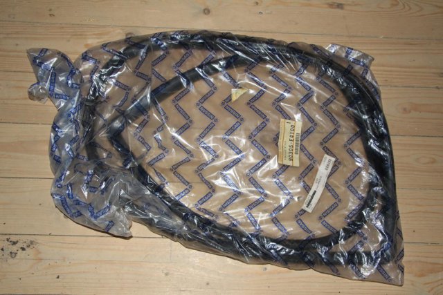

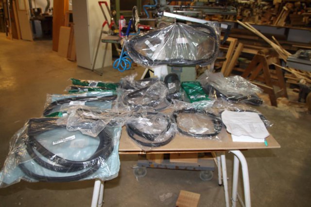

Most of the weather stripping was quite badly worn or dried out. I decided it was a good idea to replace them all to avoid any leakage into the new car. I also got a bit of weather stripping from the previous owner, so at a later stage I will decide which components to use.
Attached File  IMG_3027.JPG   110.21KB   0 downloads

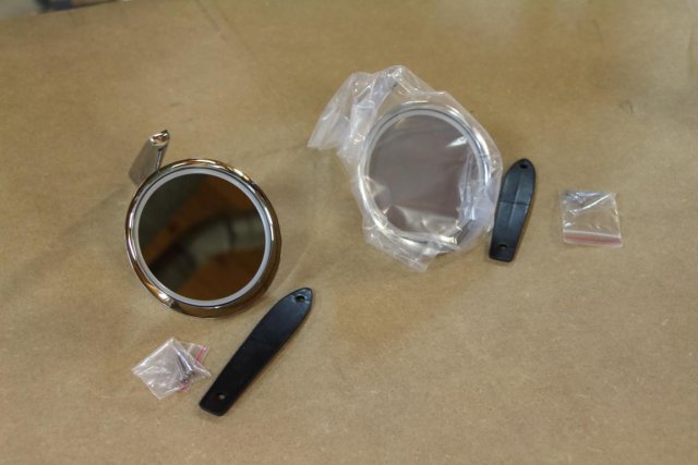

The car only had one driver side mirror mounted which looked like it was from a 90's Audi. That had to go and I bought both driver and passenger side mirrors. I was playing with the thought of having fender mirrors but decided to stick with door mirrors.
Attached File  IMG_3021.JPG   73.45KB   0 downloads
Bolt sets, new engine, transmission and differential mountings, side markers and window winders (mounted was a very cheap type of aftermarket electric winders).
Attached File  IMG_3015.JPG   111.57KB   0 downloads
New suspension and drivetrain components, protective rubber parts as well as miscellanous engine and body components.
Attached File  20161223_111423.JPG   74.56KB   0 downloads
My intention was to break the engine and replace all the seals, bearings etc... however after a call with the previous owner I found out the engine is very fresh. Originally it was bought with low milage on it and directly broken down for full refurbishing and tuning. New bearings, seals, pistons, auxiliaries etc were installed and the engine broken in (approximately 20000 km of driving). Since then it was stored in a warm garage. I will break the engine and swap some of the gaskets, but I will not touch bearings or rings. The second sealing kit I intend to use to refurbish the original L24 engine.
Attached File  IMG_3028.JPG   106.6KB   0 downloads

Minor update;
The car body and frame is finish at the sand blaster. Since I'm not personally picking up the car I only have 3 pictures to show for at the moment. I have to trust my dear dad about the actual condition until he manages to fully document everything. Some small surprises were revealed so you never know what you'll find once all the dirt, paint and rust comes off. Better get it all off so that a proper repair job can be done before starting to put it together again.
Attached File  IMG-20170127-WA0006.jpg   42.36KB   0 downloads
Attached File  IMG-20170127-WA0007.jpg   46.84KB   0 downloads
Attached File  IMG-20170127-WA0008.jpg   43.59KB   0 downloads
Attached File  received_1569210093108598.jpeg   47.24KB   0 downloads
Attached File  received_1569210276441913.jpeg   40.09KB   0 downloads
I'll post some more photos as they drop in.
On the basis of what can be seen in the photos, are these the normal problem areas?
/Erik
Edited by Tebirkesueth, 31 January 2017 - 01:59 PM.
#19 Nicapizza
Nicapizza
    Newbie
  • Members
  • Pip
  • 8 posts
  • LocationEuclid, OH
Posted 31 January 2017 - 02:02 PM
Seem to be pretty common spots. Id replace those front frame rails from front to back, as I wouldn't trust them one bit
#20 grannyknot
grannyknot
    Always Here
  • Members
  • PipPipPipPip
  • 199 posts
  • LocationOntario
Posted 31 January 2017 - 03:15 PM
Yeah, all the usual places, as mentioned, that pic of the P/S front rail looks like a patch has been welded on and it has rusted through as well. Once you start peeling back that Swiss cheese sheet metal I think you are going to find a lot of rust the sand blaster couldn't get to, prepare yourself :rolleyes:
How are the floor pans?
