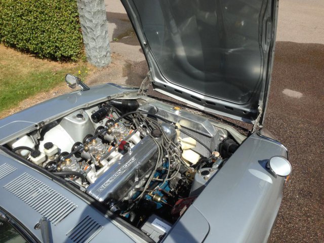

200 crank hp will not be a problem to reach.
I have just dynoed my new engine and its not perfectly tuned.
It made 180 whp, dont know what crank hp that is but i guess around 220.
N42 +1mm block with flattops and a E88 head with no port job.
Tripple 45
Msa stage 3 cam
#6 turbogrill
turbogrill
    Always Here
  • Members
  • PipPipPipPip
  • 118 posts
  • LocationAustin, TX
Posted 13 September 2016 - 05:06 PM
Tripple 45
Msa stage 3 cam

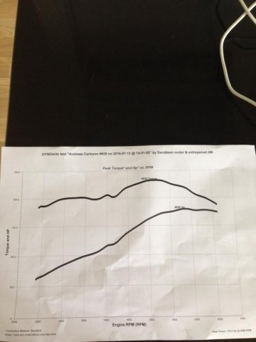

Nice build. Care to share the curve? Curious to she how the power is delivered.
#7 Andreas
Andreas
    Regular
  • Members
  • PipPipPip
  • 72 posts
  • LocationSweden
Posted 13 September 2016 - 05:23 PM
Here you go: Attached File  image.jpeg   158.74KB   0 downloadsAttached File  image.jpeg   157.17KB   0 downloads
