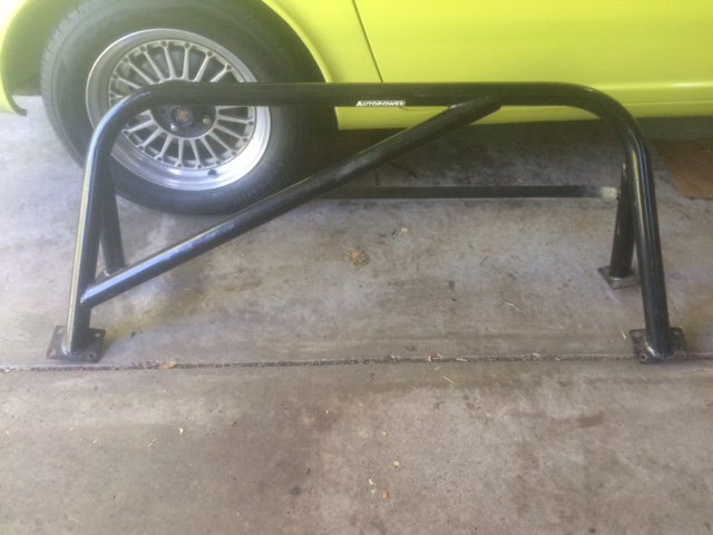

Hmm , Not saying your wrong but when the roll bar is mounted in the car that flat bar you're saying is for seat support is pretty far away from the seat to support it . Or am I missing something ?
Don"t believe that is the harness mount. More of a seat support.
Mine has the horizontal bar the same size tubing as the rest of the roll bar.

On my current rollbar, the horizontal bar does two things: seat support and harness attachment, so it is often referred to as a "harness bar." I have a bolt on piece that extends from the harness bar to the back of my seat; this really makes my seatback solid. My rollbar passes tech for NHRA and ECTA. I also built it with features that should make it pass SCCA tech, although I'm too slow at autocross for anybody to really care.
That piece on your rollbar is too light to conform to any rule book I'm familiar with. It looks to light to be in compliance as a harness bar, seat brace or head restraint. I think it is just the result of a creative imagination. And I'm cool with that.

Used to have one of these Autopower roll bars. I thought it was supposed to be a harness bar, and I thought it was too small to use as a harness bar, so I added another tube between the backstays at about the same height to attach the harnesses to. If you can't weld, you can pretty easily buy a piece of DOM tubing, use a coping calculator like this one: http://metalgeek.com/static/cope.pcgi
Easy to grind the tube with that calculator then you can have a muffler shop weld it in for you.

I'm guessing when you thought it was supposed to be a harness bar you used it as a harness bar for sometime ?
I will have another tube welded for the harness
Harness bar, period, end of sentence. A left-over from an earlier era. They were sold in two versions, one for street and one for SCCA track use. The street version was just two hoops while the track version had an angled brace and the aforementioned harness bar, which was in reality a loop that could accommodate the seat being installed back into the bend, flat and hoop so one could attach their harness.
Neither was a cage but rather just a roll bar, albeit one was stronger than the other.
