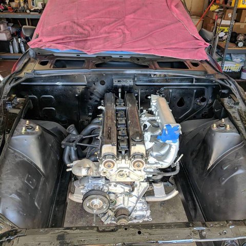

Kinda forgot about this thread. I picked apart my blue Z and salvaged everything I could. Combined I'll have a single rust free chassis.
The plan was finish engine first, get rid of all the left over parts for more garage space, then work on getting the engine in the car, then finish restoring the rest of the car. However, first I needed space.
Here's the growing pile of parts for the motor. I wound up selling my 9174EFR to a guy who needed one right away for his racecar. I replaced it with a S364.5SXE since this is a street car. If I do any sort of revisit into EFR turbos I'll probably go small twins.
Manifold and turbo fit, barely. I still need to cut the 4 bolt flange for the wastegate off and weld on a vband. Ironically, it seems that if one were to try this in the future, go with a 60mm wastegate. Turns out the wastegate flange, while designed for Greddy's 47mm wastegate is fed by an almost 60mm tube. Of course, I'm using a 50mm Turbosmart pro-lite wastegate, so more work is going to be required.
Got the bottom end back from the machine shop. Painted it, and installed the Greddy thermostatic oil cooler. With a laser temperature probe and my propane heater I was able to 'bake' the paint on.
Rods were shot peened and resized/balanced for ARP bolts and the fitted to the new wrist pins. Ended up going with 10.6:1 wiseco 86.5mm pistons. With the 2JZ head I'll loose about a point and some change of compression. With my 1.2mm Tomei head gasket I should be somewhere around 9.6:1 SCR. One catch with the pistons was having to bend all the oil squirters to get them to fit.
Also sold the CD008 and picked up a TR6060 from a Ford XR6. The rear end I've got would have made the first two gears in the CD008 useless. Not wanting a 4 speed I got something a bit better suited. The XR6 uses some of the shortest gears offered in a TR6060 as well, which will be nice, while still having a long 6th for highways. The other nice thing is shifter placement is almost factory.
Bell housing adapter.
The only thing I've done to my VVTI head was clean it and install better valve springs and Ti retainers. Downside to that is the factory valve lengths aren't uniform. So when I checked fitment with my Kelford V202-D cams, I would need to order 13 new shims to achieve the .010" lash required. Screw that. Shims were about $7 each, and I found a Toyota dealer in the Middle East with shimless buckets for $7.70 a piece. Shimless buckets arrived 4 days after ordering.
Ran into my first modification required hurdle with the 2JZ head 1JZ block combo. The cam gear backplate cover doesn't fit. The lower tabs on each side have to be cut off to clear the oil & water pumps.
After some cutting and a few hours of test fits and checking timing I had the lower cover in place and everything was on. Also for anyone wondering, the water neck needs to use the water pipe for the block it's going on. In my case the 1JZ water neck worked perfectly.
Another thing that worked perfectly were the front engine covers. The 1JZ bottom cover and 2JZ upper cover fit perfectly.
