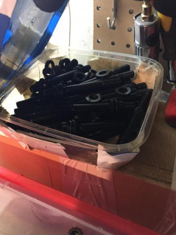

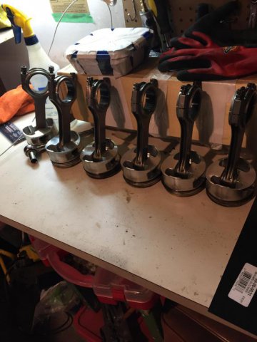

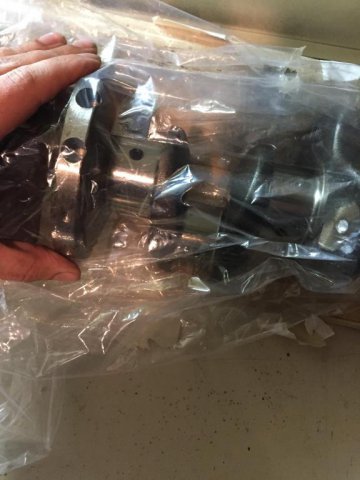

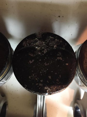

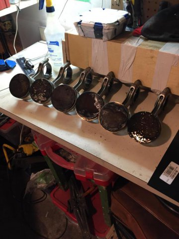

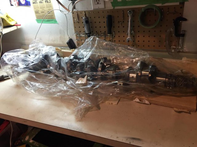

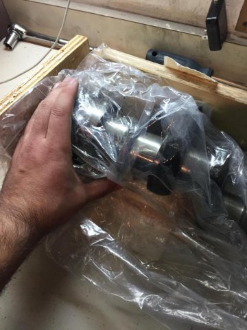

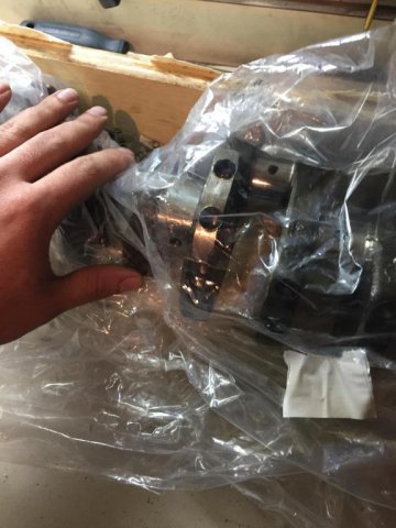

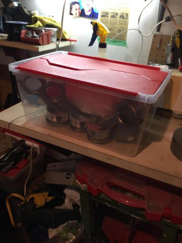

I was finally able to dive into the stroker kit!  Gerry (30ounce) packaged everything very well and everything arrived in great shape and looks exactly as advertised.  Next up is to clean up the carbon deposits off the pistons and remove the rod from the damaged piston.  The crank looks fantastic, though I don't have anywhere to put it for now so I put the box back together and put it away for now.
The pistons and rods
Attached File  02 - mY51fwG.jpg   55.74KB   0 downloads
Attached File  03 - l4QkcMI.jpg   59.45KB   0 downloads
The damaged piston
Attached File  04 - jomBSrw.jpg   40.92KB   0 downloads
Bearings and ARP Studs

Threw it all in a container to keep the dust off of it until I have some time to work on it
Attached File  07 - ZqNDCJF.jpg   50.9KB   0 downloads
And last but not least, the crank!
Attached File  08 - PEvUhZL.jpg   97.48KB   2 downloads
Attached File  10 - vso7skj.jpg   59.53KB   0 downloads
Attached File  11 - Zz57F3F.jpg   52.23KB   0 downloads
Attached File  12 - Ue0qllH.jpg   63.57KB   0 downloads
