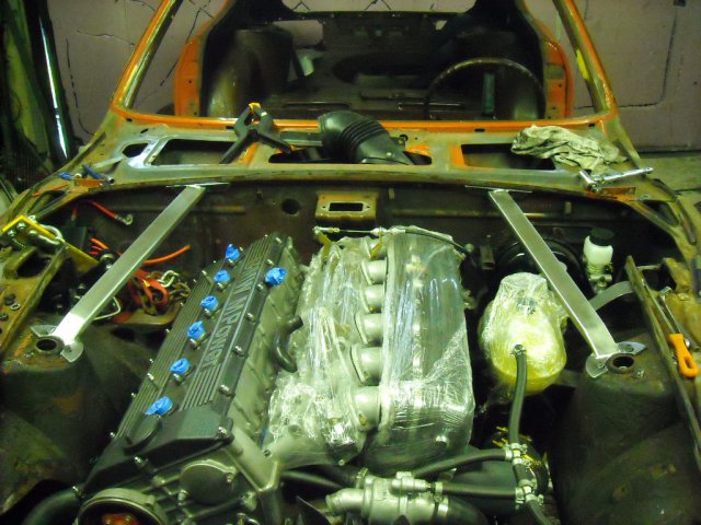

Attached File  DSCN0803.JPG   231.5KB   2 downloadsAttached File  DSCN0861.JPG   223.85KB   1 downloadsAttached File  DSCN0859.JPG   231.12KB   2 downloads

I agree so I hope I have addressed that with theses braces,
I think that should do the trick!

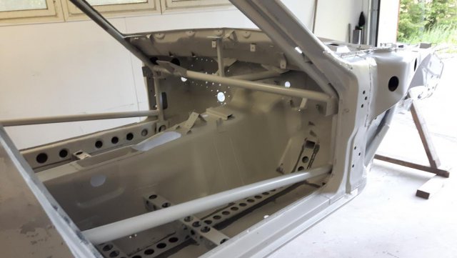

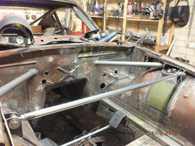

I`m afraid, those does´t help with firewall flexing.  Here is my solution, didn´t think firewall when did this but maybe helps a bit with it.
Not for firewall flex. For strut tower movement. Anything attached to the strut tower (such as a device to arrest master cylinder movement) will also move.

Those pipes from strut towers goes through firewall and are attached to roll cage.
