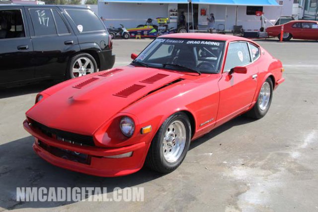

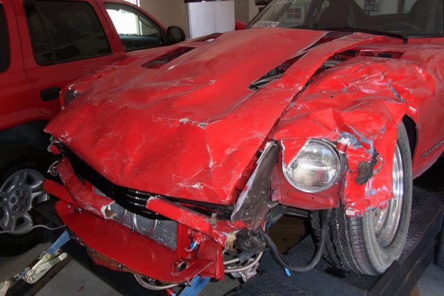

As some of you know, in 2014, at the NMCA-West True Street race at the Pomona strip, the Z's brakes failed after crossing the finish line at 160 mph. I was not injured but the same could not be said about the Z.
Since I did not have the funds to rebuild the car the plan was to part out what was undamaged. However, my friend Mack, owner of Mckinney Motorsports a Datsun performance and repair shop, informed me that he would rebuild the Z. He also assured me that there would be no charge for all the required welding and fabrication.....Well OK....Let the 'Resurrection' begin!
Here are 2 pics of the Z before the crash.
Attached File  01.jpg   68.48KB   1 downloads
Attached File  02.jpg   80.55KB   4 downloads

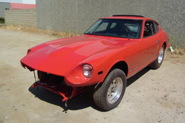

Pics of the damage.
Attached File  03.JPG   113.65KB   1 downloads
Attached File  04.JPG   54.35KB   1 downloads
Attached File  1.JPG   116.44KB   1 downloads

Probably depends on how much damage there is, how they go about fixing it, and how much custom work it already has done on it. Looks like the damage is forward of the firewall, and the roof skin. Might be "easy" to just reskin the roof, and tube the front end.

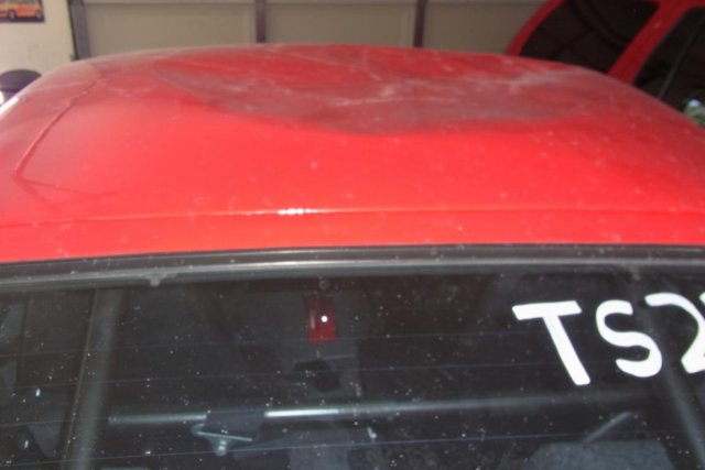

Either way, it'll be good to see this car fixed and on the road again.
You are correct....and the roof did not need to be re-skinned. After I removed the seats, Mack got on his back on the floor and used his boots to pop out most of the dent. I don't know if that's a good sign of strength or a bad one?????

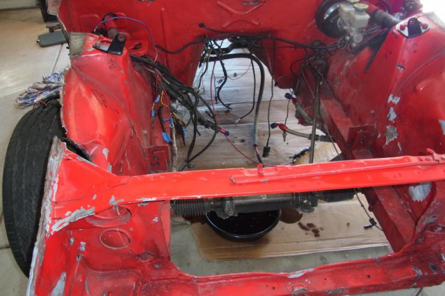

The bad has been removed....the good remains. Dummy engine is in to allow fabrication around it.
Attached File  2.JPG   113.14KB   0 downloads

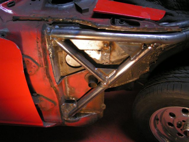

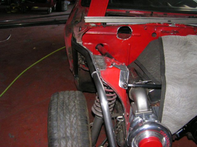

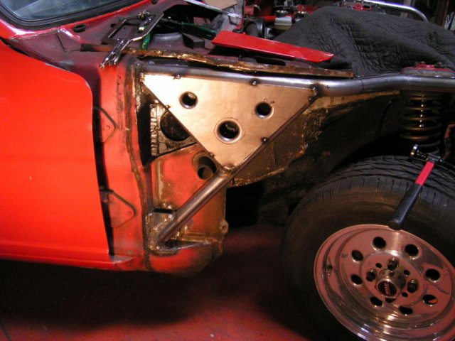

Heavy duty tubing is welded in to strengthen and replace cut-off front end.
Attached File  3.JPG   93.46KB   0 downloads
Attached File  4.JPG   88.73KB   0 downloads

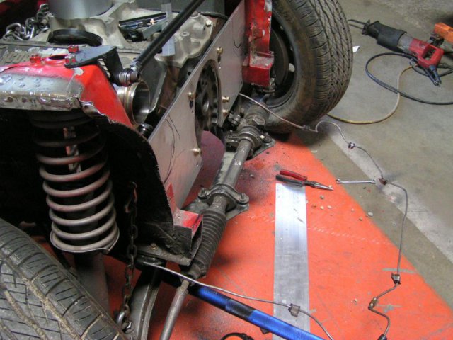

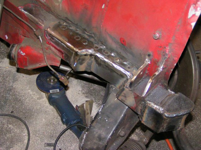

Frame rail was notched and boxed in to provide clearance for turbo down-pipe.
Attached File  6.JPG   118.19KB   0 downloads

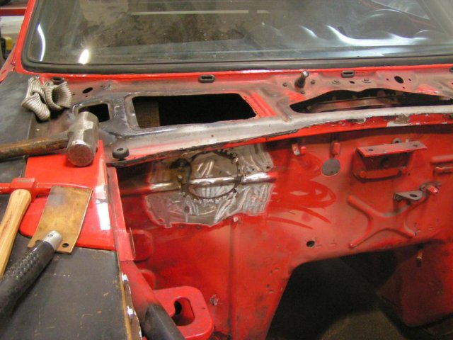

Air to water inter-cooler pipe opening in firewall was plugged since inter-cooler would no longer be in passenger compartment.
Attached File  7.JPG   97.9KB   0 downloads

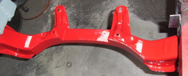

Stock 240 z cross-member was modified and reinforced to provide easier oil pan removal with Chevy engine still in car.
Attached File  8.JPG   78.72KB   0 downloads

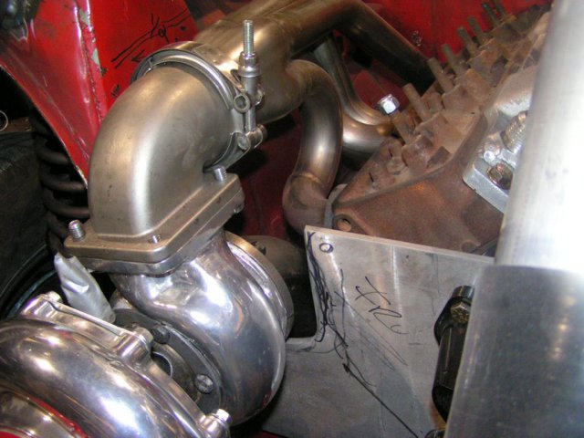

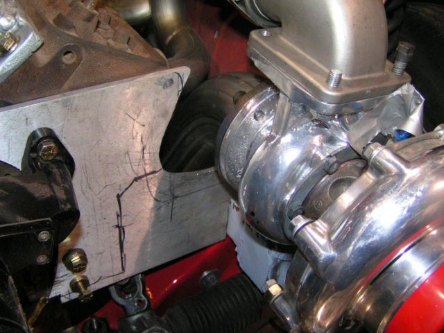

Mack provided the CX Racing stainless steel turbo headers and all the hot-side components. But the header collectors had to be shortened to properly line up with the desired turbo and intercooler location.
Attached File  9.JPG   100.86KB   0 downloads
Attached File  10.JPG   109.58KB   0 downloads

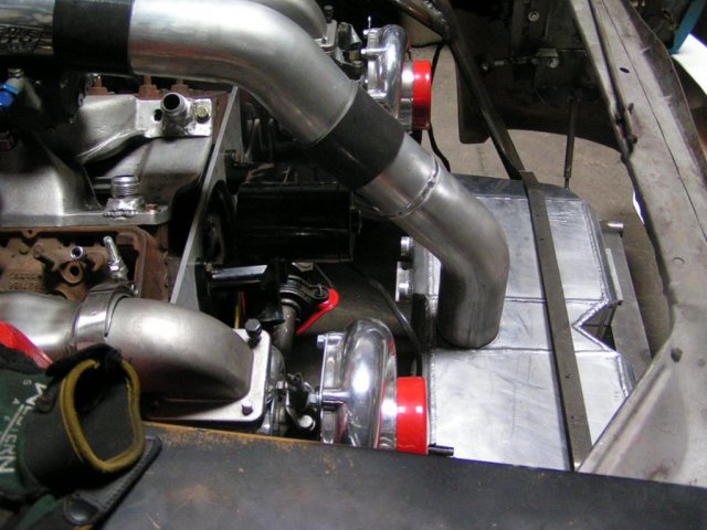

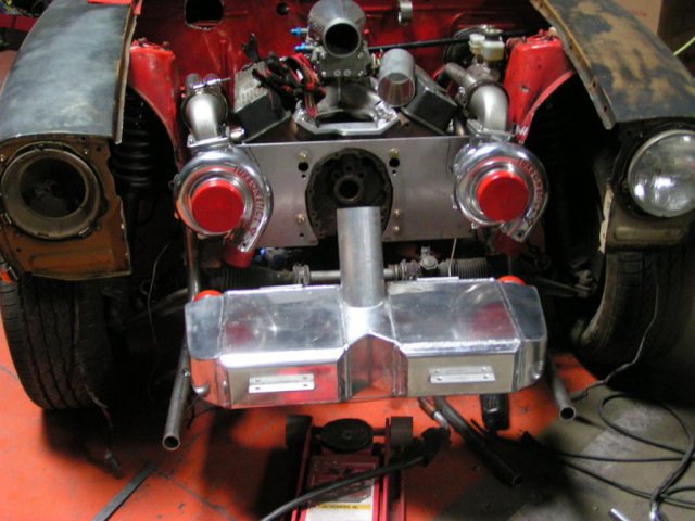

Here is the CXRacing twin turbo air-to-water intercooler.
Both the inlets and the outlets had to be modified for the intended application.
Attached File  11.JPG   69.79KB   0 downloads

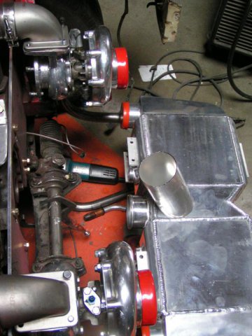

This pic shows how the intercooler will be positioned in relation to the turbos and engine.
You can see the fenders are used but they are rust-free.
Attached File  12.JPG   98.25KB   0 downloads
Preliminary placement of cold-side 3 1/2" intercooler outlet to carb.
There is sufficient clearance between the carb inlet tube and Meziere electric water pump.
This pic also shows the Edelbrock Victor Jr intake manifold that I modified by removing the thermostat housing.
Mack, then welded 16 AN male fittings to it for coolant hoses to the radiator.
Attached File  13.JPG   101.31KB   0 downloads

Turbonetics 72 mm compressors with "Q" trim .81 A/R turbines. I sanded and polished the turbines and then had them ceramic-coated. Thanks for the comment.

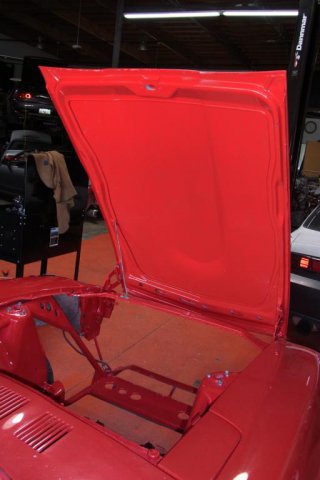

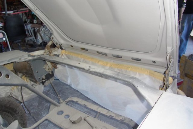

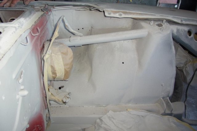

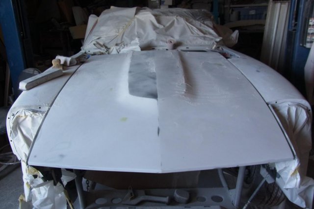

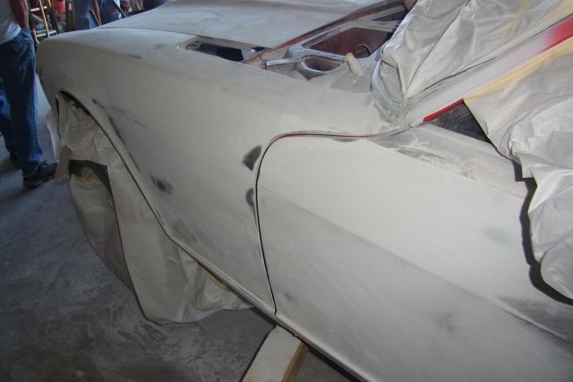

These pics show the Z in primer at Tom's, a one-man paint and body shop, recommended by Mack.Tom agreed to do the bodywork and paint for a reasonable price, so long as he could squeeze the Z in-between other paint jobs.
Attached File  14.JPG   83.46KB   0 downloads
Attached File  15.JPG   73.57KB   0 downloads
Attached File  16.JPG   69.29KB   0 downloads
Attached File  17.JPG   72.26KB   0 downloads
