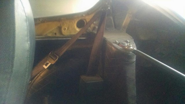

I bought a universal set of retractable belts from Juliano's and bolted the retractable housing just in front of the rear shock tower. I bolted it to a 1/4" thick bar, 1" wide and about 6" long that I placed under the floor, accessed via inside the tool storage boxes. This was to provide an area to spread any force that might occur in the event of a front end collision. Seems to work fine.
Mike Mileski
Mike Mileski
Tucson, AZ
Do you like those belts? Are they reasonably comfortable?

When the belts are on, they just seem like seatbelts in any other car.
