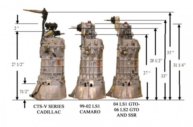

The 98-2002 Camarillo/Firebird is your best bet. The GTO tranny fits equally as well but you need a $30 part (offset lever) to convert the shifter. The GTO trans is stronger and has a lower 1st and second gears (lower than optimal) than the Camaro version. Also, the Camaro version is better supported by repair vendors like Liberty or RSM for modifications like dog rings and face plating. Probably the best new tranny is gonna be a brand new T56 Magnum but the tail housing has to be switched to the Camaro tail housing to put the shifter in proper location, which is something Liberty can do for a fee. You probably don't need 6th gear-a 5 speed is probably adequate. Go to Tremec's site and you can see the different gear ratio options available in the T56 magnum. I'd pick one with the smallest numbers for gears 1 & 2, and the largest gears for 5 & 6 (you don't need a .5 6th ratio for a road course car. I bet gears 3 & 4 are the same for all of them.

I used an 04 GTO as a donor.  I had to redo the shifter and its mounting as stated above, other than that it appears to be fine.  It is in the car and other than a couple of ears being trimmed it fits in a Series 1 240.  I did swap the output yoke when I had the driveshaft made, the GTO used the rubber donut and now it has a regular U joint on both ends.  HTH, Richard.

As Keith stated, stay away from the CTSV unit as they have a CV output rather than a slip yoke, making the connection a bit more difficult.
