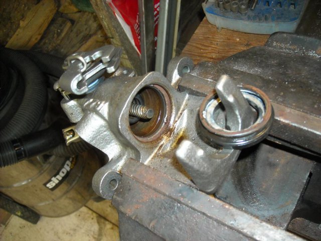

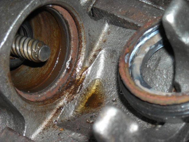

This is the last refurbished caliper I got from Rockauto,  it's always worth dismantling their stuff to find out what you really bought.
Same thing happened to me. I bought rebuilt Cardone 240SX rear calipers from O'Reily's. They were both filled with rust as if they had been submerged in water for a long time.
Edited by Miles
