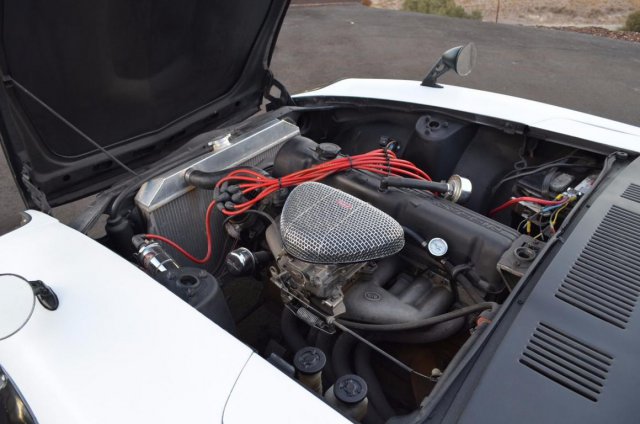

Pics of the car as it currently sits in it's dirty state.
Share this post
