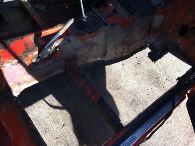

I'm back at it, I have purchased a second 240z because my RB project is taking forever and I am itching to drive a Z again. Here in Michigan it is very difficult to find early s30 with enough metal left to weld on to. Luckily i found a car that was driven here from Texas, parked in a barn (2009) and not really exposed to much of the snow, salt, and moisture. It still is not rust-free, far from it, the floors were patched at some point with fiberglass ( which is lifting off) and the clutch master leaked into the drivers floor and the brake fluid ate away whatever was left. But let's concentrate on the positives

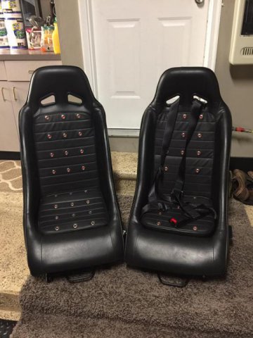

Just a little update, have had a couple of busy weeks at work so not much got done during the month of March. But I did put in a new MSD Blaster 2 Coil to pair with the e12-80 280zx ignition, i finished painting my fuel tank and installed it. I tuned the SUs and checked the timing. My vacuum advance doesn't seem to be functioning. Hope to find just a new vacuum diaphragm but have been unsuccessful up to this point.
I did pull the dash to clean all the air ducts, and leak check the heater core. I do have a spare so that one may go in. I picked up a set of seats from a local datsun enthusiast for a great price(thanks Jose).

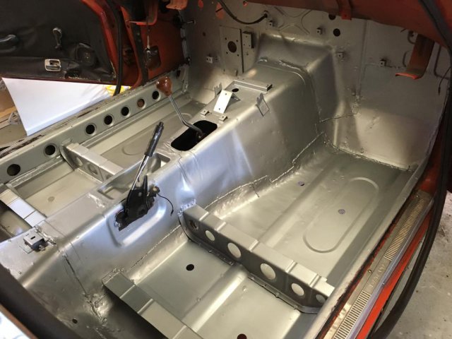

Just a little update, I started working on the floors, which as usual includes replacement of the battery tray and half the firewall... why did I think this time would be any different. grrr

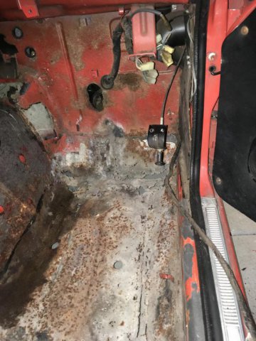

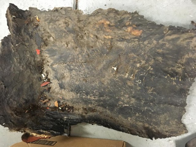

If you are reading this and think about repairing your floors with fiberglass....DON'T!! New metal is the only way. See Exhibit A:
Anyway this is what the passenger floor looked like after the fiberglass removal. Note the dark spot in the upper left. Lots of moisture here. Which i don't understand because the car hasn't seen rain in over 7 years!!!!
if you notice there is also a big hole next to the wire harness hole and i was able to push through the battery tray with my finger. so all that needs to be replaced as well.

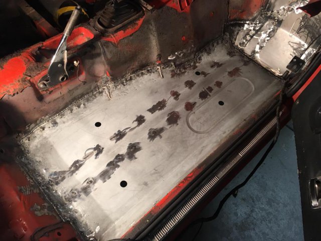

I got to cutting, here is the passenger floor out, still have more trimming to do and have to replace the section of the firewall before the floor can go in.

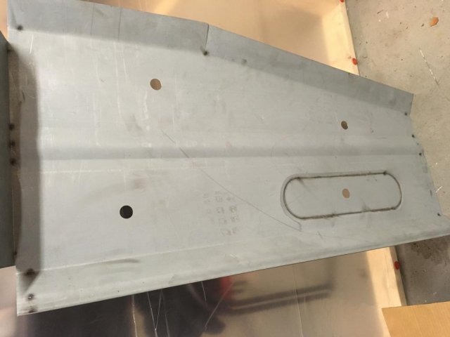

I got some floor pans for Classic2Current Fabrication. They are local to me so i was able to go to their shop to pick up the pans. I'm happy with the quality, just missing the dimple on the outboard sides like you get with zedd findings.
Edited by theczechone
Share this post
A little update, progress has been slow but finally getting somewhere. Due to rust i ended up replacing half of the firewall and the battery tray. new metal is now welded in. Also the new frame rail from John at Bad Dog Parts has been installed along with his rear subframe connectors. The final fitting of the pan on the passenger side should happen tonight and welded in hopefully this weekend. Etching primer and seam sealer after that and it's off to the driver's side!

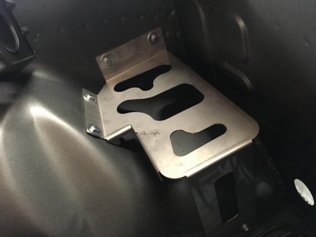

I painted the engine bay and underside. Because I had to repair the battery tray are I needed a new tray or repair the original one.
I opted to try the z car depot's stainless tray. I like the looks of it and I might choose to move the battery to the rear of the car at some point. I think it turned out great.

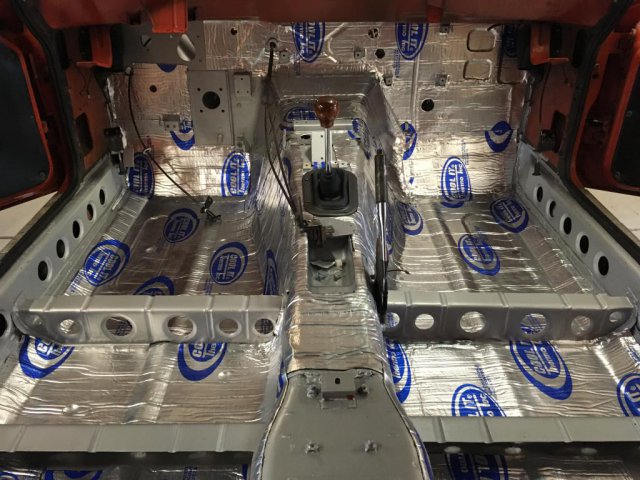

I also installed some sound deadening and heat insulation. I would like this car to be more of a GT car than an all out racer.

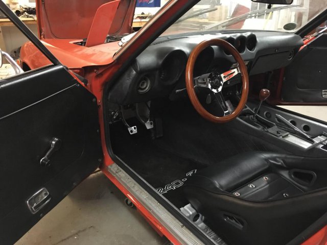

But the interior is coming along well i haven't been taking  pictures at every step but here is a short summary.
- Installed carpet padding on the tunnel (the stuff is called Victoria's Pad .... I wonder if they meant to do that)  apparently it's costco required under carpet insulation got it for $10 at my local flooring store.
- Installed new vinyl kit from MSA, overall good fit but it's a pain to do and also very time consuming
- Installed a refurbed pedal box that i had in my other car
- Swapped all the gauges and wiring from the original dash to another one i had laying around that's in much better shape (forgot to swap the vin plate ... grr of course realized this after dash was installed
- Installed the Dash
- Connected all the wiring, checked each system for operation and checked for any loose wires that may  be hot. I am not running a heater core or a blower motor at this time so i have some dangling wires right now
- I installed the steering column with a Peyton Steering wheel (it's ok for now but i am keeping an eye out for a wood grain nardi in 13-14" diameter
- I installed the center panel and console after thorough cleaning of these parts, they are not in best shape but they will do for now.
- I got all the rear panels installed
- Got my driver's seat mounted and finished off with some embroidered floor mats
As for next steps, finish up the interior work, i still have the passenger seat to mount and the lower interior dogleg panels to install, i am also waiting for my harness bar from T3 and my takata harnesses are ready to go in.
