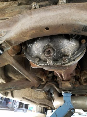

Is there an semi-easy way to check?
Jack the car up by the differential so both rear tires are hanging.  Then spin one of the tires, if they spin opposite directions, it's an open differential, if they won't spin or spin the same direction, then you have some sort of posi or locker.
Jacked the car up over the weekend to start working on a suspension refresh. The rear wheels do spin in the same direction so there is some kind of locker - however it does not have the standard finned cover i have seen online. here is a picture of it.
Edited by ScramblerX
Share this post
Lol, that's probably not the definition of a Posi in anyone else's book.  You may want to keep your eye open for another diff then.  Driving around with street tires on a welded diff is not much fun, besides the fact it puts huge amounts of stress on your universal joints etc.

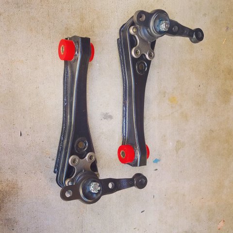

I Rebuilt the rear suspension a couple months ago. New poly bushings all around, blasted and painted the everything, Vogtland lowering springs w/ stagg shocks. The new wheels and tires were rubbing on the old suspension and are still rubbing so picked up a fender roller and am hoping to fix that. (picture is before lowering springs).

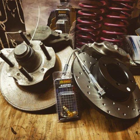

The front gets the same new shock/springs, bushings, blasting & paint, TC rods got the radial bearings, new wheels bearings, stoptech rotors, SW-8 calipers, Silver Mine pads, steel lines, ball joints and tie-rods.
