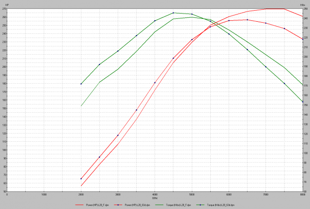

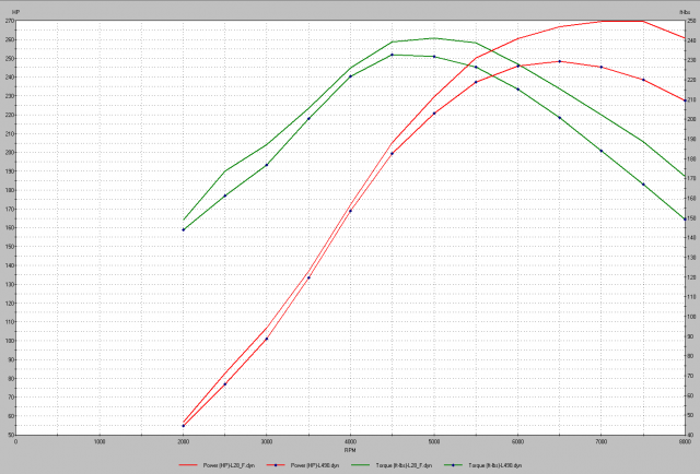

Steve is a decent guy, I was trying to decide on a cam and i was stuck between the DP cam, Rebello 63D cam, and the ISKY L490. I used a very simple program called Desktop Dyno to try to simulate the vehicle behavior. After some discussion with Steve he shared the specs. He didn't have a dyno sheet to do a comparison but he did find the numbers to be lower than expected. There is a lot of assumptions in the model and the port flow is simply based on measurements a member has posted on facebook. Either way it should work well to compare cam to cam. So here is a comparison between the DP 535 cam(L28F) and the isky L490. This is "crank torque" and the assumptions are 87mm bore 79mm stroke; 44/35mm in/ex valves. 10.5  static C/R. 3 deg cam advance on both cams, free flow exhaust, induction flow = 1500 cfm @ 1.5 inHg.

Personally i am leaning towards the 63DE (.487 lift, 279 duration)cam from rebello, it won't make as much peak power as the DP cam but  much higher torque until  5200 rpm. Peak power will be around 6500.
Plot shows both cams with 3 degrees advance. I would probably retard the 63DE which increases top end power. Retarding the DP cam really kills low end torque and the peak HP only slightly increases.

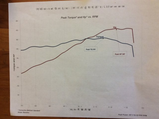

Here is my 3.0 liter dyno with Isky 490 cam and SU carbs.  I have a later dyno that I can’t locate where I had the timing and carbs tuned much better.  It looks pretty much the same but peaked 13hp more. post-11707-023618100%201318743869_thumb.jpg
And for Sh!ts and giggles my new LS1/T56 combo on the same dyno.F23B86D7-84F8-4008-B2EA-24C7C2E85234.thumb.jpeg.4b25a681b1a044adc654fa8f35a142d0.jpeg

@30 ounce Your peak torque is in about the same place as my plot predicts but your torque drops off faster in the higher RPM. I wonder if the SUs were limiting you a bit in airflow. After all you were running 20% higher displacement than what those carbs were originally specified for.

On 2/20/2018 at 8:40 PM, madkaw said:
I thought the DP cam had a shorter duration which in turn would not be making power later than the Isky- but I’m guessing here.
So the higher lift is killing the low end?
How is anything on that dyno chart 'killing' anything? It's above the L490 at every point of the curve.
