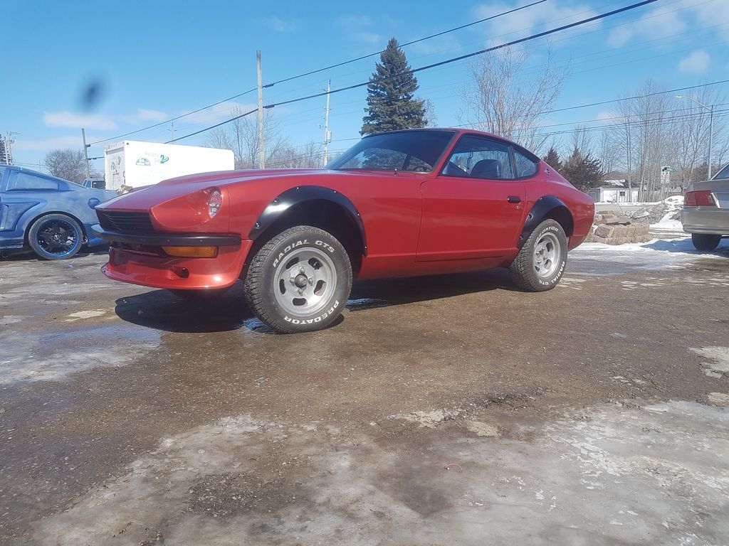

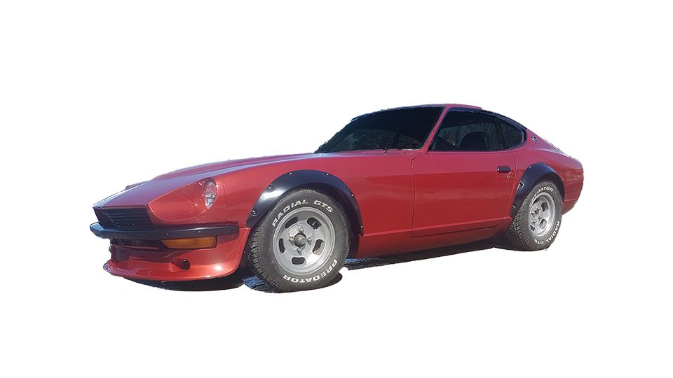

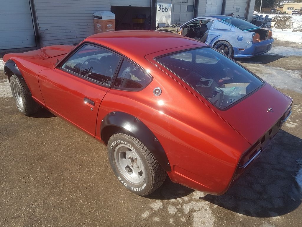

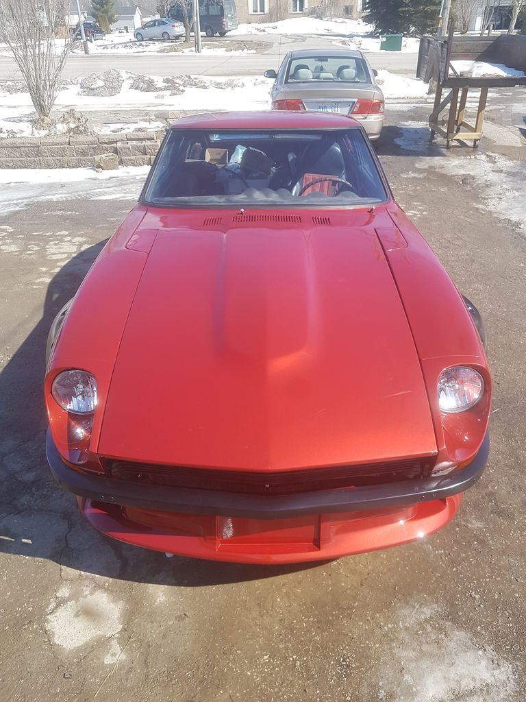

So here is a few shots out in the Sun. it was partially clouded but you can see the gold coming though. Car will go back in the warm weather for cut and polish job. This will being make the cars paint look deep. Last one is a quickie "digtal lowering" job. It looks like it sits so high now lol.

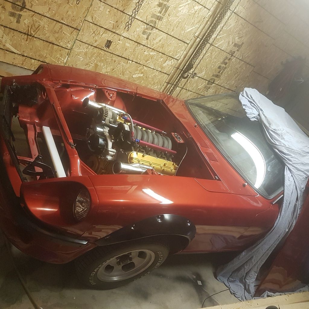

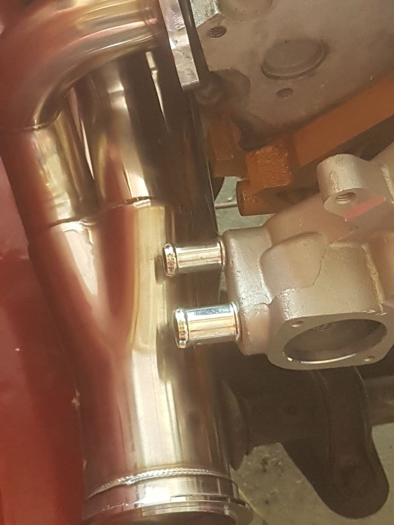

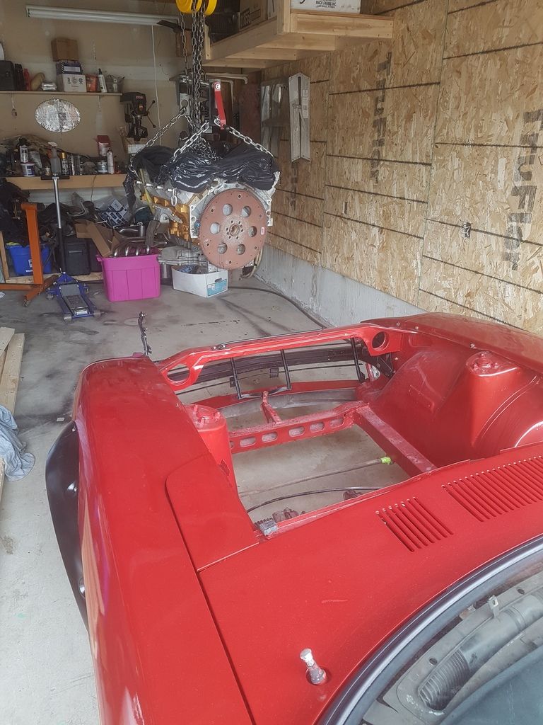

I managed to get the car home all safe and sound. Its been a cold week last week with only one good day so I took advantage of it. Motor is in but I am already running into issues. Car uses a LS1 water pump with spacer to match the truck crank. The TB hit the water pump and the heater lines hit the headers when in the low position. Solution is to pull the pressed in pieces for the heater line and tap them for AN fittings. The TB issues I'm still working on. I make be able to shave a little metal and make it work.

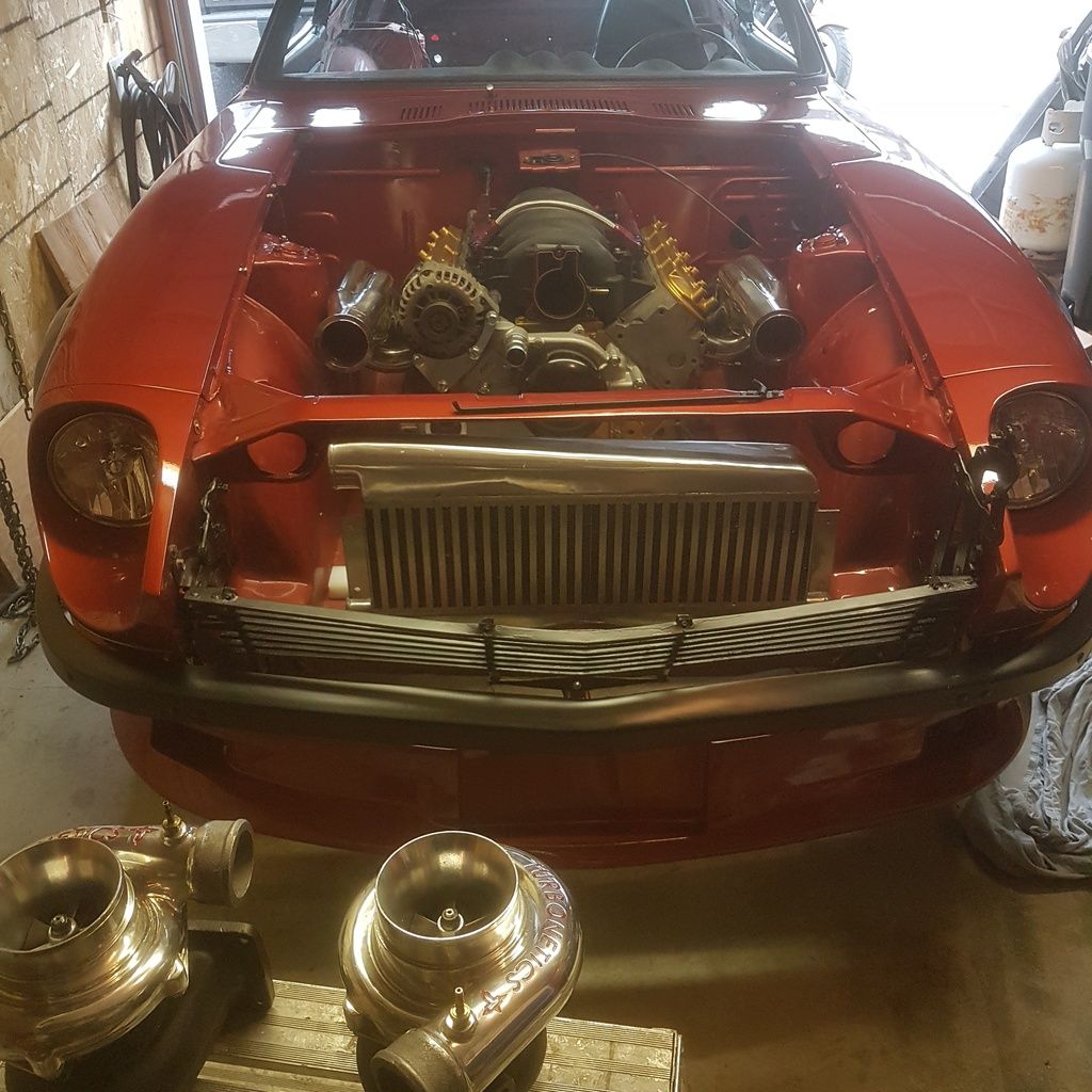

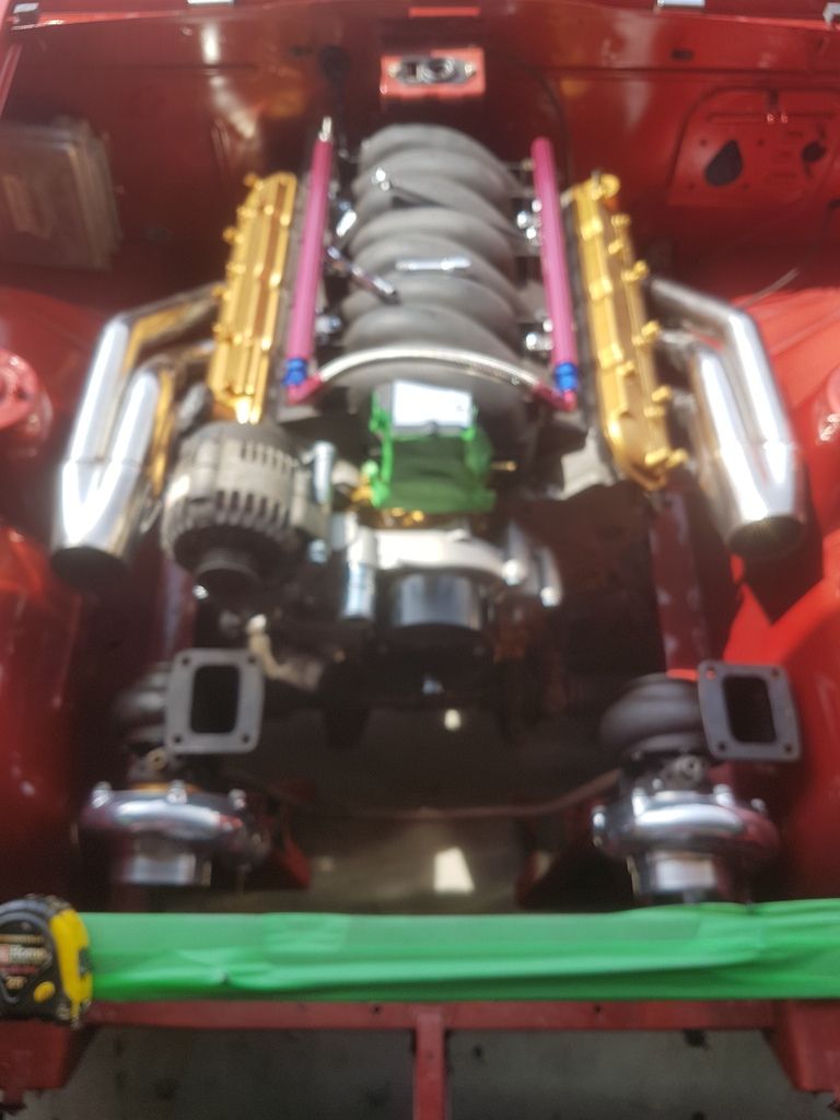

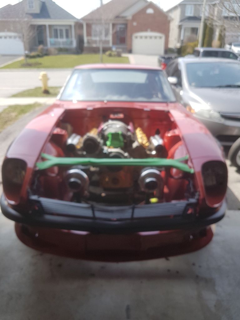

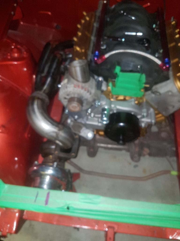

I cut off the flanges from the headers. Placed the turbo approximately where I want them and started to cut and weld.
