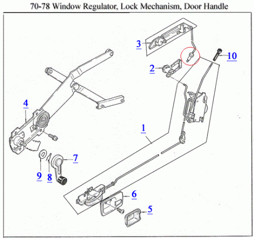

The door handle has a rod with a nylon adjustment nut. This adjustment can cause the door mechanism to unlatch the door if the nut is turned too far down the rod.
You can test the adjustment by moving the door latch to the closed position and then  pulling the door handle while watching for the latch to move.
See pictures.

A.  I can't believe you welded the striker to the frame...
B.  I can't believe that you didn't take the entire latch mechanism out of the door and completely clean and lubricate it.   (Well, I can believe that...  It's a pain...)
IMO you're looking in the wrong place for the solution to your problem.  Do what Miles said above and make sure all the parts inside the door are adjusted and working properly.  But, my bet is that the entire rotating latch assembly needs to be thoroughly cleaned, lubricated, checked for wear and proper operation.
