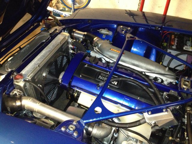

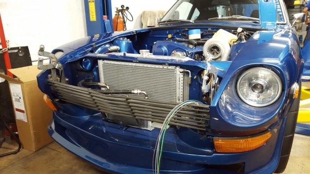

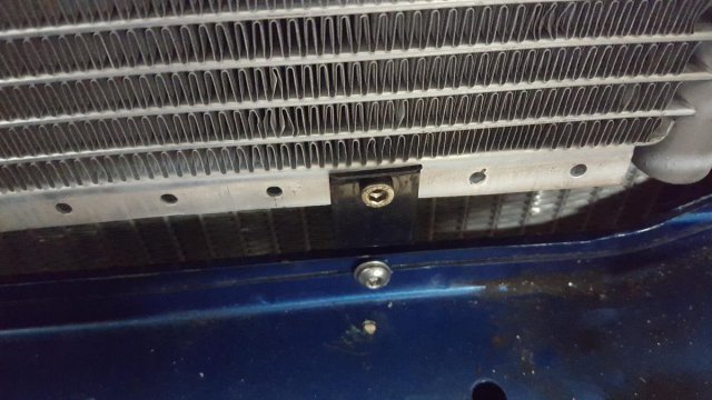

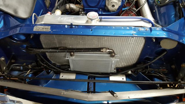

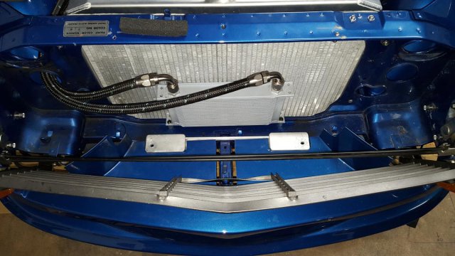

So of course the new Greddy oil filter adapter/thermostat led to a re-examination of the rest of the oil cooler assembly…
We decided that the lines from the adapter to the cooler could stand some improvement…not to mention the mess of wires that surrounded it...
Attached File  20150718_133701.jpg   125.67KB   0 downloads
First step is ...remove the mess of wires
Attached File  20150725_151500.jpg   132.06KB   0 downloads

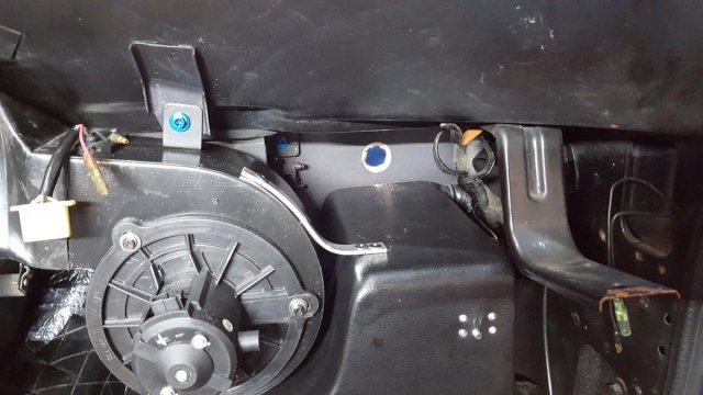

Once we mounted the evaporator inside, we noticed after the fact that we had covered up the firewall opening for the wiring harness to pass through...ugh
Attached File  20150808_150920.jpg   117.75KB   0 downloads
Attached File  20150808_150927.jpg   128.06KB   0 downloads

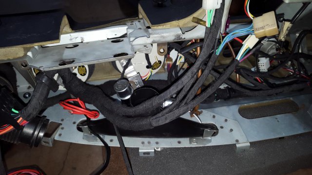

#45 boosted300
boosted300

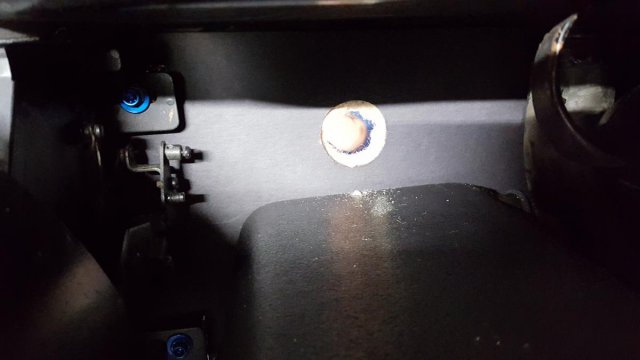

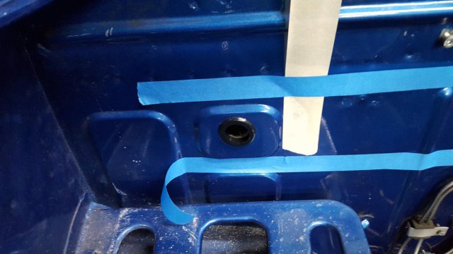

Posted 20 March 2017 - 03:59 PM

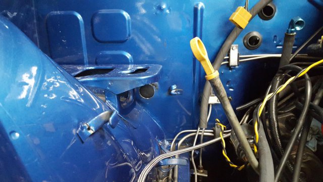

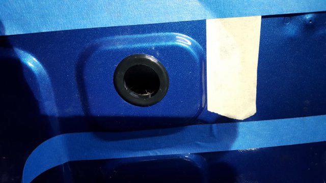

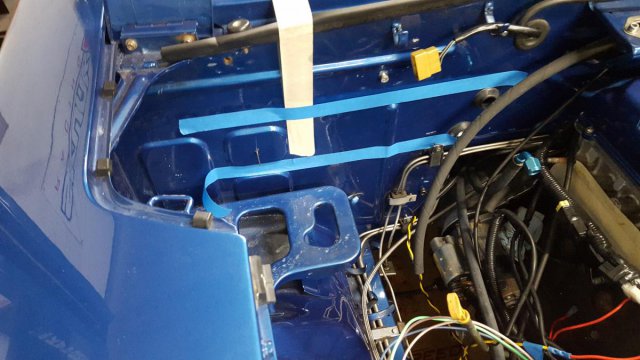

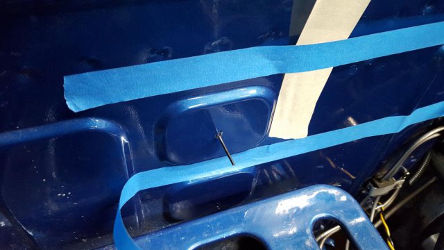

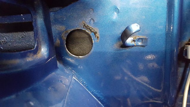

I have an OCD like phobia of cutting anything on this car, but we had backed ourselves into a bit of a corner now so I acquiesced knowing that Doug would make the cut very nicely and leave it looking factory.
We decided on a location just above and slightly to the left of the original hole...then marked it off carefully...
Attached File  20150808_163841.jpg   96.64KB   0 downloads
Attached File  20150808_163846.jpg   110.74KB   0 downloads
Doug then cut a perfect hole in just the right location for the harness to pass through to the engine bay...
Attached File  20150808_165309.jpg   58.04KB   0 downloads
Attached File  20150808_165334.jpg   104.89KB   0 downloads
Then we finished it off with a nice grommet...
Attached File  20150808_165439.jpg   85.76KB   0 downloads
Attached File  20150808_165444.jpg   99.05KB   0 downloads

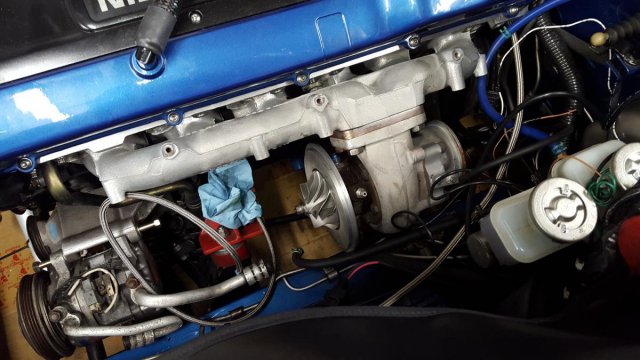

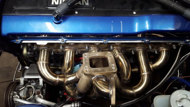

On to the fun stuff....
The turbo system!

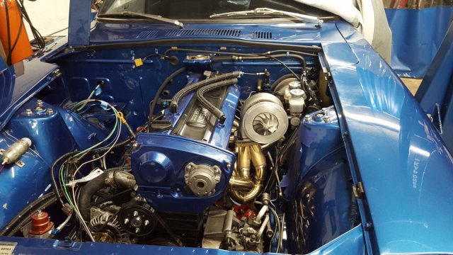

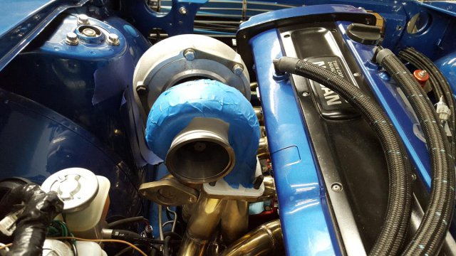

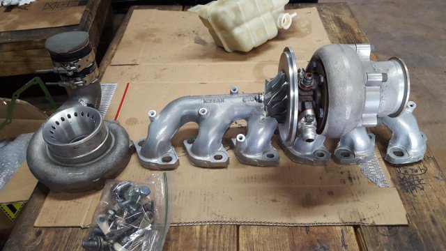

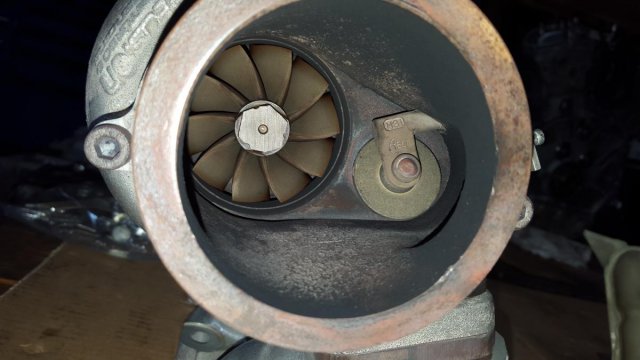

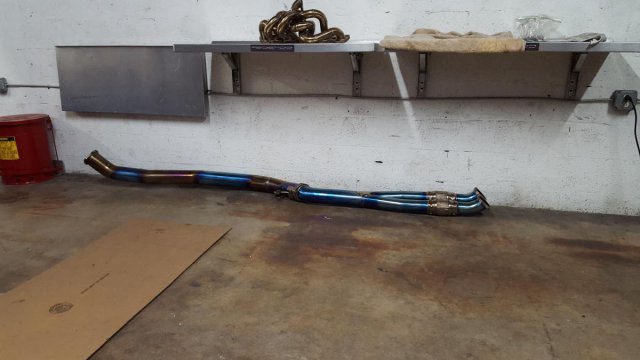

The car was using a stock RB25DET exhaust manifold and an aged GT35 with a .63 A/R and an ATP Ultimate internal wastegate. It was a simple, and easy to package, setup. Boost response was good but it obviously restricted the power ceiling.
Attached File  20150822_124313.jpg   125.01KB   0 downloads
As I mentioned, the snowball was in full effect...needing to fabricate new plumbing anyway, I figured might as well get a tubular manifold for top mount and upgrade to a bigger turbine housing and external wastegate.
Out with the old...
Attached File  20150822_142641.jpg   124.72KB   0 downloads
And in with the new...
Attached File  20150822_151923.jpg   150.99KB   0 downloads

Some pics of the outgoing system...
Attached File  20150829_115655.jpg   107.22KB   0 downloads
Attached File  20150829_115700.jpg   97.71KB   0 downloads
Attached File  20150829_115711.jpg   84.56KB   0 downloads
Attached File  20150829_115736.jpg   119.83KB   0 downloads
Attached File  20150829_131231.jpg   111.91KB   0 downloads

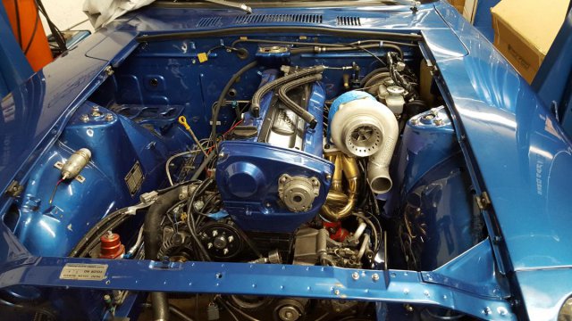

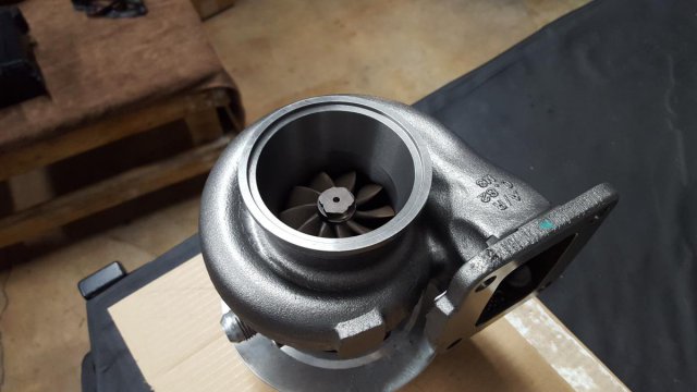

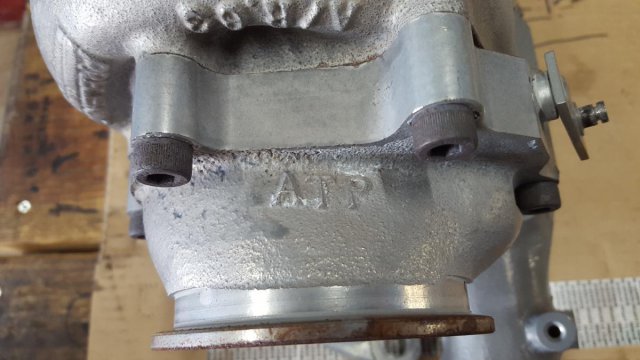

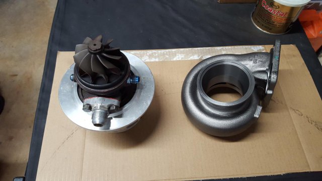

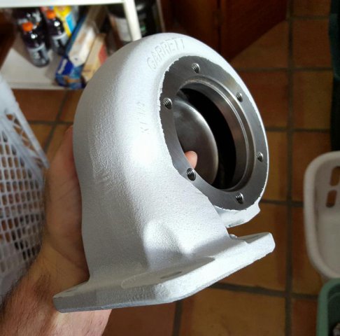

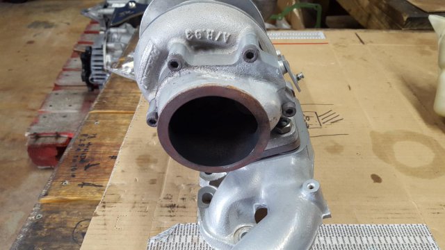

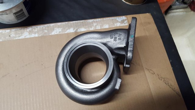

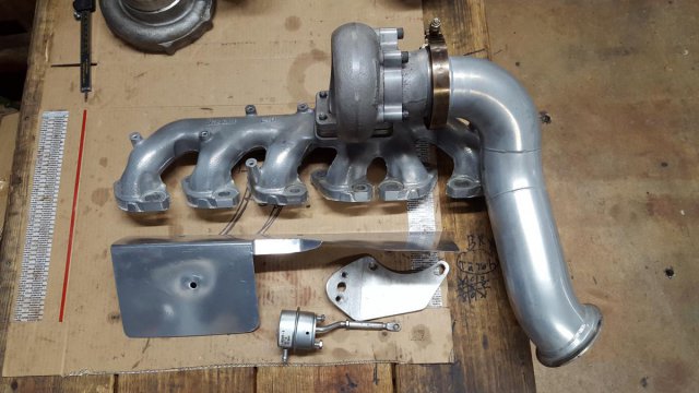

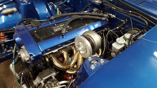

As this (RE)build was snowballing...I decided to pick and choose my battles.
Although the turbo was dated and there are obviously more modern units that would deliver much higher and more efficient power, I opted to maximize this unit for the time being...
New .82 A/R turbine housing...
Attached File  20150912_120755.jpg   88.35KB   0 downloads
Attached File  20150912_120826.jpg   85.14KB   0 downloads
Attached File  20150912_120842.jpg   80.36KB   0 downloads

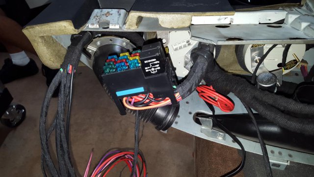

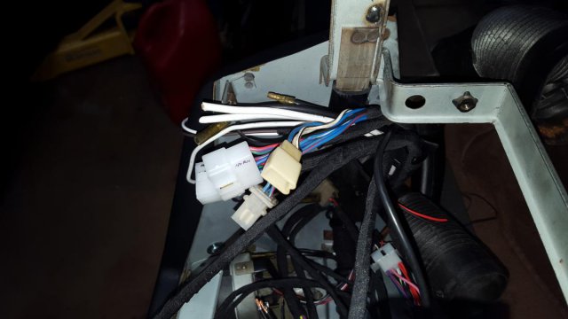

On the re-wiring front...some progress had been made in the behind the dash harness...
What a difference...
Attached File  20150912_140941.jpg   121.09KB   0 downloads
Attached File  20150912_140945.jpg   121.81KB   0 downloads
Attached File  20150912_140952.jpg   75.28KB   0 downloads

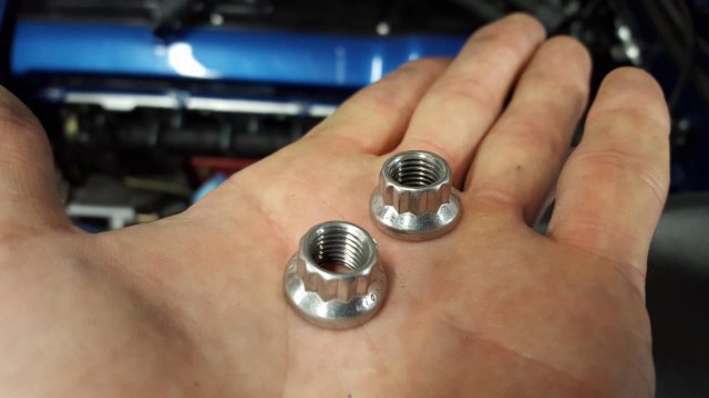

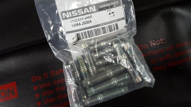

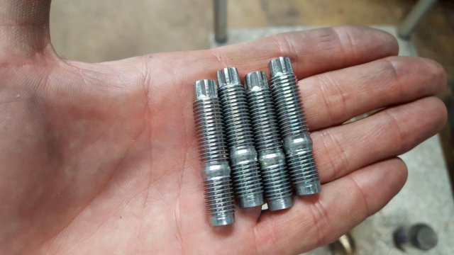

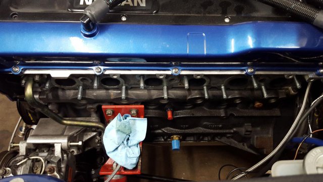

The previous owner for some reason used bolts for the exhaust manifold rather than studs…
for those that have had the unfortunate experience of stripping a head, it was not the best decision.
A trip to the Nissan dealer and consultation with a friend who is the parts manager there yielded me some very nice exhaust studs that were exactly the right size, from a Sentra of all cars.
Attached File  20150912_141543.jpg   95.84KB   0 downloads
Attached File  20150912_142305.jpg   86.55KB   0 downloads
Attached File  20150912_143107.jpg   117.77KB   0 downloads
And everything buttoned up with ARP of course...
Attached File  20150912_143146.jpg   58.56KB   0 downloads

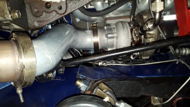

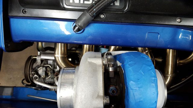

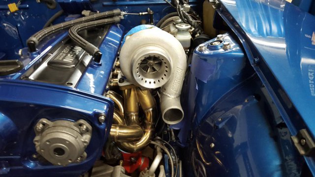

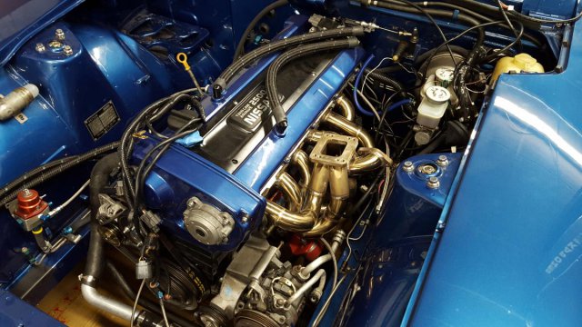

Test fitting the assembly to make sure clearances are good...
Attached File  20150912_143508.jpg   121.53KB   0 downloads
Attached File  20150912_144200.jpg   149.83KB   0 downloads
Attached File  20150912_144352.jpg   148.03KB   0 downloads
Attached File  20150912_144355.jpg   124.03KB   0 downloads
Attached File  20150912_144400.jpg   121.15KB   0 downloads
This was the one I was most concerned with but all good...
Attached File  20150912_144408.jpg   99.28KB   0 downloads

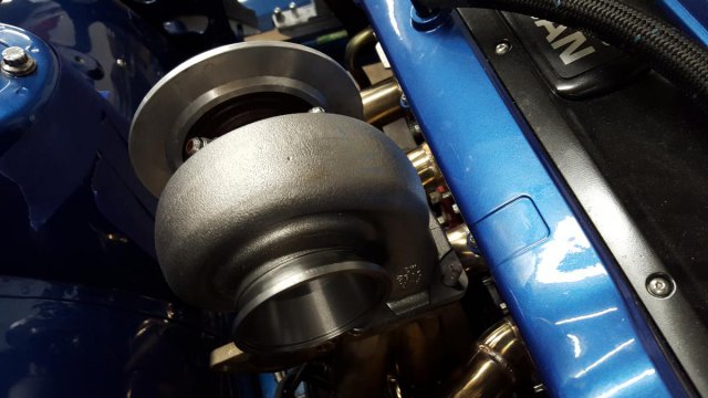

Posted 20 March 2017 - 05:03 PM

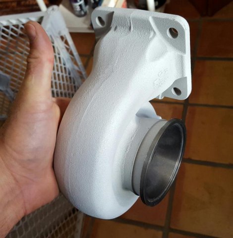

Exhaust housing clearance looking good...I sent it off to Swain Technologies to get ceramic coated...
Attached File  20151109_085429-1.jpg   65.22KB   0 downloads
Attached File  20151109_085448-1.jpg   64.43KB   0 downloads

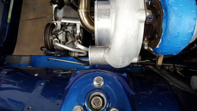

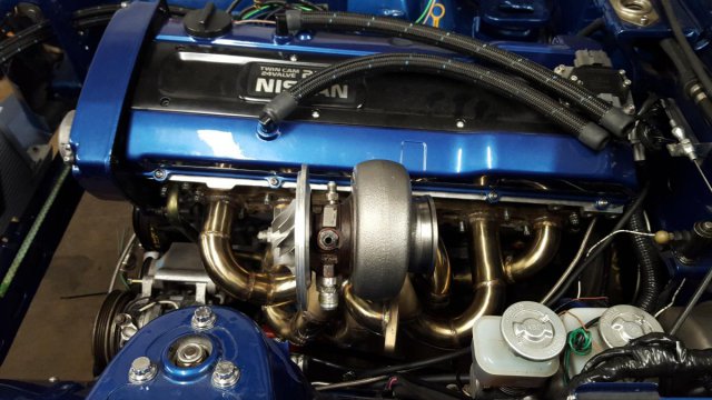

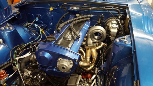

Some more test fitting...
Attached File  20151121_161250.jpg   149.35KB   0 downloads
Attached File  20151121_161259.jpg   98.32KB   0 downloads
Attached File  20151121_161303.jpg   108.46KB   0 downloads
Attached File  20151121_161319.jpg   116.9KB   0 downloads
Attached File  20151121_161434.jpg   142.01KB   0 downloads

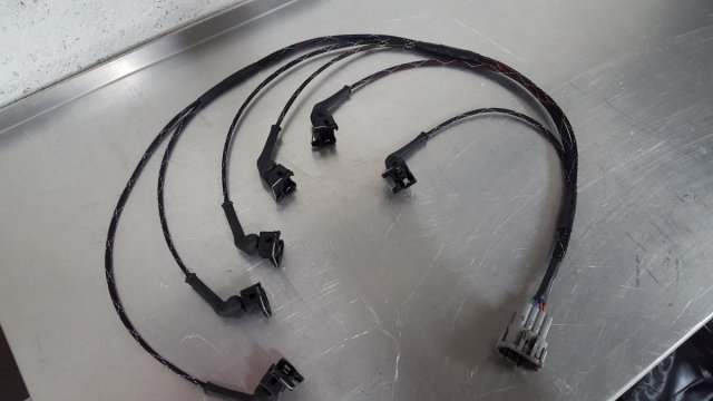

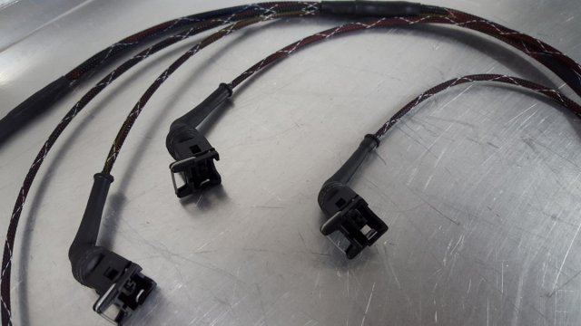

Meanwhile...more progress on re-wiring...

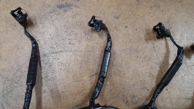

Old injector harness...
Attached File  20150620_132942.jpg   150.94KB   0 downloads
Attached File  20150620_132946.jpg   159.53KB   0 downloads
New and improved harness...
Attached File  20160109_125550.jpg   81.25KB   0 downloads
Attached File  20160109_125558.jpg   85.12KB   0 downloads

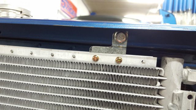

Time to mount the condenser...
Using some generic bracket material...
Attached File  20160109_132724.jpg   117.65KB   0 downloads
And some factory holes
Attached File  20160109_132753.jpg   161.05KB   0 downloads
Fabbed some small brackets...
Attached File  20160109_141339.jpg   120.9KB   0 downloads
Attached File  20160109_173728.jpg   114.52KB   0 downloads
And mounted the condenser up
Attached File  20160109_141534.jpg   146.15KB   0 downloads

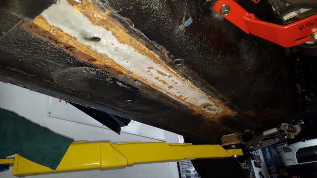

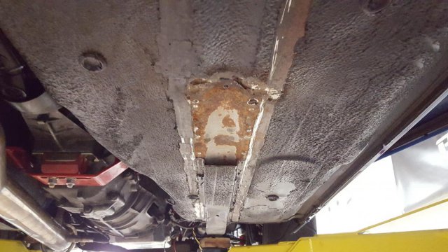

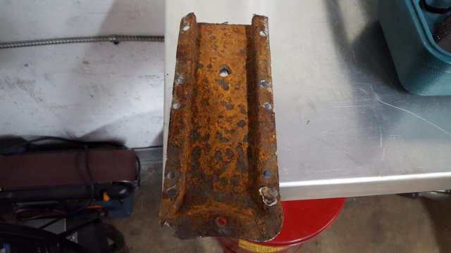

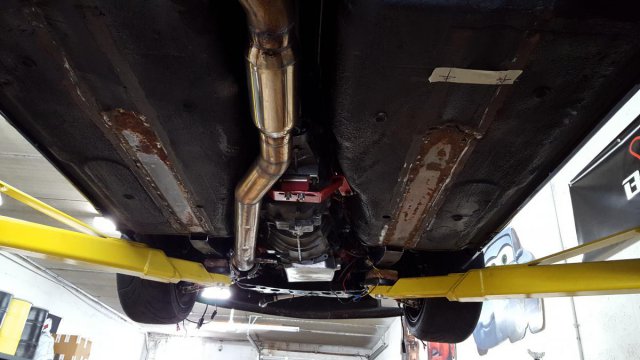

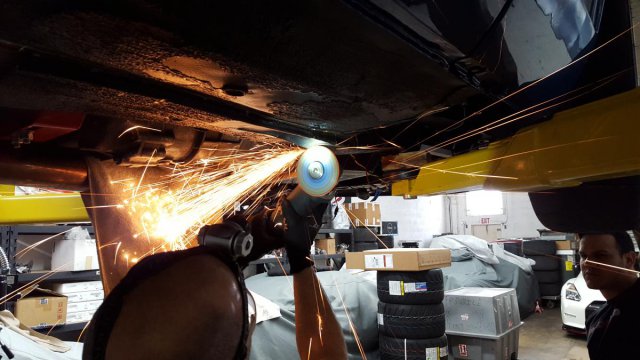

I quickly discovered how much fun it is not to scrape off undercoating.
In the process, I discovered the mortal enemy of early Z cars...rust...on the rear edge of the passenger side factory "half" frame rail.
This was not only surprising, but disappointing in that the car had been advertised to me as a "rotisserie" and had no miles on it to have developed this much rust, this fast...deeeeeep siiiiiiigh.
Hoping that it was very minor I began chipping away...and soon it was apparent that it wasn't really minor and extended under the factory rails.

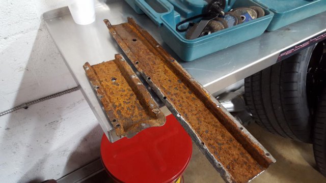

I got a mallet and began banging on the rail and could hear the sound of what I was sure were rust chips rattling around inside....ugggggh.
We cut the piece off to get a better look...
Attached File  20160118_141619.jpg   124.7KB   0 downloads
Sure enough...
Attached File  20160118_141603.jpg   79.3KB   0 downloads

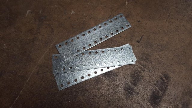

Well now we couldn't just stop there...
Attached File  20160118_143005.jpg   116.9KB   0 downloads
Attached File  20160118_143853.jpg   109.95KB   0 downloads
Attached File  20160118_143818.jpg   100.12KB   0 downloads
Not great...but I suppose it could have been worse.
