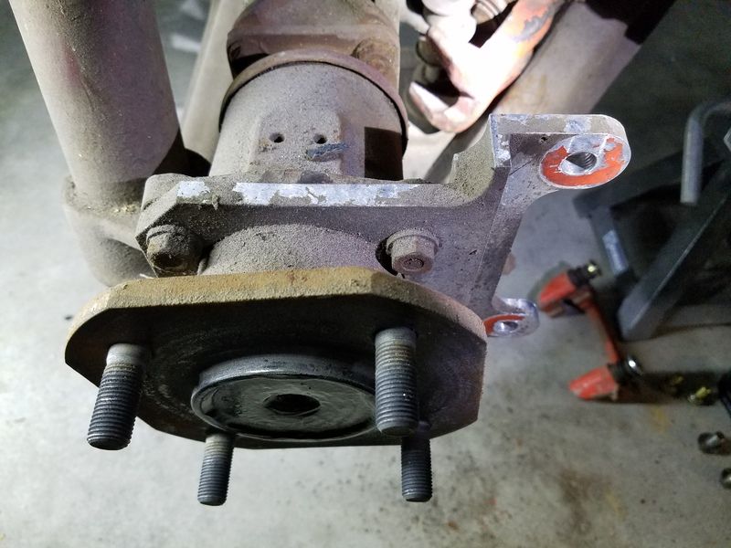

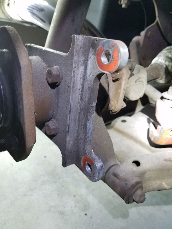

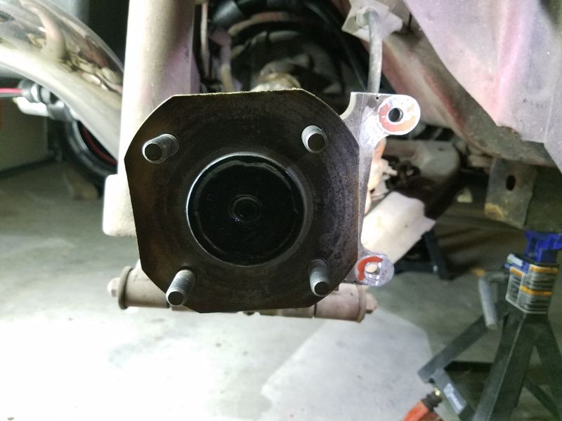

Ok, I've read thru the brake FAQ and so many different posts that I've gone and confused myself.  Just trying to figure out exactly what I already have so I can buy new rotors.

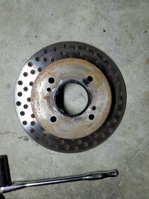

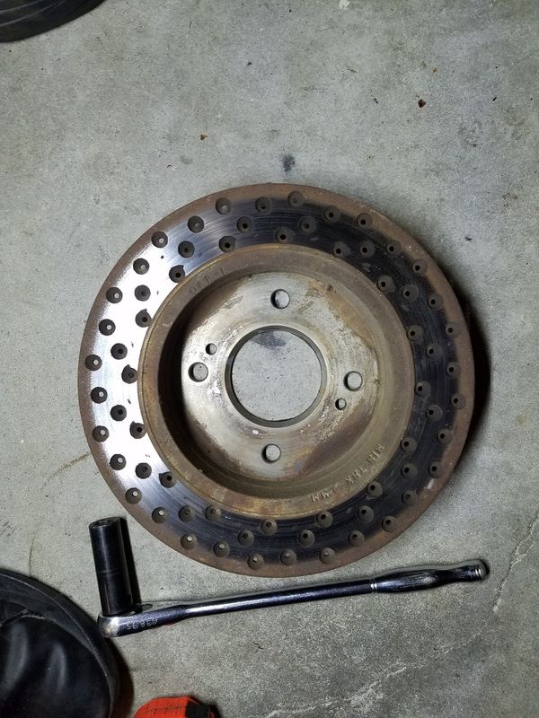

I believe what I have here is the S12W calipers for vented rotors, which makes sense considering the rotors on my car are vented. There is NO spacer between the rotor/hub, so if I understand things correctly I have stock size 70-73 front rotors?  The diameter is ~10.65 and the rotor bolt pattern is 4 x 4-1/16".  If this isn't true, what the heck do I have?  If this IS true, what would be the benefit of getting spacers and 84-85 300zx non-turbo front rotors?

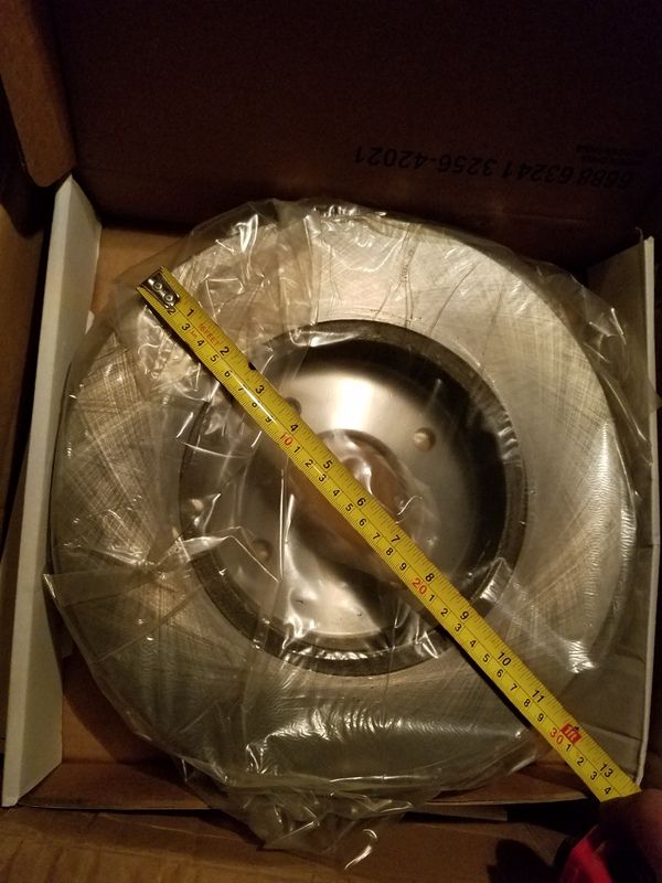

On the rear I know I have S13 240sx calipers, but I'm confused about the rotors.  Currently on my car are ~10.125" diameter vented rotors.  I thought I needed 84 300zx non-turbo rear rotors, so I ordered cheap solid face rotors for that application, but what I received was NOT vented and way too big at 11.4" diameter.  Do I need 280zx rear rotors? s13??

Those are drilled rotors, not vented rotors.
S12w calipers have "s12w" in the casting and (iirc) all pistons are equal diameter vs the +8 caliper at 43/38mm (ish).
Yeah, I understand the difference between drilled and vented. The rotors that came off my car are both drilled and vented, they're fairly thick.  I don't really want to replace them with drilled rotors, I would prefer just slotted or even solid - but my primary issue is I do not know which application to order for.  I do, however want to make sure to get vented rotors.

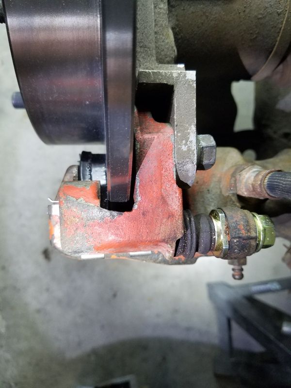

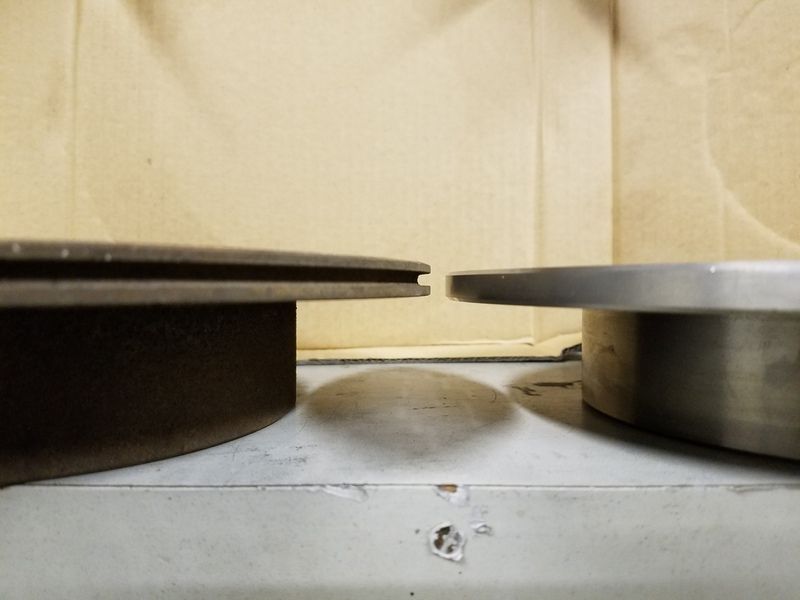

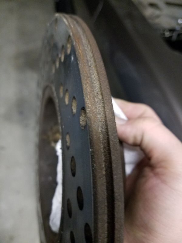

Post a picture of your rotor edge-on and a picture of the bottom of the caliper where the rotor goes.

I'm a non-observant idiot.  My rotors that I thought were vented just have like a vent-looking slit on the outer edge, I never looked at them thoroughly enough to realize that they are in fact solid discs.  DOH

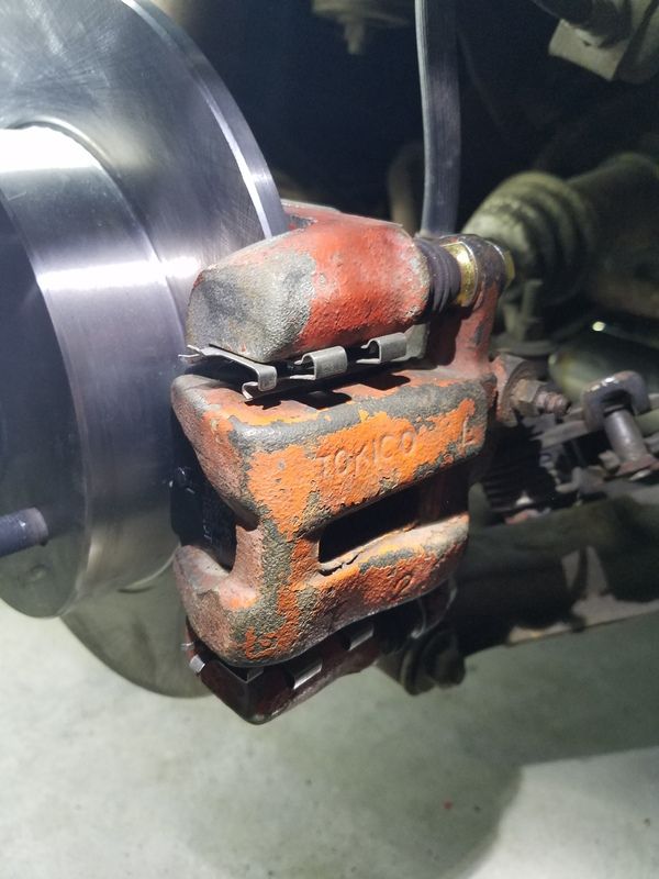

My calipers are also clearly the narrow S12+8, based on the groove machined in the caliper in this pic:
So, I just need stock 70-73 front rotors and I'm 99.9% sure I need 280zx rear rotors.

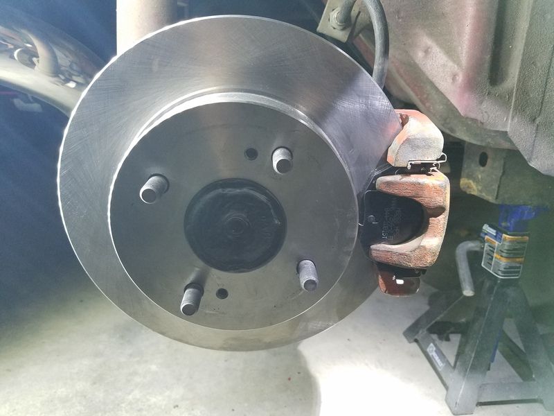

I went to my local Advance Auto and got a stock s13 rear rotor.  The measurements seemed pretty darn close, so I thought I would try it.  But the rotor doesn't seem to sit in the right place in the caliper and with everything bolted up it all binds and you can't turn it at all.  I bolted the wheel and tire on and still couldn't budge it.  I thought maybe there was tension on the e-brake with the new pads and everything, so I adjusted that all the way out to where I had no tension on the e-brake, but still no difference.  Here are some pics of the rear brake setup, and comparison between the two rotors, as you can see the depth is different.
Share this post
Some of the rear disk conversion kits used the 84 300ZX rear rotors.
Do a search on 240Z rear disk conversions to see if you can confirm which rear conversion kit you have as there are many kit configurations using Maxima calipers, 200SX, 240SX calipers, 280ZX calipers in combination with Maxima rotors, 240SX rotors or 300ZX rotors etc.  You may have the wrong rotor or an installation error.
Answers likely in: http://forums.hybridz.org/topic/39435-help-what-brake-options-are-available-for-s30-z-cars/
Note: The Maxima,  200SX  and  240SX calipers look very similar.
When fitting new pads in the 240SX/Maxima style  calipers you have to turn the piston all the way in to make room for the rotor. When the piston is all the way in,  turn it so the alignment pin on the pad slides into the groove (grove approx 12 o'clock). Otherwise the rotor will bind on the pads. You can rent the piston tool from most parts stores or use what you have, but the tool works better.

Sonofabitch! I knew I was missing something....
The pads that came off the rear were pretty new and I couldn't get the piston to go in any further so I thought was all the way retracted... I've never seen the turn-style piston.  Sheesh  So, I went to the auto parts store this afternoon and bought the tool for a 3/8-drive ratchet for $10, turned them in and everything went back together perfectly now, using the s13 rear rotor!

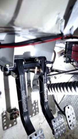

I have had only good experiences with Carbotech pads and shoes. This winter I replaced the stock booster, MC and pedals with Wilwood pedals, MCs and new lines.
Took the car out on Saturday and it operated flawlessly.
