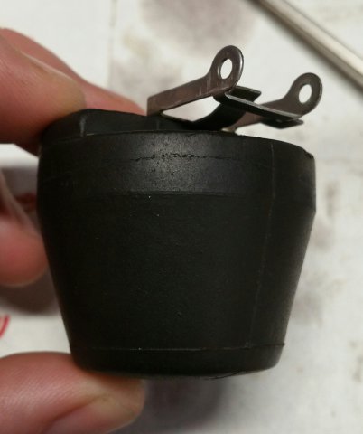

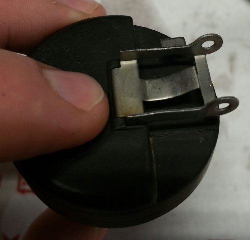

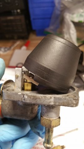

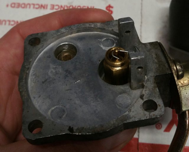

There should only be one crush washer under the needle/seat assembly.  You're rigging if you do otherwise.  Your tab that touches the needle looks all bent - definitely wrong.  I'm going to look for a pic that shows what it should look like.

It’s been ages since I took apart my SUs. But I do believe there is two different height needle valves. If the wrong ones are in there (short in stead of tall) it could be very very difficult to set the float heights.
Maybe different for different years...  Have a look at this:
By the way 5 Star Rising, don't follow ZTherapy method of setting float level.  Look at the thread in this link - especially post 28.  I never had any problems setting the float levels following the factory workshop manual instructions.  No gross jets...
I used the same needle and seat for both the front and the rear carburetor.  I don't recall the posts and pins holding the floats being different heights for front vs. back carb.

Looks like that link confirmed by thoughts. Front and back are different.  Probably not your issue.
Raising the valve via washer will effectively make your mixture more lean. That’s the way it works in my head at least.

Honestly, I think that guy has carb tops from different years or something.  The vents tubes, comparing between the two tops, are completely different.  My 4 screw SU's had float chamber tops that were the same.

Something isn't right I feel like the shorter needle valves would fit better then these tall ones thus lowering the entire setup inside the bowl. I thought I remember seeing different ones in the past as well but it's been a long time. I put two washers on each needle valve to raise it even more and I feel like I'm rigging it..
I finally got the fuel up close to the top of the nozzle but the float has to come up so high to the lid that it's almost sideways and bottoming out. Something is not right.. i have spent hours today trying to get the fuel in the bowl High Enough to where I can see the fuel almost flush with the top of the nozzle while having the nozzle screwed all the way in to the top. Think I may have the wrong set up in these from the beginning.

First thing, the tabs on my floats were bent the wrong way, I looked up some pictures of néw floats and followed the bend in the tabs and shaped them correctly, I set the float levels correctly watching the videos you guys posted and also following my shop manual, set the firewall carb ever so slightly richer to offset the stance of the motor.

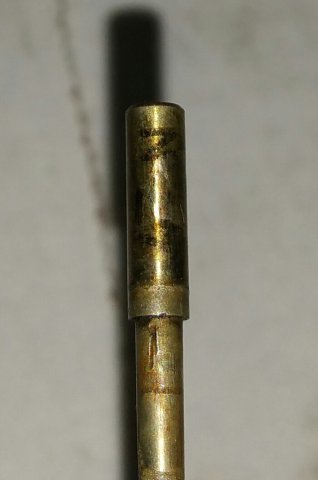

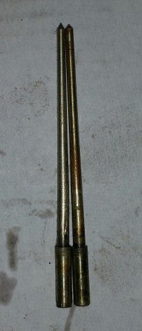

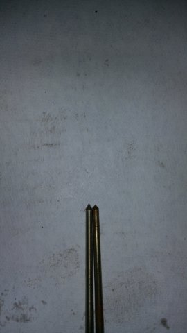

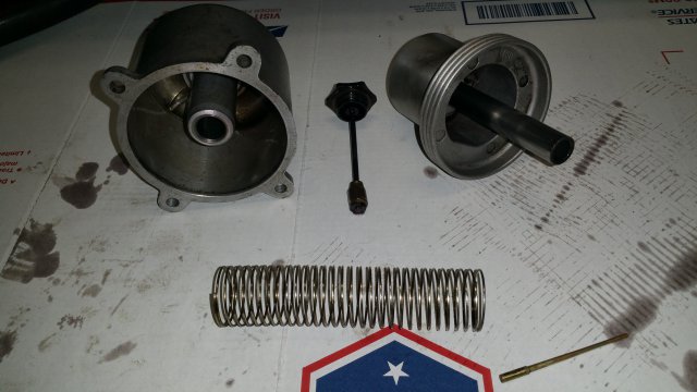

I cleaned the SU pistons for any grit, had a hell of a time doing a drop test on the pistons, I had bent needles and the needles also had scratches and rust at the top of the needle so the piston would not go all the way down and make that clunk sound, took the needles out and put them in my drill and pressed down on them on a rag to help straighten them, i took 800 grit sand paper and took off any burrs that were on the top of the needles.
 I adjusted my choke cable as it was binding on the front carb, i changed one of my nozzles as it was more centered than the one that was in there, I adjusted the jet needles by slightly tightening them and pushing them into the carb while pushing up on the nozzles and then tightening the needle set screw, this was done with the nozzles turned all the way up in the max lean position. The pistons then fell down nicely and made that clunking sound while hitting the bottom.
I then used 10-40 motor oil in the plungers instead of ATF.  And wow what a difference in resistance, both carb pistons went up super slow and with great resistance compared to the ATF.

Good to hear.  I'm glad we were able to help.  No ATF, use motor oil instead, pistons have to move/float freely through their entire movement range, needles and nozzles need to be in good shape (not interfering with each other at all) and installed correctly, fuel levels need to be set right.  From there, setting nozzle heights and syncing the two carbs with each other properly is about all that is left for good carb operation.
