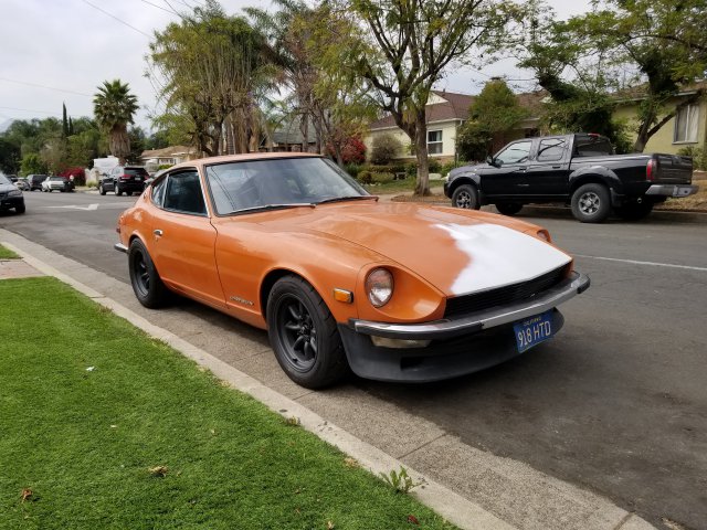

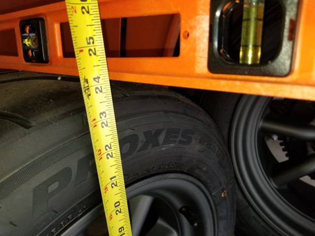

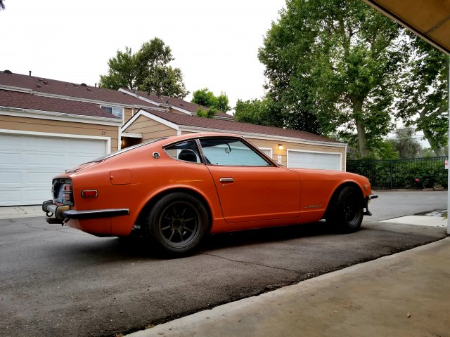

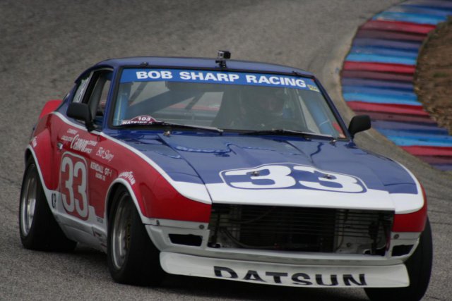

auxilary, those tires are great, unfortunately they are discontinued and weren't replaced in that size. The only Yoko option right now is advan a048 but at 230/ tire it's a bit expensive
yeah, those are old pictures from 2003. Very few still make 225/50/15 tires.

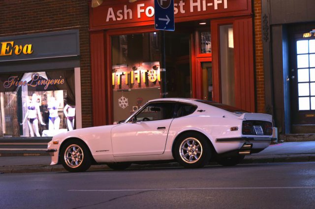

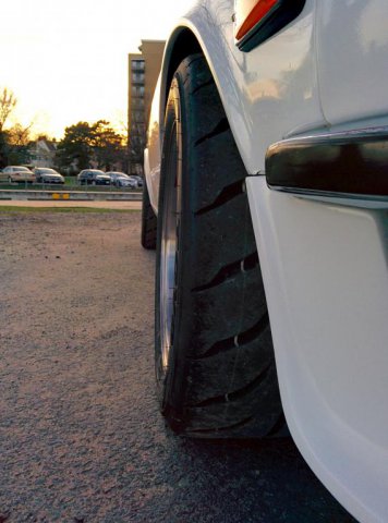

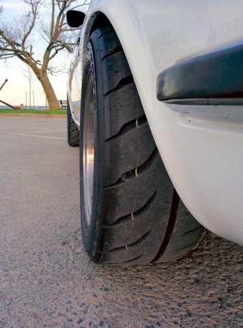

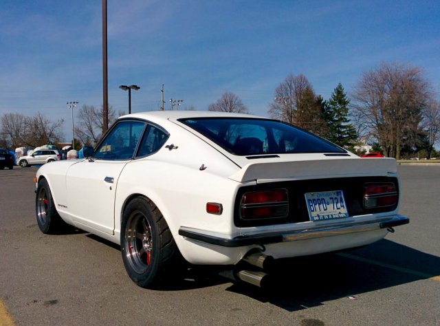

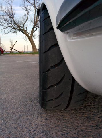

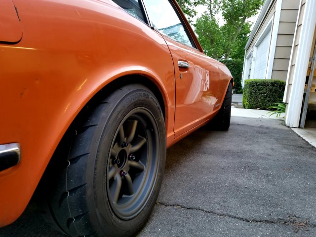

Took a couple of weeks longer than I thought it would, but I got my wheels and tires on today.  15x8 ET0 wheels and Toyo R888R in 225/50r15.
No rub so far, but it's cutting things pretty close.  Maybe on big bumps or extremely hard cornering there might be contact.  I'm lowered about 2" on the old MSA "blue" springs.
Here are some pics for you to show fitment.

That looks great. Those are some really wide 225s to sit like that on an 8" wheel.
On a separate note: what muffler is that? I want to do a 2-in 2-out with an X pipe in that configuration

The muffler is my attempt at replicating the old school vertical stack.  It's a Magnaflow muffler turned sideways with staggered slashed tips welded on.  I'm pretty torn on it - looks killer from some angles, and awkward from others.
If I were to do it now, I would just buy the Zstory system.  Or in your case, maybe try and source a Fujitsubo or Spirit Garage (Japan) exhaust backbox, as they both do the vertical stack in a 2in2out configuration.
Here is an old pic showing it off a bit better.

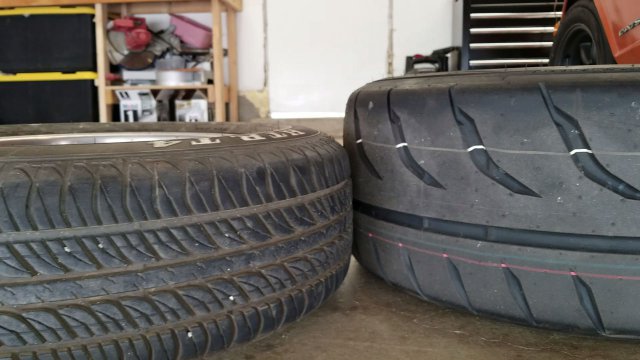

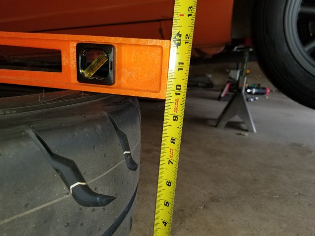

Single Point Jack Plates, Low Profile Jack, or 2X6 pine (4).
My 240 oil pan sits lower than the crossmember and I can get a Harbor Freight $100 jack under the TC box and diff. I run 16/8/245 all around on a lowered car.

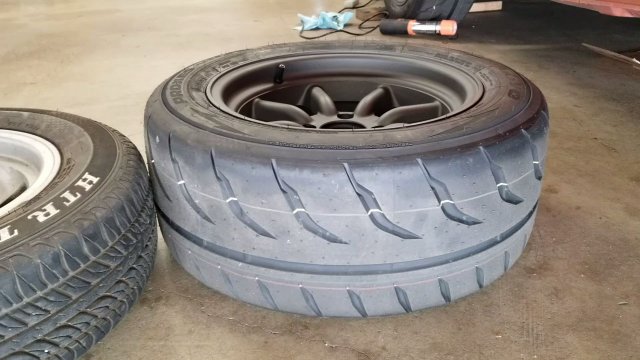

I run RA1s on the race car since we can't run slicks in my Group which are 225/25/15(F & R) and and here's a picture at full droop (running with slicks during an HPDE - 225/45/15 -F & 275/35/15- R)
Fixed measurement points (center of fender inner lip, rocker, TC rod box, crossmember, diff) would allow us to compare car to car.
