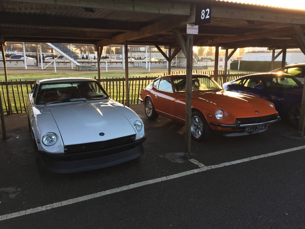

This is one of the last pictures of my car before it was taken off the road.
This was a morning PistonHeads Sunday Service at Goodwood.

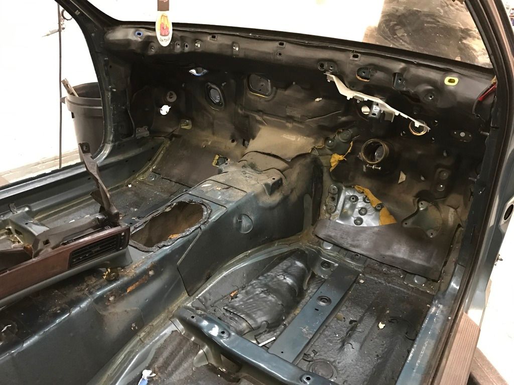

3 days later and this was what was left.

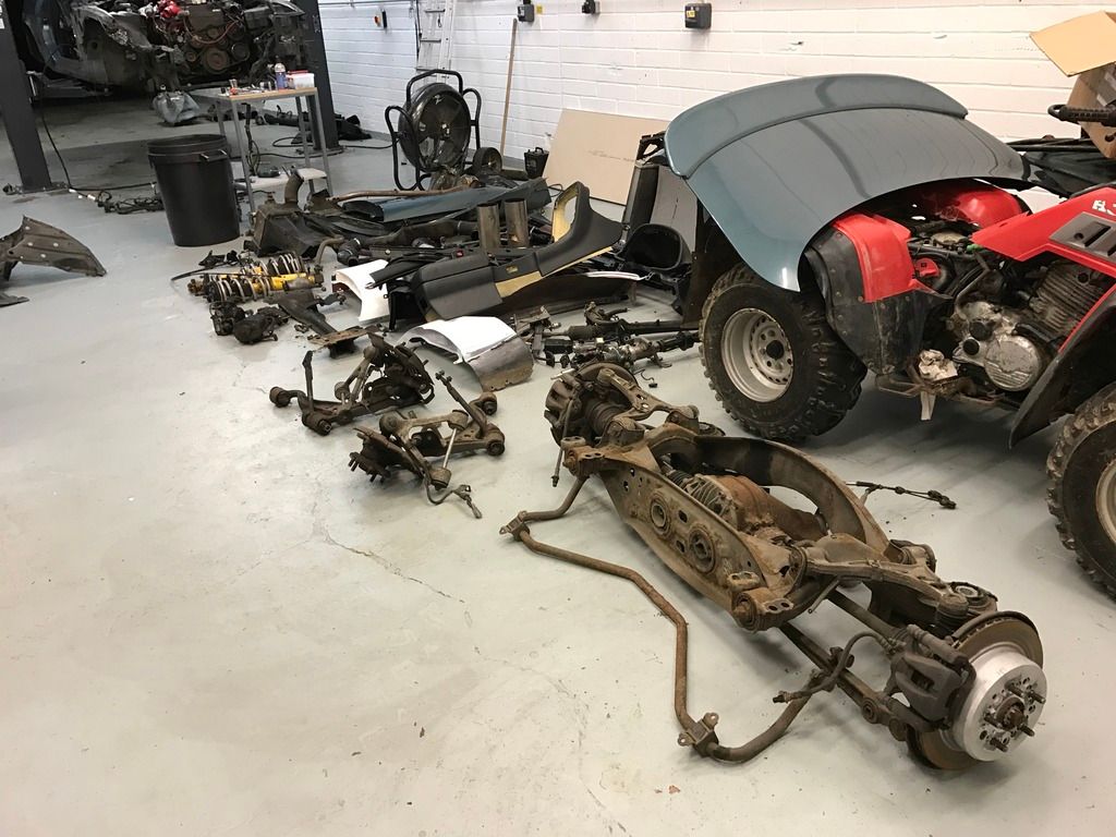

A decent selection of parts to put on eBay to try to pay for itself
AA729CA3-9648-4FE8-BA2C-B8AFBB6A6D1F_zps

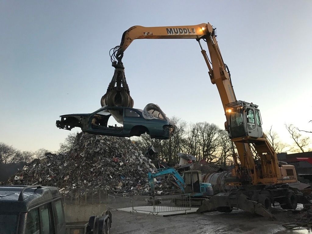

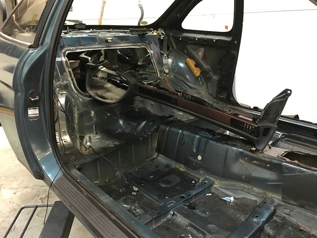

A trip to the Scrap yard and that was the shell out of the way
0850AE2A-F7F8-41CF-9EAE-D0BB5A4D0484_zps

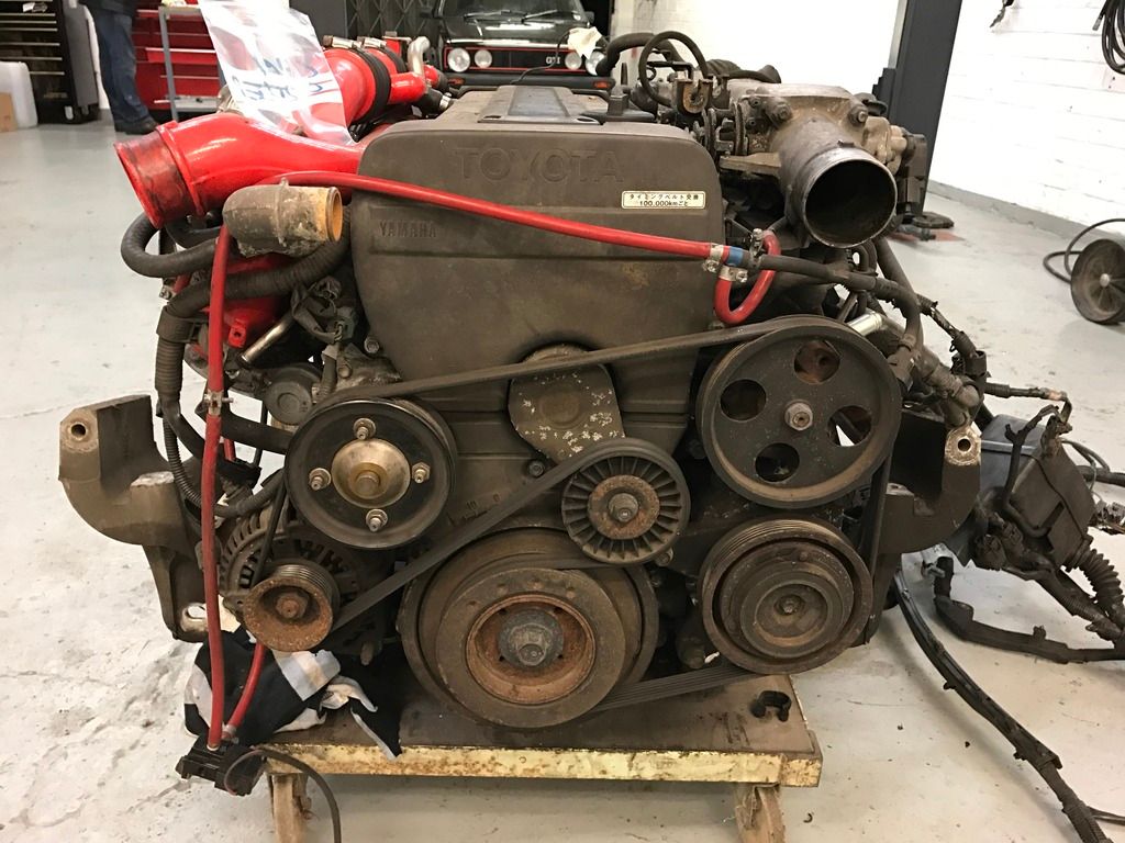

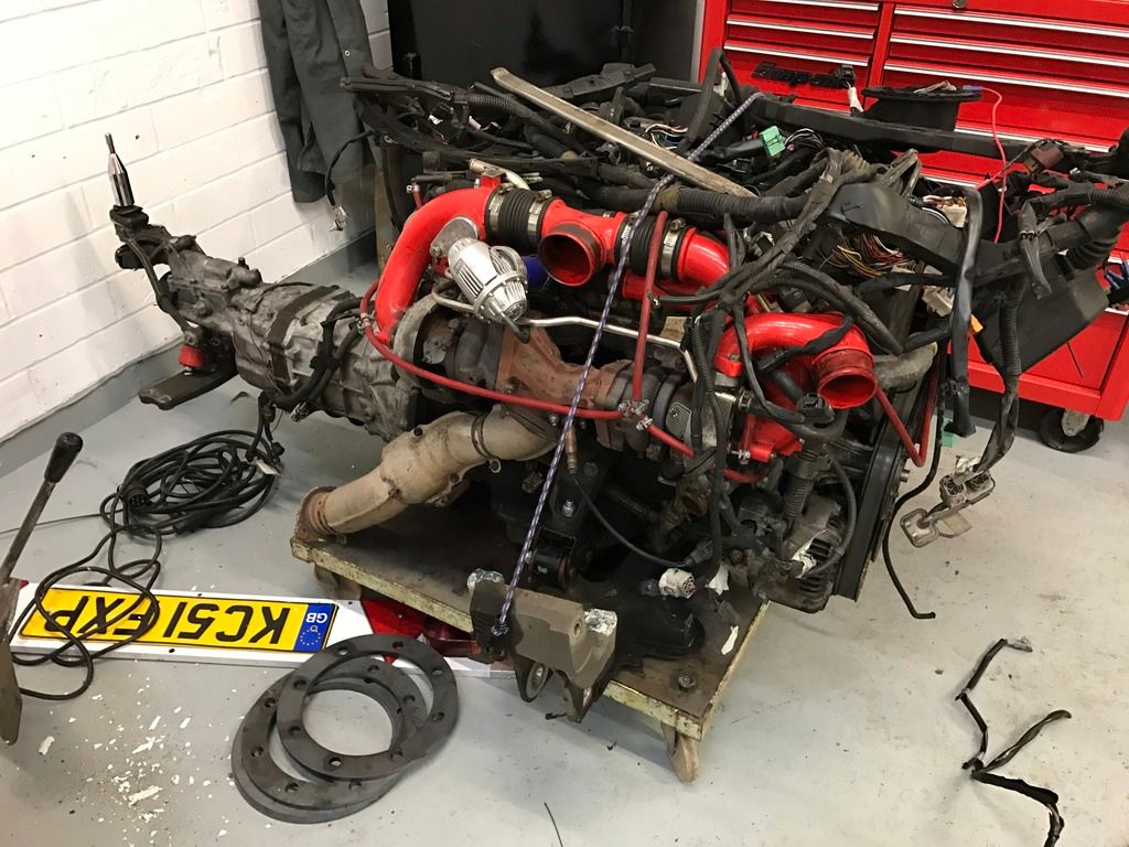

That left me with all the parts that I need to get started with and the rest of the parts sold on eBay.
The engine needs a lot of cleaning and work to get it looking how I want it but everything is there so it's mainly time needed rather than a load of £!

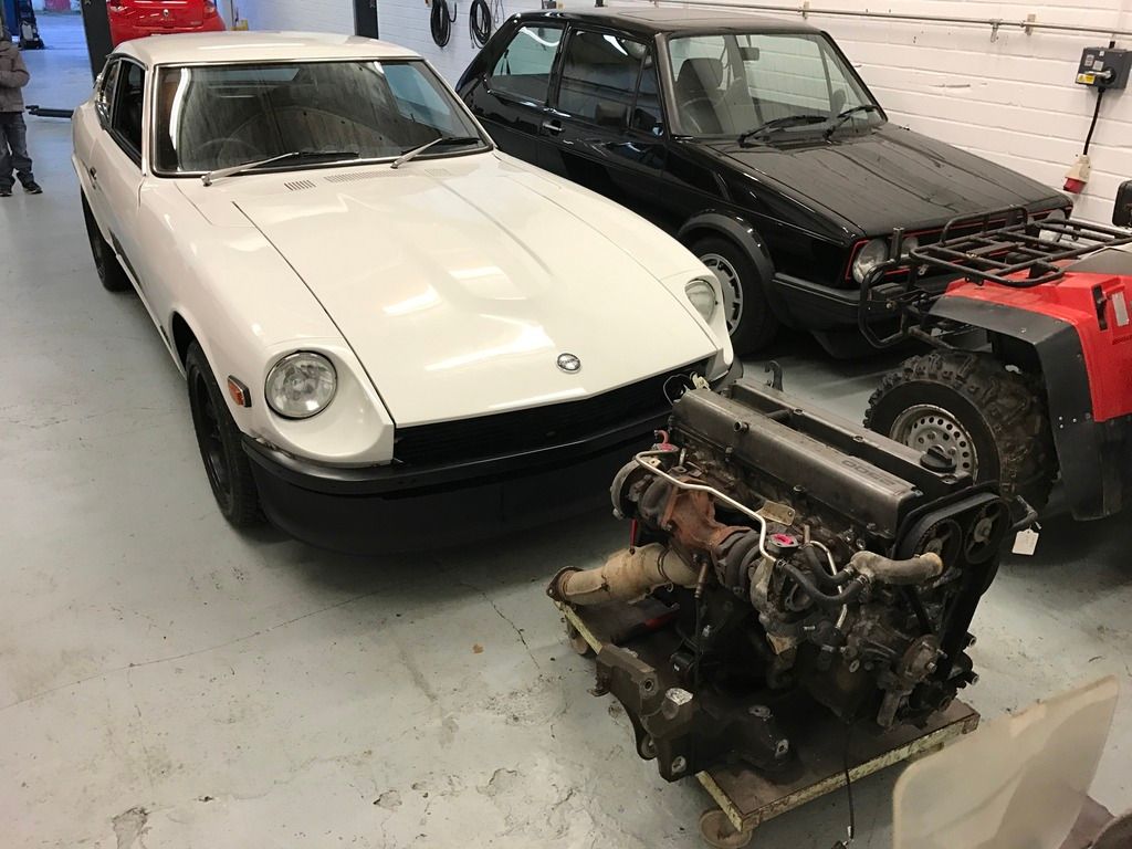

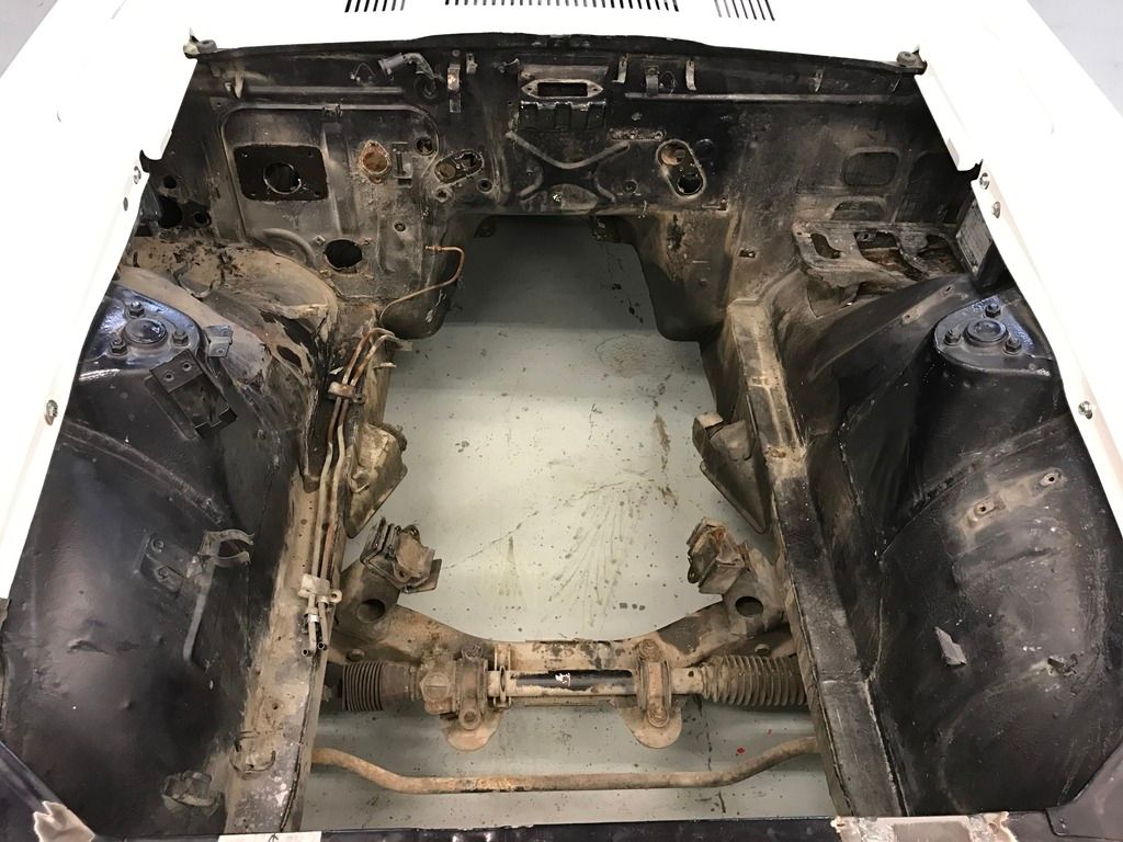

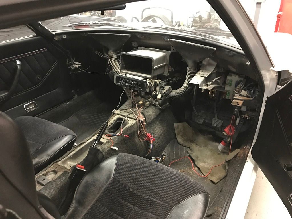

We are now onto the strip down of the car as the plan is to sand blast and paint the car from the windscreen forward. Therefore everything has to come out of the bay
5BBCCBD5-099D-4568-987E-15A7C0960B94_zps

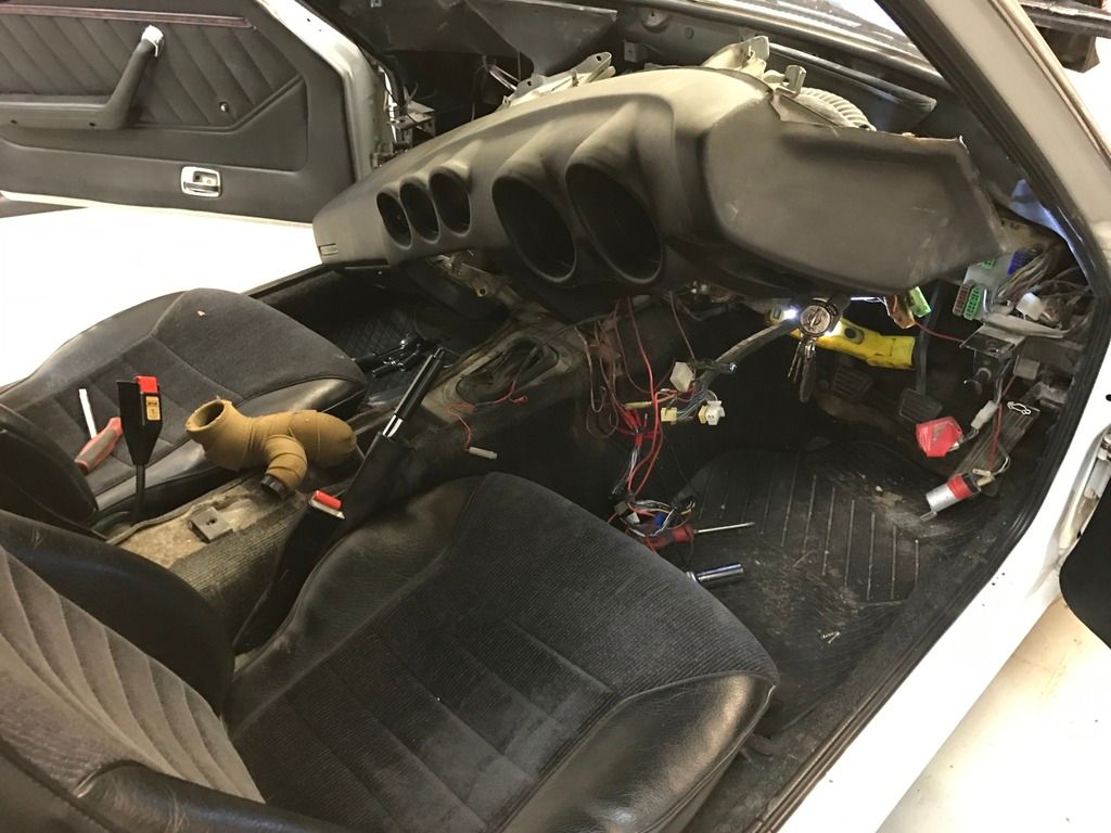

The heater matrix has never been connected in my ownership so coupled with the fact that I will be trying to reuse the gauges means there will be a lot of wiring to do that will be easier with the dash out.
A6BEE44B-ACFA-4C90-A90A-8A57FFA75911_zps
The challenge is knowing when to stop
DDF852A3-86C9-44D2-A4CD-F199857D7286_zps
There are some areas of rust that need addressing on the floors and under the dash so I will be replacing the carpet at the same time.

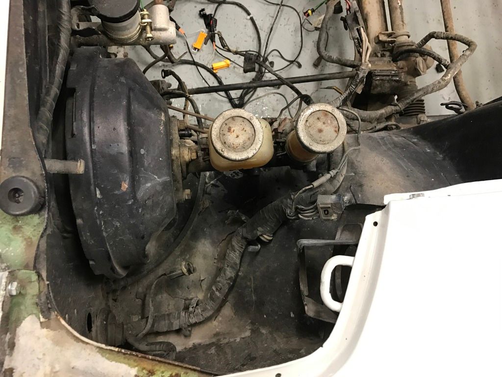

We also discovered that the brake servo and master cylinder has failed so I plan to upgrade this with an R32 Skyline version that are cheaper and easier to come by.
