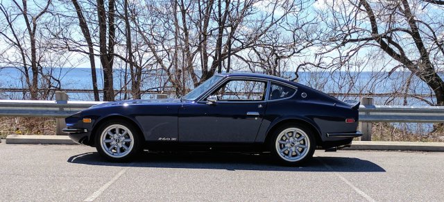

I think it depends more on the style of the wheel. This car has 17" wheels, and I think it looks great. Unlike some other older cars, I think Zs wear larger wheel sizes pretty well. Here's an article on it with more info: http://www.speedhunt...as-exotic-240z/
