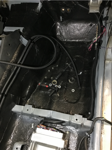

Mine is mounted on the firewall right at the passenger's feet.  I have my supplemental EFI power center (ancillary fuse box, relays, etc.) right above it where others mount their PCM.  I was able to use the stock GM harness in this location as well.

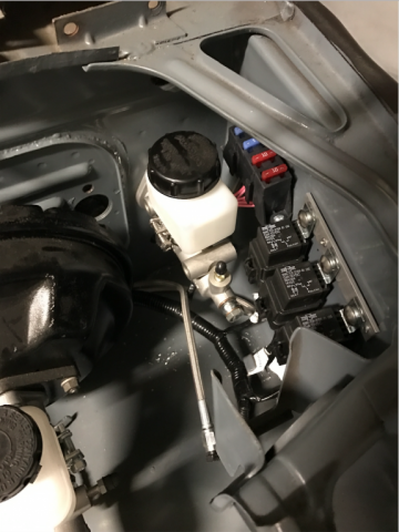

Inside engine bay, where the old clutch cylinder was, right beside the brake master cylinder under that inspection panel. It works with the stock GM harness i have(5.3l truck) and i just wrapped all the wires in loom and it looks decent, no show car completely clean engine bay here with me.
