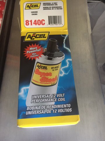

Thanks Tony...For 30 bucks and 10 minutes of work thought I'd try this...Read that coils can start going bad once they heat up but work fine when cold.
So far so good..No reduction on idle so far.
