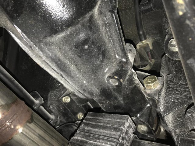

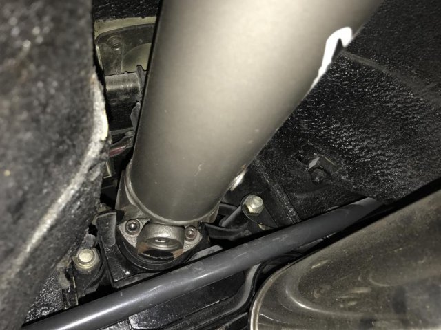

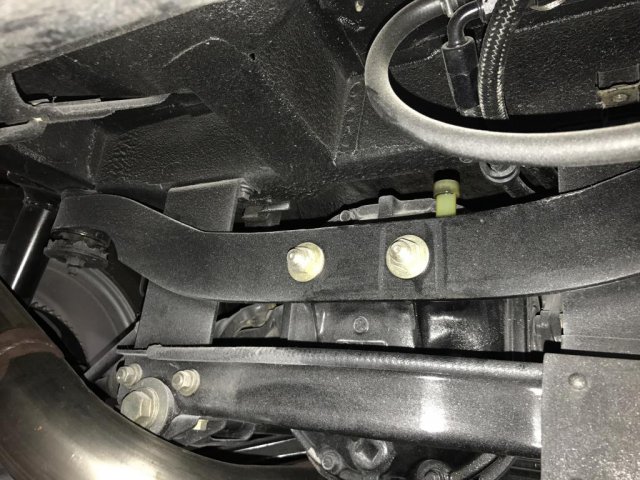

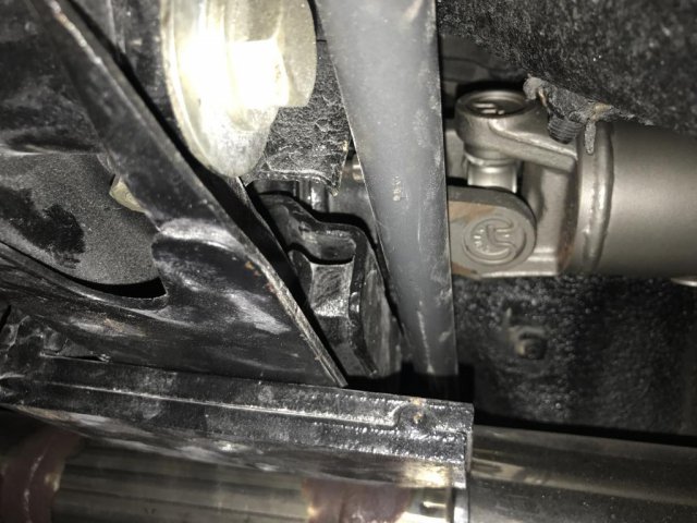

All of the diff mounts look stock.  I have been thinking the same thing as you with misalignment.  I was curious if this is typical for the application and what the best bang for the buck would be to remedy the situation.  I haven't heard of the Ron Tyler mount.  Thanks for the tip.  I'll start researching it. The front diff mount looks fine, the mustache bar inserts look a bit chewed up.  The flex in the mustache bar mounts become obvious when lifting the car by the diff as shown in the pics.  It would seem logical that firming up the mounts will fix the rumble that we are talking about if the mounts are allowing the nose of the diff to pitch up.

Before I go throwing parts at this, I'd like to mount a gopro camera under there to measure the actual deflection.  If the diff nose is not pitching up, no point in chasing front diff mounts.

This is probably not your problem but Id start with your mustache bar bushings they look shot from the pics!! Id replace those. But accel vibrations could be allot of issues from transmission all the way to axles. Good luck

Are you assuming that the driveshaft was cut and balanced correctly?
I ask because I had a similar vibration and it turned out that the driveshaft shop welded the driveshaft off axis after they shortened it.
Suggestion:  Pull the shaft and take it too a quality driveshaft shop and have it checked out.

You are right, they look a little chewed.  They look particularly bad with the diff supporting the weight of the car as shown in the pics.  I agree that they should be freshened up.

Driveshaft is brand new from Driveshaft Shop Specialists.  I would assume that the rumble would always be present if something were welded off axis, but it is always worth taking a look to verify.  I'll check the run out.

Just a refocusing type comment, but driveline balance and runout problems would be more tied to drivehsaft RPM, not load.  The original comments about angle changing due to diff nose lifting seem most likely.  Based on the stated facts.  Something that changes when load is applied.  Seems like this latest effort might be helpful but off target.
