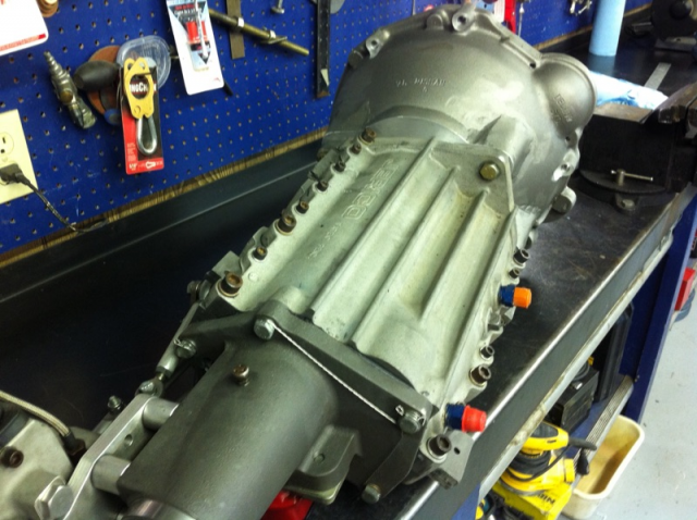

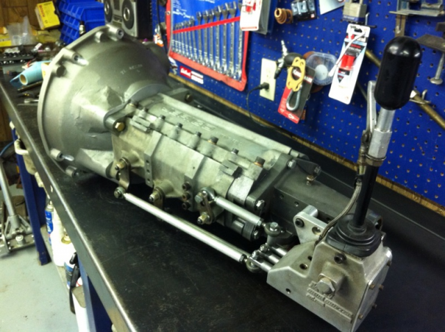

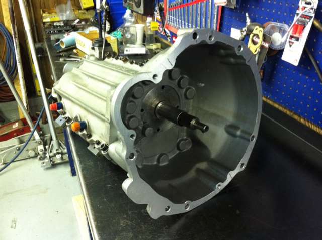

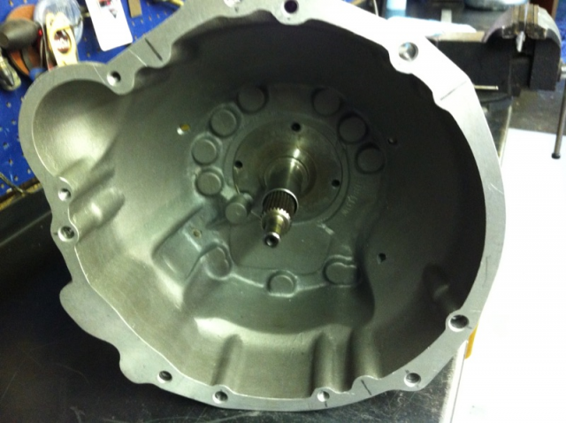

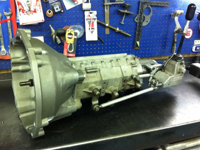

I helped with a jerico to an L-series setup.  We used the front from an automatic if I recall correctly.  Then a big chunk of aluminum that bolted to both.  It was turned to have a center hole that fit into the automatic bellhousing.  I've seen variations on this theme over the years.
Here's some pics of what it looked like, https://csgarage.com/blogs/csgarage/17986933-adams-s14-jerico.
There's also the quicktime bellhousing, http://www.jegs.com/p/Quick-Time-Bellhousing/Quick-Time-Nissan-Engine-Adapter-Bellhousing/2834608/10002/-1
I've heard they will do custom versions if you give them a call.
