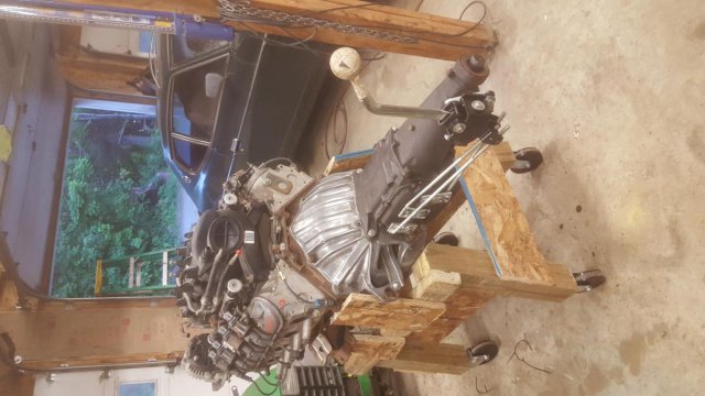

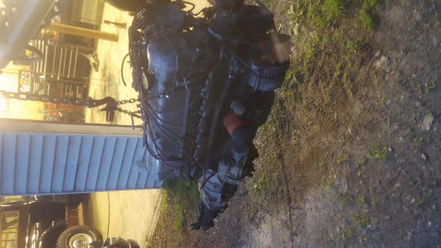

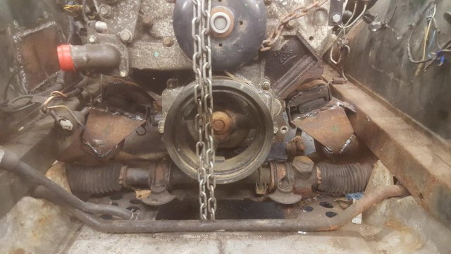

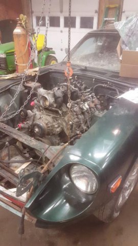

Hi all I decided to post up another build thread. Facebook and youtube is blocked at work now so I think this is a good chance to interact with people with similar interests and keep this site going.
This is actually my 2nd attempt at a LS Z car. My first one didn't get very far.
1978 280z 2+2

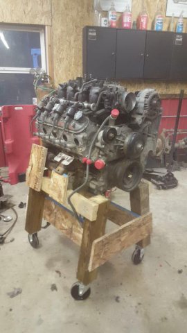

-04 4.8' vortec from manual trans truck - all stock
-4 speed saginaw rebuilt myself
-aluminum hydraulic clutch bell housing with advanced adapter spacer on bearing retainer

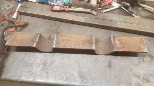

-home made motor and trans mounts
-shaved truck intake that clears the hood (kind-of)
-modified truck oil pan & modified pickup tube

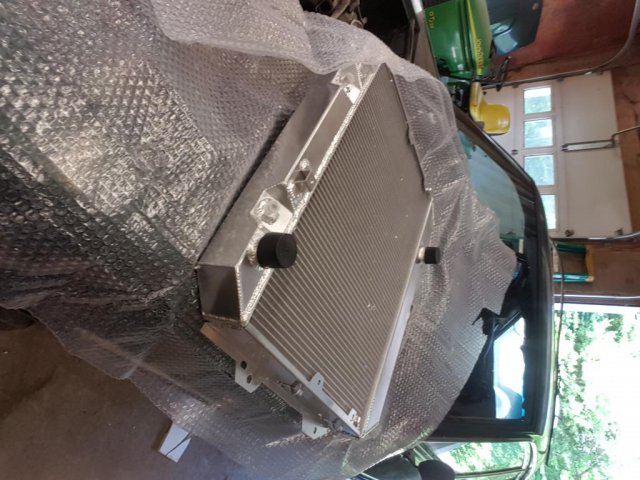

-3-row ebay champion copy
-stock pcm and modified stock harness
-pcm edited to send 6cyl signal to tach

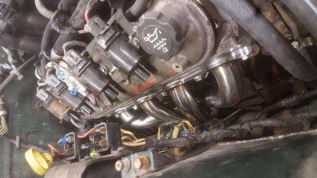

-EBay stainless block hugger headers
-2.5" to single 3" home fab'd exhaust
-255lph inline fuel pump
-stock gauges all working

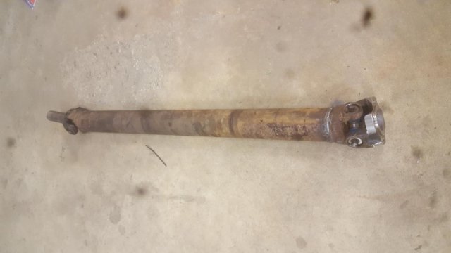

-shortened 77 nova driveshaft at home (say a prayer) to 36"
-adapter flange from zcardepot

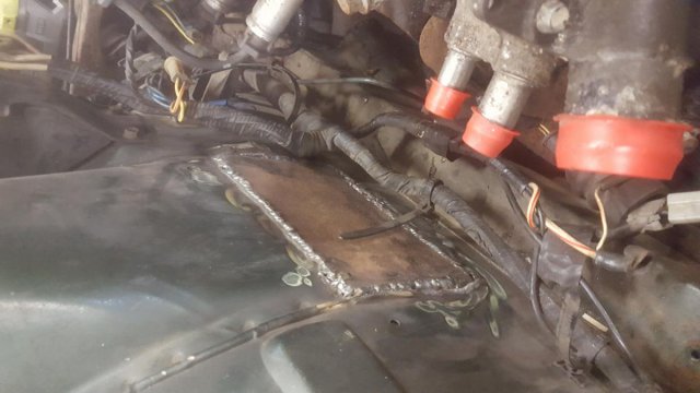

non-engine swap stuff I've done to the car:
-replaced windshield & seal
-replaced brake master cyl. & wheel cyls

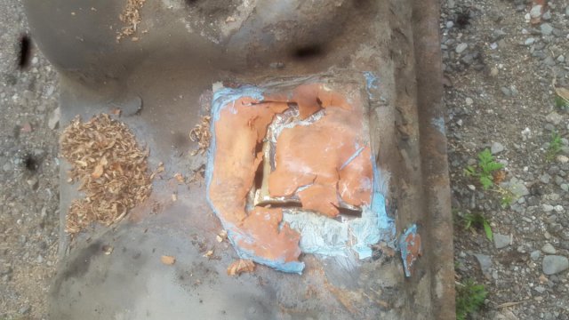

-repaired huge leak in the gas tank
-repaired fuel guage
-repaired broken connection in ignition relay
-removed goofy bumpers

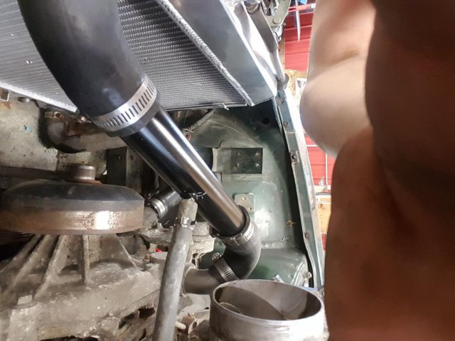

plumb intake tubing

finish installing driveshaft

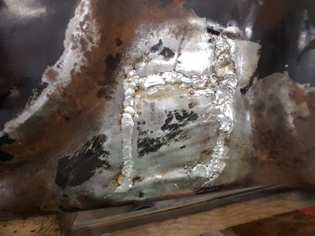

rust repair in drivers floor, floor support, everywhere really.

Good luck. If I ever do another swap on anything, its going to be the cheap and easy route. You get to start enjoying it so much sooner.
Thanks.
I started on June 17th with the swap and have about $1500 invested so far. The car really isn't worth sinking a whole heck of a lot into with the rust issues and our limited nice weather driving season up here. But I will keep plugging away at it I just didn't have the motivation to work on restoring it with the stock l28 in it. Hopefully after the conversion I will keep going with it until its something worthwhile.

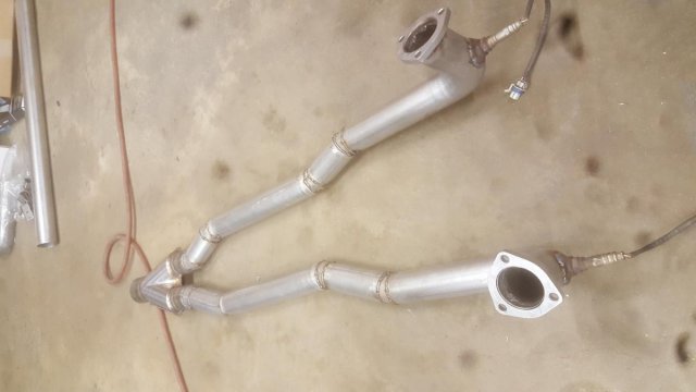

Got the exhaust hung on the car. It sounds great but is too loud. I ordered a 3" resonator to go in the straight section hoping that will make it just right

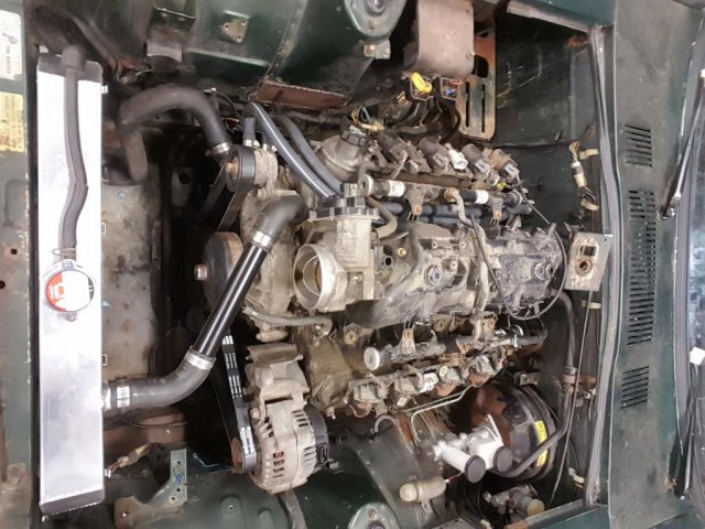

I like the quick progress! I have a 280Z that is waiting to have a 4.8 slapped in it on a budget. Did the truck manifold have any major issues fitting? I know most ditch it for the lower profile car manifold for hood clearance.
Cool! don't see many going with the little unloved 4.8. I like em they like come set up for a manual, are cheap, like to rev and don't make trans exploding torque  B)
I can tell you the only thing that doesn't perfectly clear on the truck manifold is the fly by wire throttle body. I realized this too late to make a change so I'm stuck with DBW. If you go with a cable I bet it will clear.
You do have to shave all the little do-dads off the top, which is easy.
My hood is on the car and it closes within 1/2" of latching. I just bungeed the hood down for now (looks kind of cool popped up a little). But in the future I'll make a speed bump in the hood for the throttle body or try to shave it some. I was also considering the oe competition hood scoop.
Keep in mind that when you go to a fbody intake, now you need fbody fuel rails, you don't have a fuel press regulator anymore, you'll need a car water pump, which means you'll need all new pulleys and accessories. I would of rather gone with a carb setup at that point.
OH and, just for reference, my oil pan is about 1/4" above the cross member and about that far from the steering rack. The crank pulley cradles the steering and the whole setup is pretty low in the car. So low that the driveshaft has to travel UP to the diff from the back of the trans. If you buy mounts I doubt it will be low enough to get away with the truck intake but I don't know for sure.

Made small progress tonight. First I investigated the noise I was hearing. I found it wasnt the bolts but the bigger ears of the driveshaft flange hitting the sway bar. So obviously my diff mount is toast.
As a temporary quick fix I heated the sway bar and bent it out of the way a little. The noise is gone.
Then I ran a 12mmx1.5 die over the end of the z temp sender, and screwed it right into the head. This I had seen in another thread (get it?) and worked out great with some thread sealant.

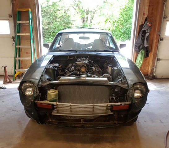

I got a new phone!!! No more hazy pictures with black dots everywhere after this post.
So Saturday the girlfriend and I took a 400-mile road trip in the jeep to go 4-wheelin at the terrain park and then further north to a concert in beautiful Rangeley ME.
Sunday I fooled around with fitting a makeshift air filter and getting the factory hood latch to fit in it's home again. I adjusted the hood to stay open just a little to give clearance to the truck intake and I hope will allow a little more flow through the engine bay. I don't mind the look of it too much. The z is a 78 but has a 77 hood with no louvers. I hope to add them someday but man! $$$
Also replaced the fusible links with some new ones from zcardepot. The old links had pulled their tricks on me too many times.
Last I took her outside and washed the greasy fingerprints and dust off. Oh, and I had to celebrate the success of the swap a little B)

Added my little resonator which did quiet it down some but is still rather loud. I think the next step addressing that will be some interior sound deadening and carpet.

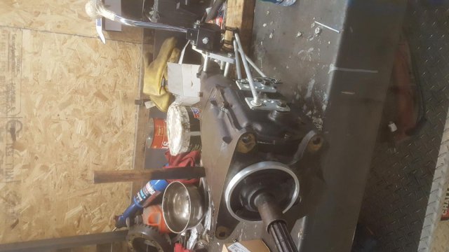

Last weekend I bought a trans for it. Its the oh so rare NP440 aka MY6 aka A833 overdrive 4 speed used in 81-84 gm c10 pickups. I picked this one up locally with a nice clutch, sbc flywheel, the weird belhousing, and the factory hurst for $300.
With a .73 4th and the very same ratios as a 700R4 coupled with a nice shifting factory hurst unit I think it is going to be a HUGE upgrade. Plus the aluminum case makes it a lot lighter than the saggy-4. Maybe too good for the ol' rusty Z :)
