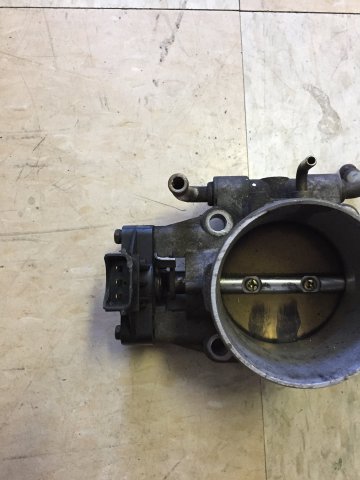

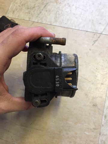

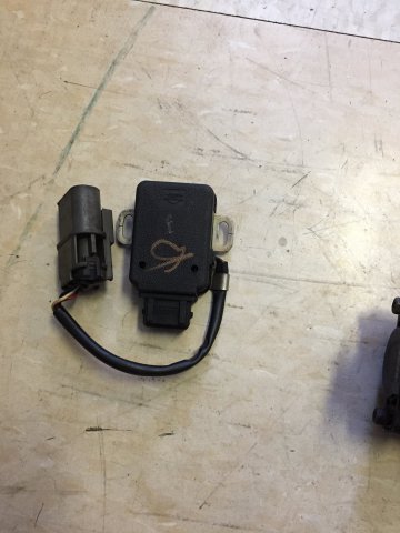

The 240sx throttle body is a pretty common swap so I imagine so. The 3 pins are a pretty good sign. You can find out with a multimeter if you have a power supply, set it to volts and supply power and ground the ground appropriately and see if the third pin outputs at a range (from 0-5v most likely) as you play with the throttle blade. Or you could do the same with the multimeter with the ohm setting I think, resistance is always something I need to review before use, but I believe you should see a varying value with one of the pins when referenced to I think the power pin or the ground pin. Or...that might not matter which pin you reference as long as you read a resistance change as long as it includes the output pin.

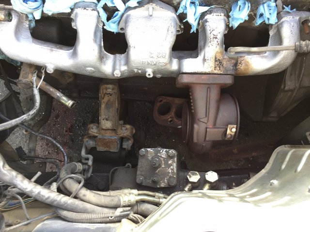

Just ran into a clearance problem that I do not see addressed in other forums.  The way the steering is set up (outlined in red) there is no way that I can fit this hy35 holset in there.
Is the swap that I need manual rack and pinion to make this fit? Did not think this was going to be a problem with the swap ugh 😤
