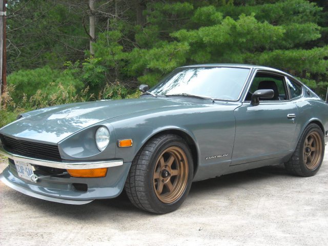

Yeah mine points up too and although that bothers me the worst part is the urethane is so flexible that when you get up to speed the center of the air dam distorts and pushes back in.I made a splitter lip for it but its real purpose is to keep the air dam from bending in the wind.post-28202-0-83076400-1503527513_thumb.jpg

Yeah mine points up too and although that bothers me the worst part is the urethane is so flexible that when you get up to speed the center of the air dam distorts and pushes back in.I made a splitter lip for it but its real purpose is to keep the air dam from bending in the wind.attachicon.gifDSCN1652.JPG
She does look sexy though!

Yeah mine points up too and although that bothers me the worst part is the urethane is so flexible that when you get up to speed the center of the air dam distorts and pushes back in.I made a splitter lip for it but its real purpose is to keep the air dam from bending in the wind. DSCN1652.JPG
What wheels are those? I love dirty gold wheels.
