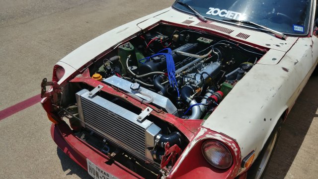

I am have a issue on my L28et i did not have with my last setup. And was wonder if I could pick your brains for some thoughts.
The car has a bad stumble on acceleration from any speed. It leans out but it always recovers after a few seconds. This is a issue on light throttle takeoffs from stop lights and in stop and go traffic. The car has even died on me a few time due to this issue.
Any help would be much appreciated!
I have attached a video of issue from a few days ago.
Specs of car.
83 L28et
Z31 ecu & maf by @Nismopik
76 intake ported to match TB
Webber big TB
T3T4 H-Trim turbo / H trim is a T04B wheel with a 70mm inducer, and 58.4mm exducer. @10psi
Turbosmart wastegate
Inovate boost control/ wideband o2
Supra yellow tops 310cc injectors
Areomotive 1:1 Fpr set at 28psi
Turbosmart bov venting atmospheric
2.5" intercooler
2.5" Exhaust
All new hoses for vac lines
New ngk plugs
Blaster 2 coil
Stock auto trans
Timeing set per FSM instructions @25°
