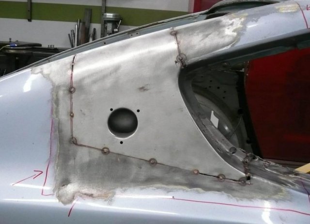

I chose the complete strip down and build up approach for my project and am glad that I did. I discovered how shotty the previous owners repair work was and found unexpected rusty panels in most all the known areas after the old under coating, BONDO etc was removed. I am a bit of an obsessive type and have approached this car with the plan to build it to my liking/standards/approval and never sell it. I wish I could have hauled it up to Los Angeles and had it dipped then epoxy primered, but going the route I went (professional sand blasting) allowed me to meet my current body/paint guy as well as start the body work on the blasters  property. There was some signs of minor panel warpage on a few areas where as the dipping process would not have been an issue. All in all for my first old car as well as doing what I can so far to rebuilding it, I am happy that I went this method and exposed all problem areas and gave me a new canvas to strengthen for my intended 500ish whp goals.
I will add that I rode in a friends L28et 280Z that at the time was only making mid 200ish hp and ended up cracking the new paint in the C pillars where the lead lines are. I had mine removed and welded solid as a result. I still plan on more stitch welding in the rear area as well as finishing the firewall to complete the front. I think you are forming the right plan to combat that amount of torque and power that you have planned. Just a few pics showing the passenger side requiring a new cut piece to properly line up as well as how thick the bondo was in some places.
The first page of my build shows what I discovered under a pretty, new, blue paint job and the very beginning of the snowball rolling down the hill of no return.

Good information @Nelsonian, I think regardless of what you do with a car this old, at some point it needs to be stripped and refreshed (unless you're into the whole all-original/matching numbers concept). I think the big question in my head is solved...modify the chassis and drivetrain to a point where it is running and driving and all fabrication is done and once you're happy with the results - strip it, dip it and put it back together.
