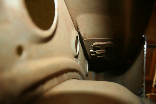

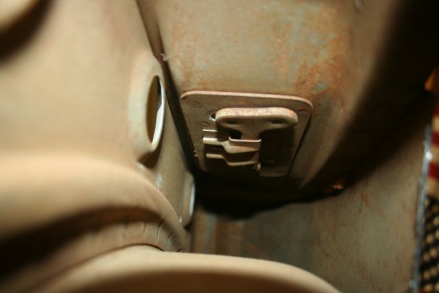

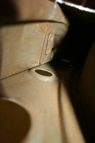

I am going to work on my cowl this weekend. I am going to look around with a borescope and see how it looks in there. Then make an effort to not get too crazy.... Most Z's have a little rust, if it's no big deal I will treat and encapsulate. Last time I said that, I ended up cutting out half the wheel well under the battery tray.
Good luck! I get the crazy bug. I have to always tell myself not to get to crazy or go too far with it. I feel ya.

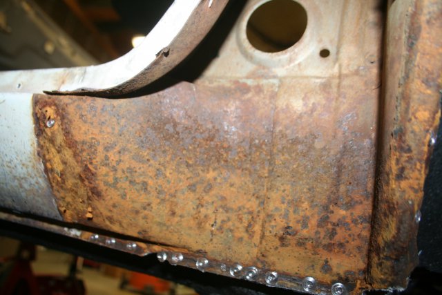

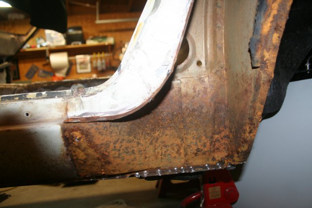

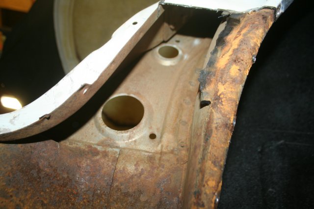

Removed a dog leg this evening. It doesn't look good. Pretty nasty in there. Most of the rust is down low, though, and around the fender lip. Decisions Decisions. I'm not sure if I want to just blast what I can and only replace the dog leg or replace dog legs, rocker, and the fender (inner and outer?)  The more I work on this thing the more shit I find!!! Ahhhh!

Honestly it seems like really only the lower panel is really troublesome. The area near the hinges has some slight surface rust which you can probably get away with a neutralizer and some sealing primer. You can order a patch panel for the outside, for the inside really it is just a matter of connecting pieces and sealing it against rust. You can cut out the bad metal and put in a flat piece like the guy did on project hugo, might add a bit of weight, but no one will see it. Back part of the wheel well can be done similarly as well cut out the piece, then get a flat sheet, bend it to fit the curvature, then tack it in, weld beads for strength, then seam seal for water tightness so water does not get kicked back up in that area.
I guess the question is what the purpose of this car is. Is it a forever car, is it a driver, is it something you think you will sell down the road? What kind of repair could you live with? Will even the smallest bit of surface rust eat away at your conscience? If you don't repair it exactly like how it is will you never trust the strength of it?

Interesting ideas. Are you talking about this section as the back part of the wheel well? image.png.ea094450eae615aa41b9ce773f9de257.png
I remember seeing Project Hugo a while back. I'm going to have to do some searching to find the exact pictures -- there's a thread of that build on numerous websites.  It's going to be a daily driver but not when the weather is shitty. It will also see some track days as well. And I may enter it in some car shows, but it's not 100% original and not everything is perfect. I'm doing an L28 swap, aftermarket suspension, aftermarket bits and pieces, etc. I plan to keep this car for a while -- I'm not building it with the intention to sell. I may end up doing another zcar or other restoration that is more of a primary track/race car.
I'm okay treating surface rust with a converter and encapsulating, just not heavy rust like in the picture. I gotta do something about that! On the fender/inner fender overlap circled in red in the picture I would think there's rust all the way around the length of that overlap.

Yup, mine was similar.
Cut it out to a shape that is easily replicable.
Then spend some time making a piece to replace it. Given its location you can definitely have it be a bit bigger to overlap inwards.
Notice a ton of overlap in my case.
Then weld it in.
My dog legs were bad as well, so I just trimmed off the square portion under it and replaced it with 18 gauge if I recall. You can see the lack of the rear wheel well flange as proof of that panel being replaced as well.

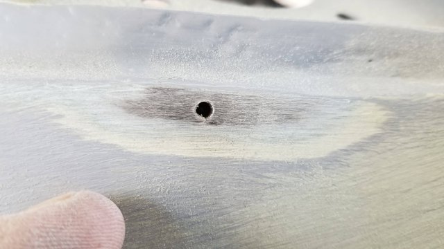

I drilled the spot welds in the cowl vent cover yesterday to get a better look at mine. It's pretty rust. I'll probably cut the vent tube out and see what I can fabricate to replace the rot in there. Hopefully yours wasn't too bad.
Share this post
That looks good! Looks like there was probably a good bit of rust there to warrant that kind of repair! Did you guys cut away the metal covering over the entire cowl area for better access?
Mine has some holes around the inside where the vent tube meets the cowl area floor.

I ended up just drilling the spot welds from the bottom side and removing it to sandblast it and sandblast around the cowl area. I'll just spot weld it back in from the bottom. It has a few rust holes in it. I think I'm just going to fill these with body filler or something easy, instead of welding them.
