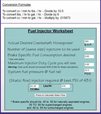

On injectors, I would recommend going with 550's. This will give you room for expansion. At some point you will be bitten by the Boost bug and are going to run out of injector with the 440's. The 550's are not crazy big and will idle nicely with a standalone ECU controlling things.
Using the following calculator, you will see that 360 Crank HP ( 300 WHP using 20% loss ) with a BSFC of .60 ( Typical Turbo value ) and 80% duty cycle ( what you should be aiming for ) requires 476 cc/min Injectors. So your 440's may already be too small for your goals. Better to be a bit too big with injectors than too small.
https://www.rceng.com/technical.aspx
