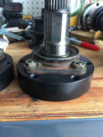

New hardware from Carr McMaster. I'm using hardened 3/8-16 bolts with lock material on the threads and thin grade 8 nuts on the back side of the flange.  The hardware they supply will never work..... the stuff I sourced will hold up fine and the adapter is machined to hub centric around the diff stub axle so shear won't be a problem

PERFECT!  thanks so much, ive been struggling with this one for a while, and when i called them, they acted like i was crazy.  if they were designed right or smart, they wouldve counterbored the adapter bolt holes larger for nuts on the inside, completely opposite of what they have.
if handy, would you happen to have those mcmaster part numbers?

On 11/19/2017 at 11:15 AM, trackzpeed said:
IMG_2403.thumb.JPG.72660a9fea9a54a1de00db605546d8d7.JPGNew hardware.  3/8-24 3/4 inch with grade jam nuts and red lock tight torqued to 50lbs.
Probably a silly question, but can you just flip the bolts? So the nuts are on the other side?
Share this post
