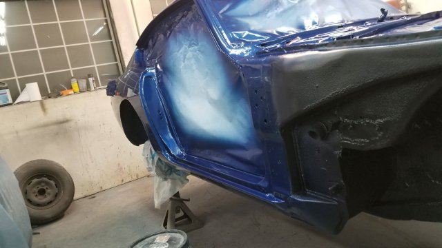

A bit more work was done. Tore out the nasty carpet, lightly sanded some surface rust and coated the floors.
Dealt with some rust.
Had to make a new reinforcement for the lock mechanism
Before burning in
Had to slice open the lower quarter to see what the damage looked like
You can see it's into the rocker as well. Surgery continues.
My Rusty graveyard pile keeps adding up

Very nice color. 115 Blue? Or the popular Daytona blue?
