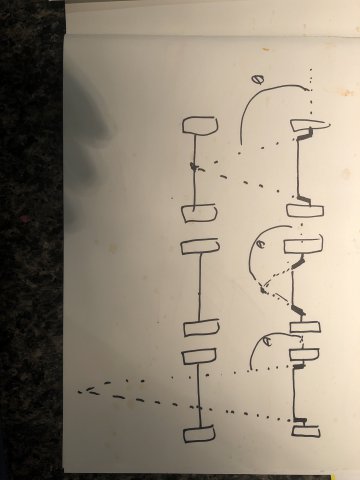

These are, I believe, the different ways Ackerman changes. But as I said before, since wheelbase and track width are both decreasing, then Ackerman is Probably still in a reasonable range.
That's a good hand drawn summary "perfect Ackerman" on top and both extremes in two dimensions. With the ackerman aligned with the center of the rear "axle" or centered between the rear wheels, inner and outer tires turn with zero scrub ie they turn in the radius that each travels inner tighter than outer. That's the theory a line through the pivot point for the wheel and the tie rod end pivot center. Things can also change as all this gets dynamic rather than static or theoretical and the struts don't hold everything perfect as suspension cycles. These old cars flex a bit too. I haven't run the numbers on stock or even started design for my car but it definitely will be in the considerations. You've got scrub radius, as well as the caster and camber to deal with too. Lots going on up there.

1 hour ago, mtnickel said:
I was under the impression ackerman is based not on the distance from ball joint to tie rod, but rather the angle between the spindle (wheel axis) and steering arm.
Additionally, to correct bump steering it's the inner pivot (ie inner control arm mount point) that has to match the inner tie rod joint. The outboard tie rod mount will mainly dictate how long of a tie rod you need.
All these rods and points might not be the same length or location but have to move in the same arc and planes as the suspension. If not, then the effective lengths change as things move and bump steer happens. Again, it's all in a 3 dimensional world and the steering has to stay constant in relation to the wheel/knuckle as all of this moves or you toe in or out depending on what each wheel is doing. The double wishbone is easier to control more exactly but a strut is easier to package and cheaper with acceptable changes.
